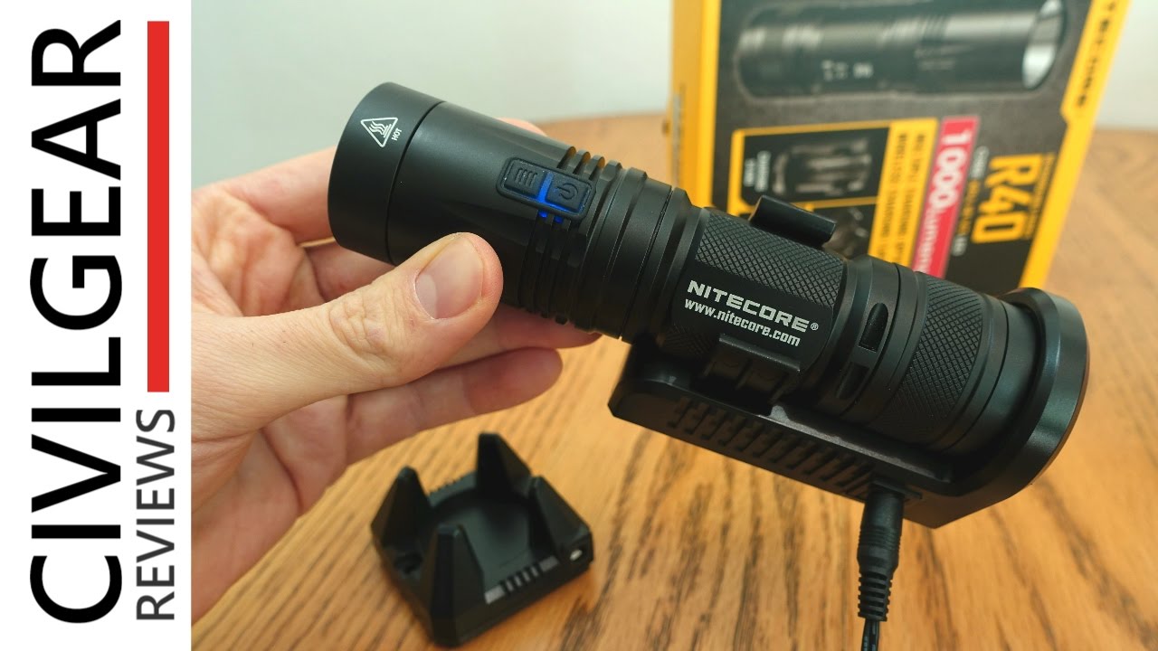

The R40 caught my eye because it has 3 different ways (2 wireless options and 1 micro USB option) to internally charge the light AND it is Nitecore's FIRST flashlight to use a 26650 "sized" battery. Overall I'm very happy about having so many charging options and that by keeping the light at 1,000 lumens and upping the battery capacity, you get longer runtimes.

While the flashlight is charging, a blue indicator light, behind the power button, will blink. Once the charging is complete, the blue light will remain on. Unlike the R25, the blue light is much more diffused so it won’t light up a dark room like the R25 does; additionally, the blue light is also still easily visible in day light.
BOTH CRADLES
Both of the cradles use a wall charger and use alternating magnetic fields to ‘induce’ voltage to the flashlight body, therefore called inductive or “wireless” charging. The cradles are rated for 5 to 12 volt input @ 1 amp, and the battery experiences 5 volts @ 1 amp (according to the bottom of the chargers, I have not verified).
Both the cradles and the USB option only take 6.5 hours to charge the light!
The only bummer is that unlike the R25, you cannot run the light while resting in any of the cradles. If the light is on and placed in a cradle, the light will turn off automatically. Additionally, if you put the light in the cradle while on, it will turn off, and then when taken out of the cradle, the light will proceed to show you a battery voltage check, and afterward, will turn back ON the light automatically. If you do not wait for this to happen, and take the flashlight out of the cradle and immediately push the power button, the light will blink on for a second and turn off immediately after, or if the mode button is pressed instead, it will go immediately into the next primary level and remain on; this also applies to the USB method.
DESKTOP CRADLE
This one is my favorite because of how easy it is to mount the light, and it’s surprising tipping resistance. Because the battery is closer to the tail end, it does very well to lower the center of gravity. I’m also pleased that there are screw holes for mounting as well.
WALL STAND
I’m happy to see that they kept the same pinch-arm mechanical design which uses real spring mechanics and not just plastic bending. I’m also happy to see the scree holes are more centrally located and that the body is much thinner than the R25’s cradle. It this is really a ‘wall stand’ then I think the AC input plug should come from the bottom of the cradle, and not the side.
USB
The light can also use a micro USB cable to charge. The micro USB socket is on the tail end of the light and is protected with a dime-sized rubber cap which is also attached to body to keep you from loosing it. I like that it’s not just a flap, but you can pivot the cap away once you open it.
