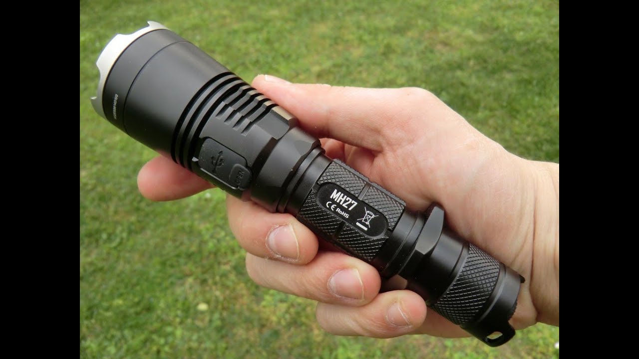

Finally here, the MH27.
The U shaped tailcap, it’s wide and allows tailsand and easy access to the switch.
On the body of the light there is some knurling that helps the grip.
At the head of the light there are 2 electronic switches. They can easily be found, since they protrude from the surface and the rubber cover adds some grip.
On the other side of the head, the micro USB port for recharging the 18650.
The Anti roll ring, allows cigar grip and it’s threated. It screws on th body of the light, and once in place it doesn’t move at all.
If you remove it, the threaded part of the light will remain exposed.
Thick o-ring and anodized threads, allowing lockout.

There are 3 points where you can attach a lanyard: 2 at the tailcap and one at the cigar grip ring.
The satin finish crown at the head, glass with AR treatment.
