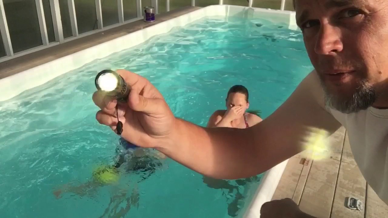

Long time lerker, first time posting. Everyone does such a great job at answering feedback that I wanted to post my impressions about the Zanflare F1. So far it’s proving to be as good as everyone says and I love the capability of it. I made a video of some tests and wanted to see what y’all thought. Please let me know!

Mine is a little snug. Maybe it was being over tightened but I agree that I want it snug as part of the reason I like this so much is to not worry about water. As you saw, I threw it in the pool! This is now my go to for camping or anything out doors. I’d rather it be snug the not work. But that may just be me.
