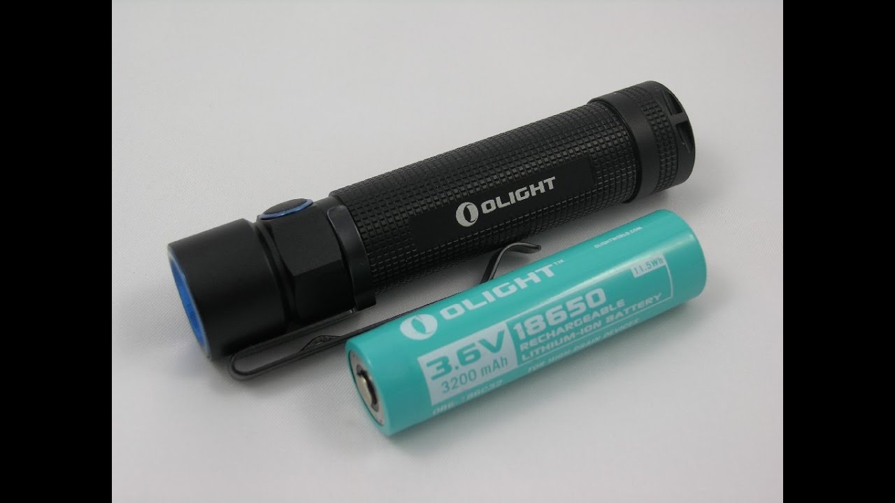

Here’s the S2R Baton.
The light comes with a 18650 already inside, so the usual instruction is needed: remove the spacer before try turning the light on and off.
The design recalls the one of the S1A and S1R: cilindrical lights, with knurling on the body, same clip, LED (XM-L2 cool white), TIR optic and switch bezel with blue PVD coating.
The S2R tailcap looks very similar to the one of the S1R, because both lights feature the recharging capability with magnetic base.
The insides of the tailcaps looks identical, and the S2R works with all button top18650s, while the charging system works only with the proprietary 18650 Olight battery that has both poles on one side.
The magnetic base is the same of the S1R (so you can use the same magnetic base for all SxR lights), it is very easy to connect, I have never had to reposition it in order to start the charge
and the cable indicates the charging state: Red for charging, green for charged.
Anodized threads allow physical lockout of the light.
