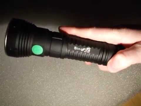

After usual, long anticipation, flashlight arrived nicely packaged in the box with foam even :) so no dents, scratches or similar surprises.
besides flashlight box also contained user manual, chinese -> english user manuals are always fun to read :P
This is my first flashlight with black matte anodisation, looks interesting, feels nice but it's not particularly grippier like I expected, I would also say that it's probably not HAIII but I am no expert on that subject.
They really did not spare aluminum on this flashlight, with 302 grams (without lanyard) this is also one of the heaviest light I own.
Everything is oversized, just take a look at the taicap, C8 tailcap look almost twice as smaller:
and it's a bit unnecessarily complicated with double retaining rings (one is made out of plastic and it's threaded, other one is just regular aluminum retaining ring).
Finally disassembled and here are all the parts (notice the nice omten switch, wouldn't you just wish 15A 25V ratings instead of 1.5A 250V :P)
Btw. tailcap has only one hole for lanyard so it can tail stand with lanyard inserted but it's a bit wobbly.
All threads are square cut, very easy to operate, no squeaking even without the lube, also, they are not anodised so no lockout function but with tailcap switch you wouldn't need it anyway...
At the front side we have a three first generation XM-L T6 emitters, perfectly centered (no wonder, they used centering rings). By size, I would say that reflector is comparable to SRK, 51mm in diameter, 20mm in hight. Btw, reflector is held by the screw that goes through the heatsink so, to get it out you have to get the driver out of the way first :/
Emitters are all in parallel configuration and I was pleasantly surprised with thermal compound under the emitters, not thermal adhesive :)

Now let's talk a little bit about the user interface.
to turn on the flashlight you click the tailcap reverse switch and that's all that tailcap switch does, on and off. Flashlight always starts in HIGH mode but one short click on the side switch will get you to Mid, then to Low mode and after that SOS mode. After SOS mode there is a Standby regime, emitters are off but indicator led i on... If you don't like SOS there's a way to avoid it, just tap lightly tailcap switch to break the current flow and you will instantly jump to High mode, this will also skip the standby regime thou...
Every time you power on the flashlight with tailcap switch red indicating led in a side switch will blink twice while checking the battery voltage (which takes 2 seconds) and if there is a suficient juice it will switch to constant green indicating led. Voltage measurement is done under load because as soon as you turn on the flashlight it's in max mode.
(Red indicating led, green indicating led and GITD demo)
I used DC-DC converter to find out what is the threshold for this indicator and that would be about 3.7V for without load on battery or about 3.3V under load. When V drops under 3.0V red indicating light will start to flush slowly letting you know that you should prepare spare cell. Unfortunately this driver will NOT power off with future V drop. If your cell is under 2.5V flashlight will not turn on but if you forget the flashlight turned on with unprotected cell it will still produce the light even at 2.30V -> super low 3 x emitter moonlight mode :P
