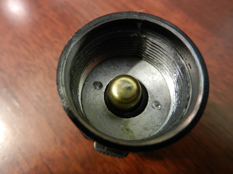

Now the insides… Inside the tail

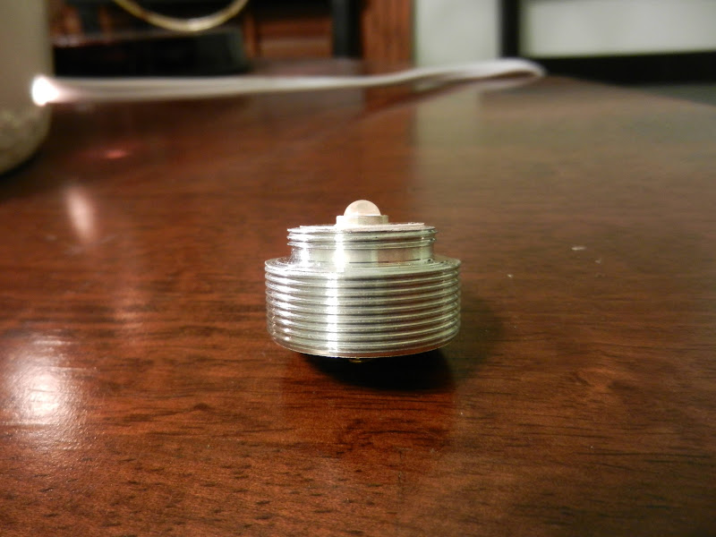

Inside the head
Head threads
Tail threads, oring and cigar grip

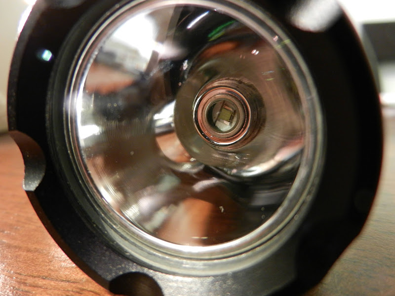

Reflector sitting in head with lens off

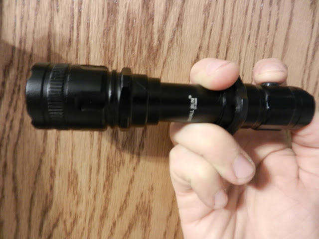

The only drawback I can see to this method, is finding a way to comfortably press the side switch. The overhand grip can be done without too much fuss.
But the few other options you have are uncomfortable, or require major moving of the light in your hand.
On the other hand, it does the same thing that fancy head twist lights (Eagletac, Armytek, etc.) can accomplish with just a press instead of a twist. Those lights often take both hands, and so might this light. However the advantages of having your light in the mode you want - and it won’t change despite repeated momentary presses - outweight the inconvenience for me.
The beam might be bright and throwy for an XP-E, but it’s also very ringy (see pic earlier in the review.
