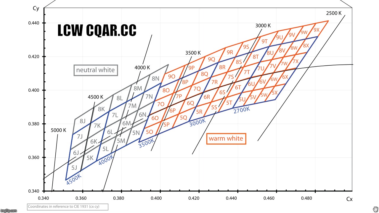

I mean after your comment I gone searching and bought them.
MR-6L-L2, voltage bin is 2.9 - 3.0V, a step above the one tested by djozz.
As spot on over the Planckian locus as these can be; had them on my wishlist a few days ago (it is normal for me to have truckloads of stuff in my wishlists which I'll never :-D buy).
Cheers ^:)
