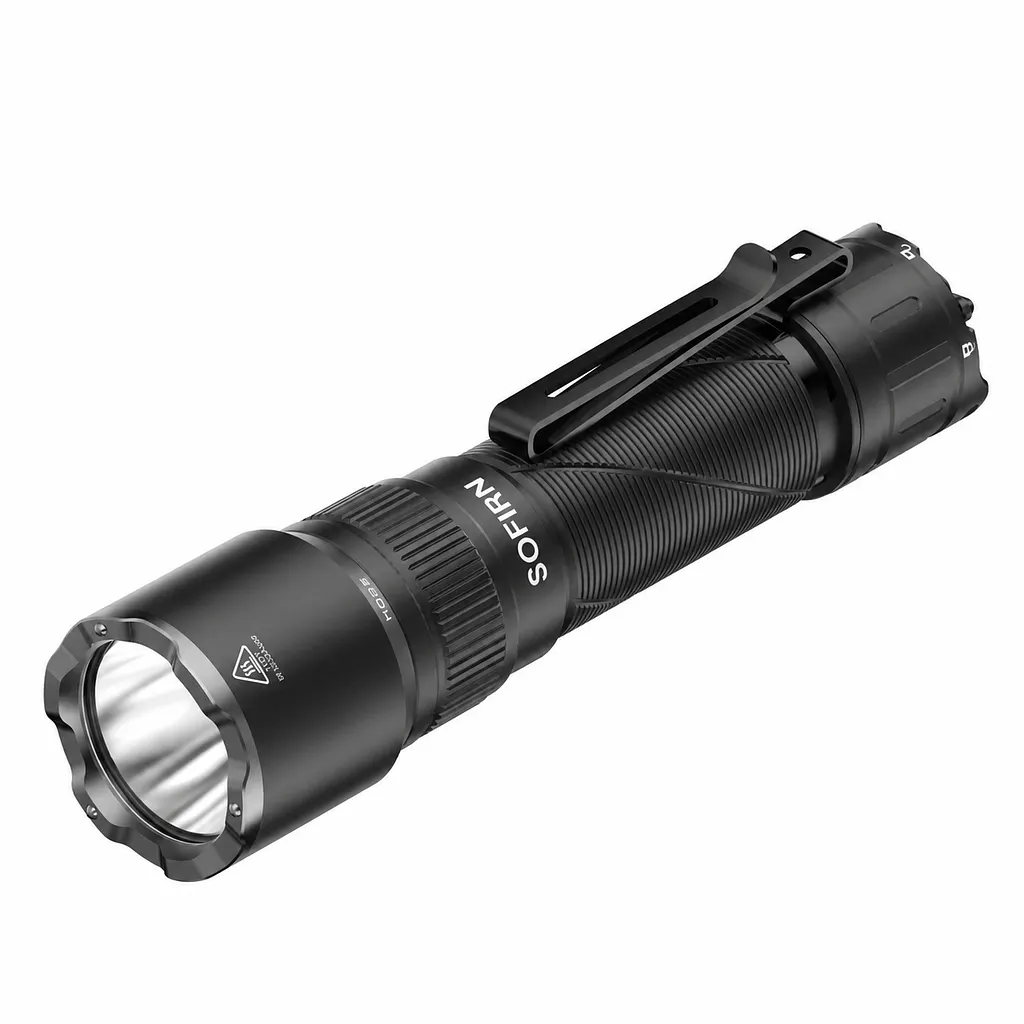

Seriously, I’ve known good to great anodisation over the years, and thankfully, gone forever are the days of pits and voids. The SK31 is no exception. Flawless smooth semigloss ano, edges that are crisp but not sharp, smooth threads, and just a fit and finish that’s just about perfect.
The tailswitch is firm and not mooshy. It needs to distinguish cleanly between a partial press and a click-through. Lots of button travel makes that easy. There’s no play in the button at the start of travel, no wiggle, no “bubble”, nothing. Clicking through is pretty decisive as well. Simply put, there’s zero ambiguity in what you want vs what the switch does.
The lock switch is pretty secure. You need to work it from the top, not side, so it’s best handled two-handed. It’s not for casual or frequent use like a mode switch or power switch, rather, only when securing the light against accidental activation and later readying it for use.
There’s a captive ring which covers the mode-select switch and charging port, which is also buttery smooth to tighten and loosen. It’s also O-ring sealed.
The front glass has a slight purple reflection, so we have anti-reflective coating as well.
The specs indicate the emitter is 6500K, but it doesn’t look that cold. The color temp looks quite nice at higher power levels. At lower levels, there seems to be a bit of green, but even at its lowest level, it’s not that noticeable, or objectionable. The green might be due to the AR glass?
All in all, it’s pretty impressive, even at first glance.
