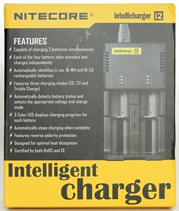

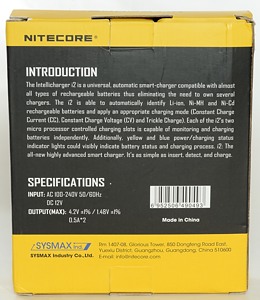

It comes in a cardboard box that list the battery sizes the charger is designed for.

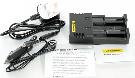

The box contains the charger, a power cord (I bought mine in UK and got a UK power cord), a car power adapter a warranty card and a instruction manual. It looks like the car adapter is optional.

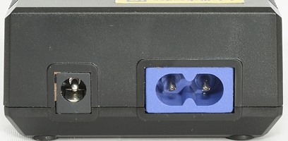

The charger has a standard connection for the power cord and is universal voltage (100-240V 50/60Hz). It does also support 12 volt power. In my tests I have only uses 230 VAC.

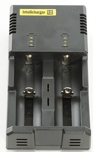

The charger has 3 yellow leds for each battery, they will show the actual charge state when charging:
None: no battery detected
1 flashing, 1 steady + 1 flashing, 2 steady + 1 flashing: Charging, number of leds is a rough guide to actual charge level.
3 steady: Battery is full.
3 flashing: Fail.
The plus connection is slightly raised, this means that the charger can be used with flat top batteries.

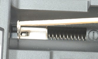

The minus connection is a slider, making it possible to charge different size batteries without using a spacer. The slider is working very smooth. It will handle batteries from 30mm to 70.1mm.
I had no problem with any of the supported battery sizes, they were easy to put into the charger and did always make connection.
The charger can handle 70 mm long batteries including flat top cells.
