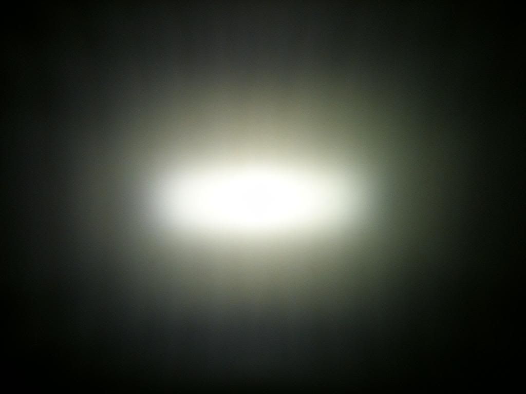

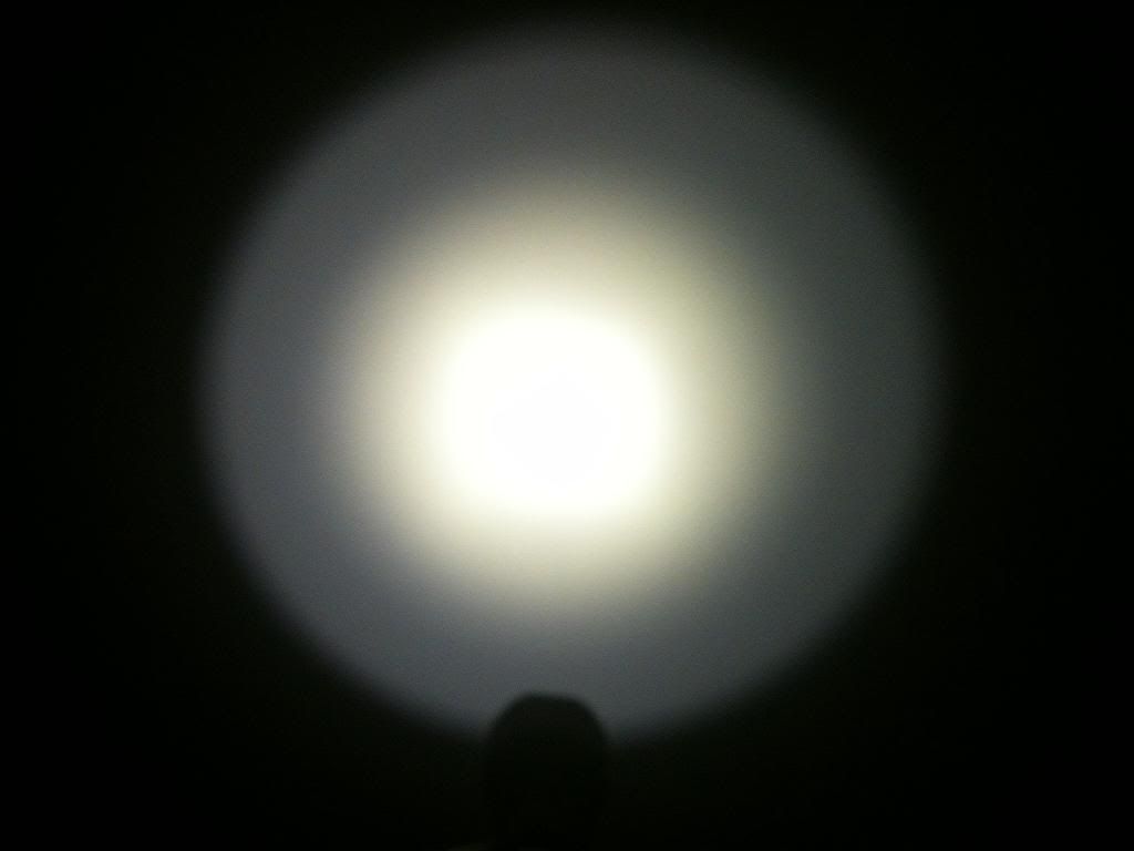

Here are a couple of hastily taken white wall cellphone pics of a C8 XML2 4C with and without the wide-angle optic in place , both from the same distance . What you don't see in the wide-angle pic are all of the artifacts , it literally looks like shards of light . Yes , the beam spreads out and covers more peripherally and might be less blinding to oncoming traffic , but the trade-off is a fairly choppy beam .
I tried to minimize the wide-angle artifacts with an additional layer of DC-Fix , but the lumen loss at that point was unacceptable to me . I don't use the wide angle optic because I am a beam profile snob in addition to being a tint snob .
Hotspot seems off center.
