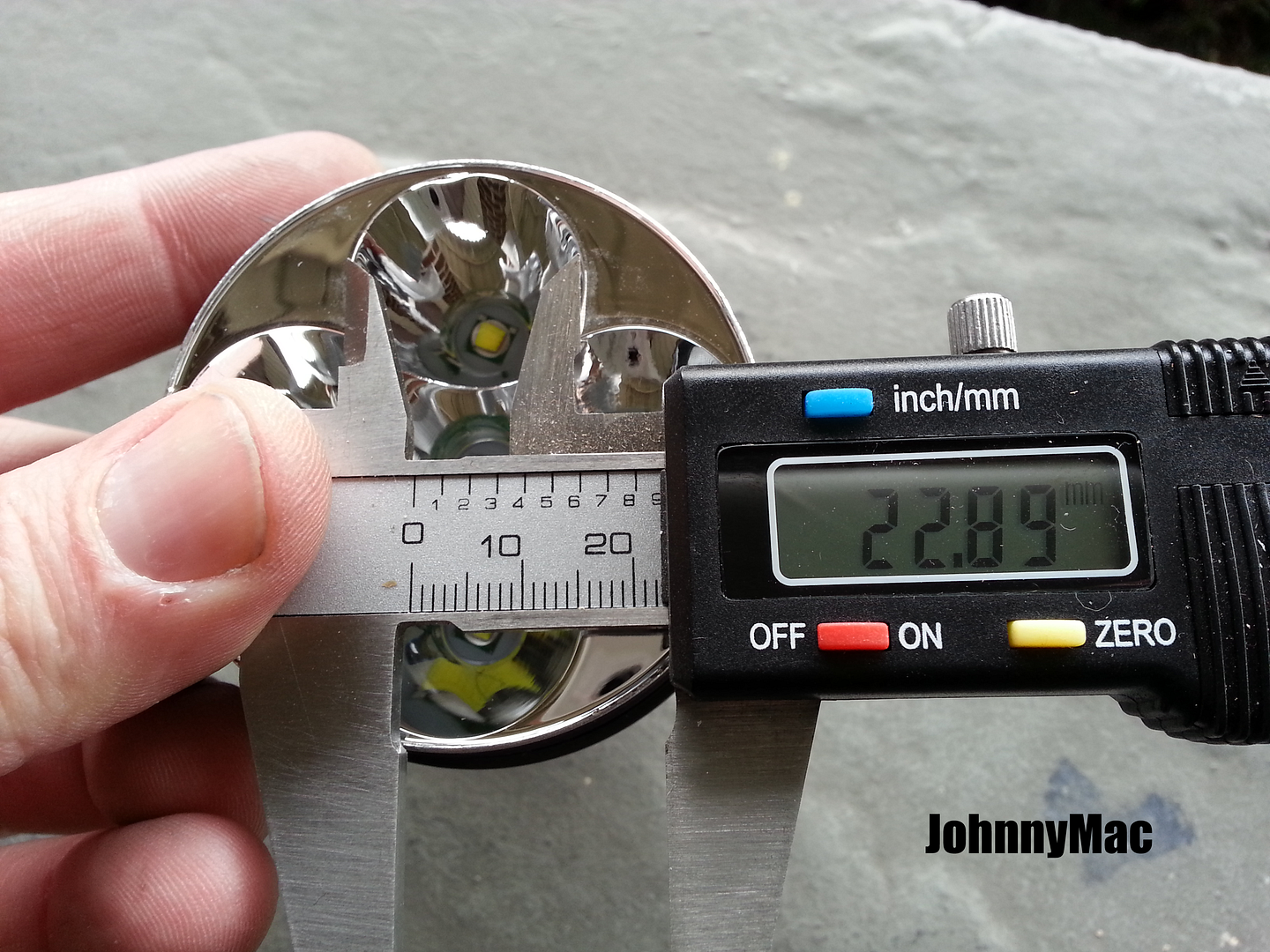

The reflector itself is just shy of 59mm.
The individual reflector cups are roughly 22-23mm across.

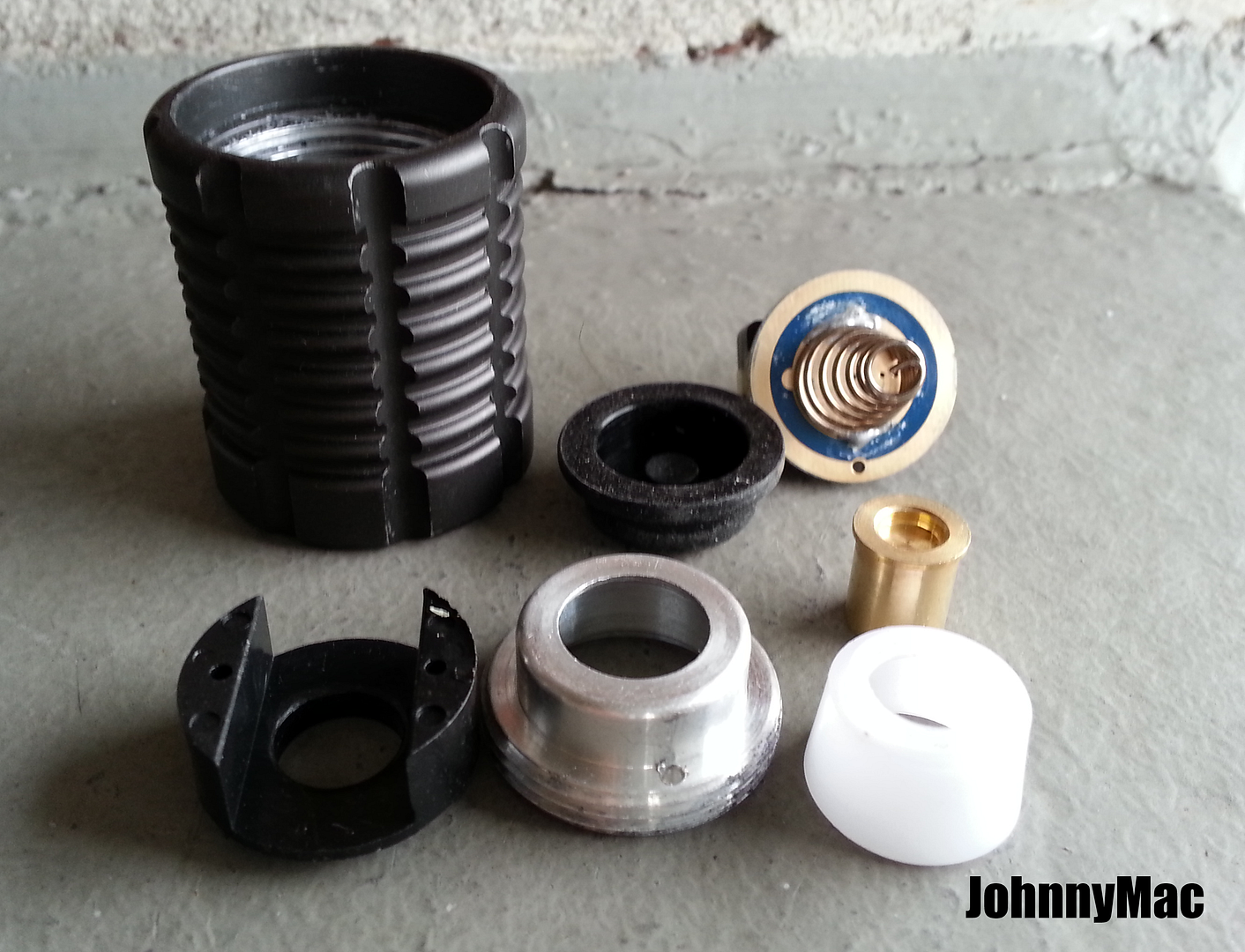

Onto the rear of the head. The threads here are clean and deep. The machining itself is decent. You can see some slight chatter from the thread cutting but they work very smoothly and have little play. The driver is behind a thick brass threaded ring and the brass contact point is actually a very thick, solid machined spring cap. Not a flimsy stamped cup like is found on most budget lights.
With the contact ring removed we can see the 25-26mm driver hiding deeper in the head. The contact spring is pleasantly heavy and looks like it could handle the amperage. It is soldered nicely onto the center of the driver board. Unfortunately it is press fit and rather tightly, too. It may even be epoxied from behind. Try as I might I was unable to pop the driver out to have a look at it and the inside of the pill. I have a feeling (positive actually) that the reflector is bolted to the pill from behind but without getting the driver out I was unable to get any further into the head. :(
Here is what the driver contact ring looks like
All is pretty well made. Negative contact is passed from the outer ring to the driver via the large spring. It works. The positive contact button is held in place by a white nylon spacer. You can see how thich the spring cap is. It is actually a machined piece and not just stamped out of a sheet disk.
The nylon centering ring is also threaded and very thick. Everything in this light appears to be overbuilt and that's a good thing.
