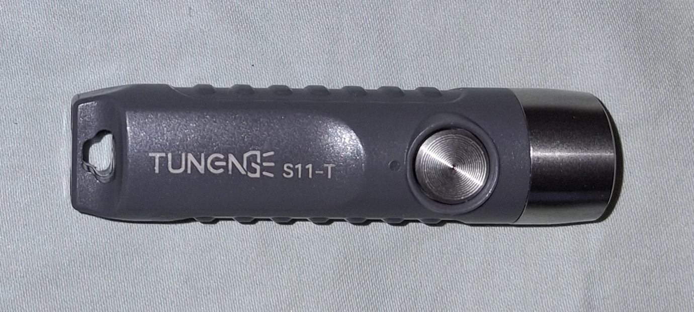

I received a Tunenge S11-T yesterday.
It is quite similar to the S15.
The S15’s body is aluminum, whereas the S11-T’s body is plastic.
The S15 claims to output 650 lumens, while the S11-T claims to output 500 lumens.
I compared the two side by side, and the S15 is a tiny bit brighter.
The S15 is throwier and the S11-T is floodier.
Also, the S11-T has a warmer tint.
I think that the floodier beam profile is more useful, and the warmer tint is better looking.
The S11-T has four main modes.
A short button press turns the light on or off.
A long button press cycles from moonlight to low to medium to high.
The light has proper memory, and the mode spacing is reasonable.
When the light is off, a quick triple click activates strobe.
I think that the S11-T might accidentally turn on in my pocket while the S15 is much less likely to do that.
Where a keychain attaches to the S11-T, the narrowest part is roughly 1 mm thick.
(There are about 25.4 mm in an inch.)
It seems like quite sturdy plastic, but I don’t know if 1 mm of plastic is strong enough to not break.
If that plastic were to break, it would be much more difficult to attach the flashlight to a keychain.
Here’s a photo that I took that somewhat illustrates how narrow that plastic is (on the far left.)
In conclusion, I like the S11-T, though I do have some concerns.
