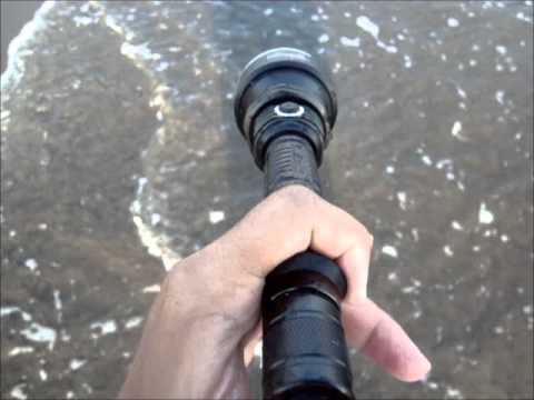

Leak testing
is sufficiently airtight to fall into the water and stay alive as you can see in my video
