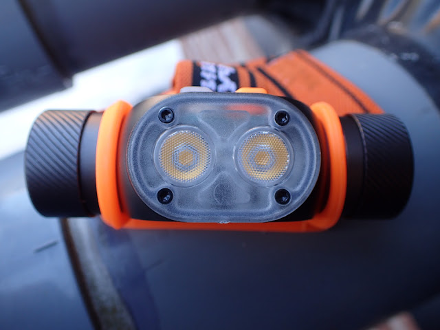

Around the front, a plastic cover is held on with 4 Torx screws, and keeps the two TIR optics secure. The plastic cover protects the lenses themselves, and the manufacturer includes a spare in case it gets too scuffed.

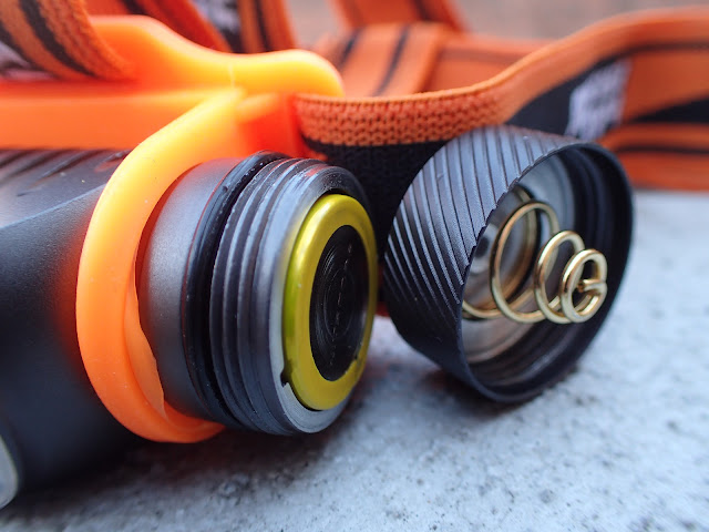

Around the opposite side is the cap for battery replacement. Detailing around the cap makes it easy to grip for cell changes. The cap is etched with a "HI CRI" label, which is the only marking on the entire light.
Unscrewing this cap reveals the thick construction of the body tube. The threads here anodized, which means the light can be physically locked out from accidental activation by slightly loosening the cap. There's a sticker inside indicating the polarity of the cell, which gets inserted positive end first. The contacts with the cell at both ends are springs.
