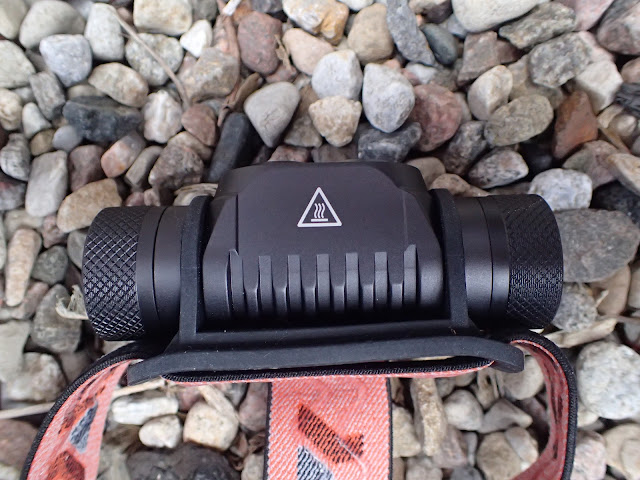

The two buttons are held in place by stainless steel rings. There are some shallow fins cut into the rear of the headlamp to help with cooling.
Not much going on underneath the light except a hot warning etched into the coating. Notable that this is one of only two labels on the light - there's no naming or branding anywhere on the body.

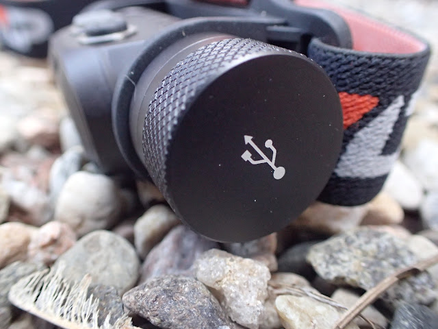

The other labeling is the USB symbol on the right endcap.
Removing this reveals the micro-USB port used to recharge the light.

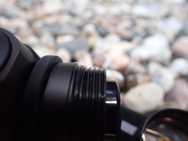

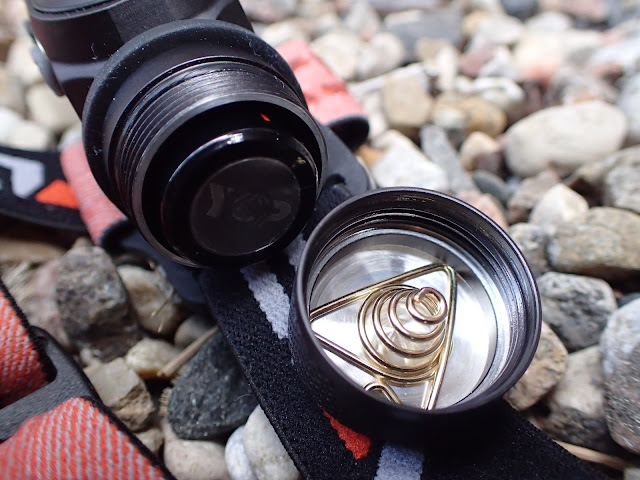

The other end cap is used to close the cell tube. The threads are anodized, so you can prevent accidental activation by backing off the cap a quarter turn. Each cap uses different threads, so there's no risk of mixing them up. The large spring serves as the negative contact for the light.
Inside, there's another spring serving as the positive contact.

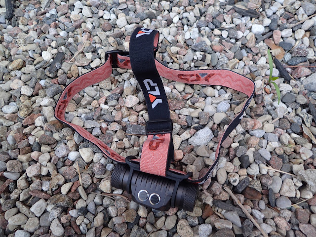

Ergonomics and Retention
This is a dedicated headlamp. It comes installed in a headband, and there's really very little reason to ever remove it or use it in any other way. There is no lanyard loop, clip, or magnet included... because it's a headlamp.
The included band is good. The adjustment works well, the headlamp doesn't bounce around too much, and the silicone bits inside the webbing help it stay in place. There are no reflective markers on the included headband.

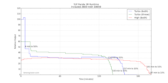

Running both LEDs at full power gives a step down after a few minutes, settling around 30%. Although the runtimes are less stable than the Panda 2M CRI, there are no steep drops or other weird behaviours. It's worth noted that, on turbo, the light got quite hot - much hotter than I'd like something strapped to my head or tossed in a bag to get. I would suggest against using turbo for too long in a single go.
YLP does not list runtimes for the light on turbo, as it's thermally controlled and will vary depending on the environment - not completely unreasonable. The dual LED runtime on high is listed as 2.5 hours. I measured 3.3 hours, which is far longer than claimed - and that's with the included and relatively low capacity cell. A 3500 mAh cell should stretch this even further.

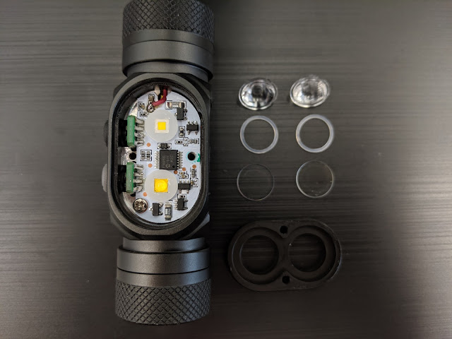

Teardown
Teardown is a bit of an exaggeration, but I like using that scary word to remind any readers that this isn't recommended. Anything that requires tools has the possibility to void your warranty, depending on how badly you mess it up and what sort of mood your warranty provider is in - but people like to see the guts.
The two T6 screws holding the metal gasket in place come out easily enough. The gasket itself is a tight fit in the body, and takes some wiggling to work it out, but nothing challenging.
YLP did a good job making sure this unit was sealed - there's an o-ring around the metal faceplate, one on each of the optics, and another around each of the screws (not pictured). It's also nice to see two tiny, AR coated glass lenses used here to protect the soft plastic lenses from any scuffs. I'm really impressed with this design.
And here's the guts. The LEDs and driver are all on a single board, and the switches are mounted on the side of it. It's nice to see that the switches are mounted into cut outs in the aluminum, so the solder isn't the only structural support. The single board layout is probably bad news for anyone thinking of swapping emitters, but it's definitely possible for someone with the right skill set and tools. I also like to see that there's a screw clamping the board down to the heat sink, though a second screw to ensure even pressure would have been better.

That’s impressive. How did you swap the LEDs?
Not that difficult actually. I know Aede reflowed some LH351D on his Panda 3 so I thought it was doable. Taking out the PCB with everything on it is very easy. Just desolder the single wire and unscrew the single screw. Used a lighter to reflow carefully. Easy enough since the underside is just copper. Just make sure you don’t do it too quickly and you don’t overdo it. Usually I start at a safe distance and gradually put the flame nearer little by little every 10 seconds or so. The flame does not have to touch the board for the solder to melt. Careful also not to touch other components since they’ll probably get desoldered too.
Actually the main difficulty is not to melt solder near buttons.
If you do that surface tension attract button pcb to main mcpcb. After that you should unsolder button pcb, install both button and main pcb in host to fix angle between them, and solder it together again. It is not deficit but many extra work.

AEDe, I’m looking at the photos form your review and it looks like you could use a few drops of epoxy to affix the switch boards to the main board so they don’t move when you heat the main board to swap LEDs.
Would that cause any issues reassembling the light?.
TexasToasted, glue is good idea but epoxy can demage optics as I heard so be careful.
I did not run into this problem maybe because I was overly cautious with the heat while reflowing. This is good to know though since I may get another one and I’m changing leds on that one too. Thanks for sharing AEDe.
