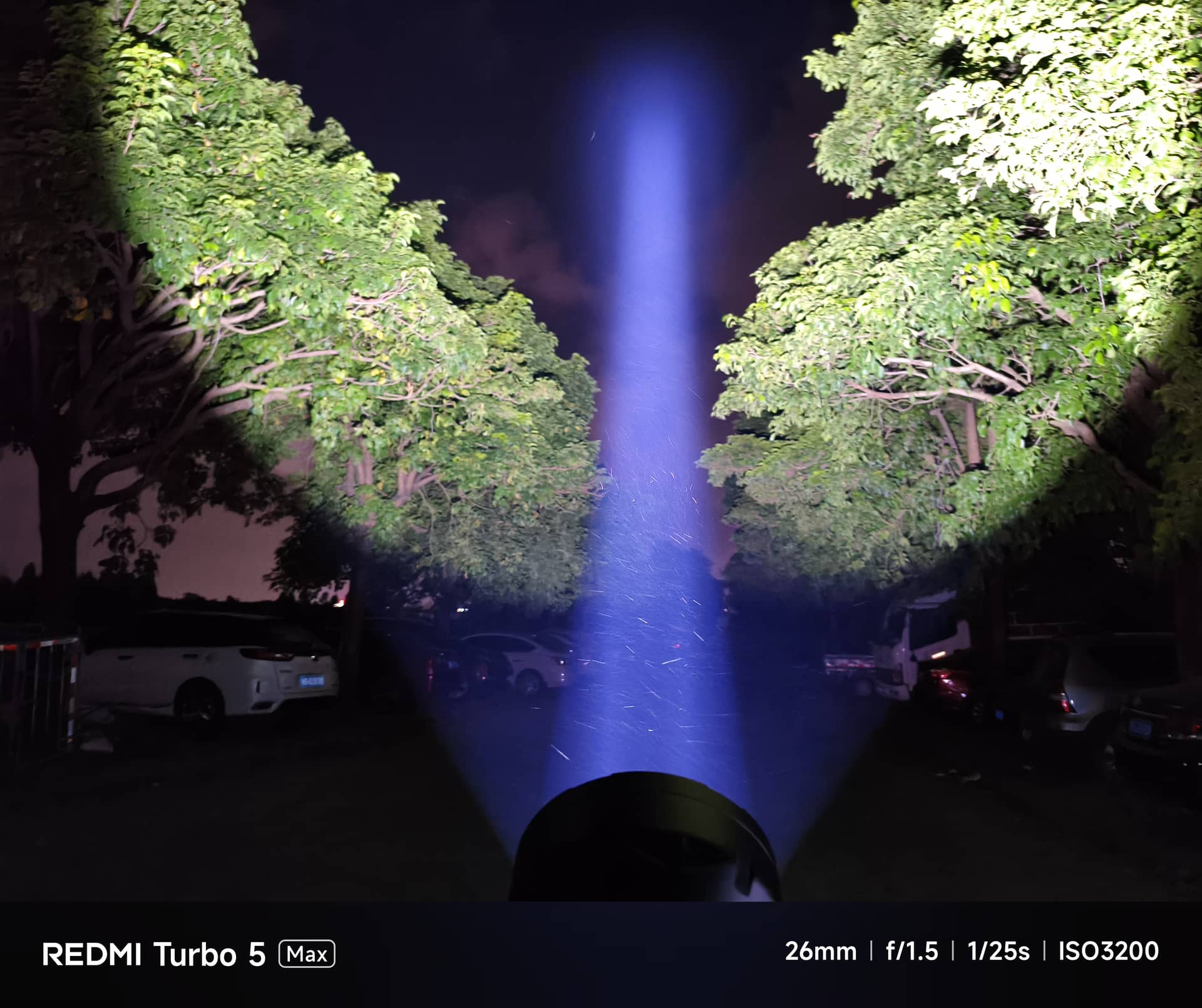

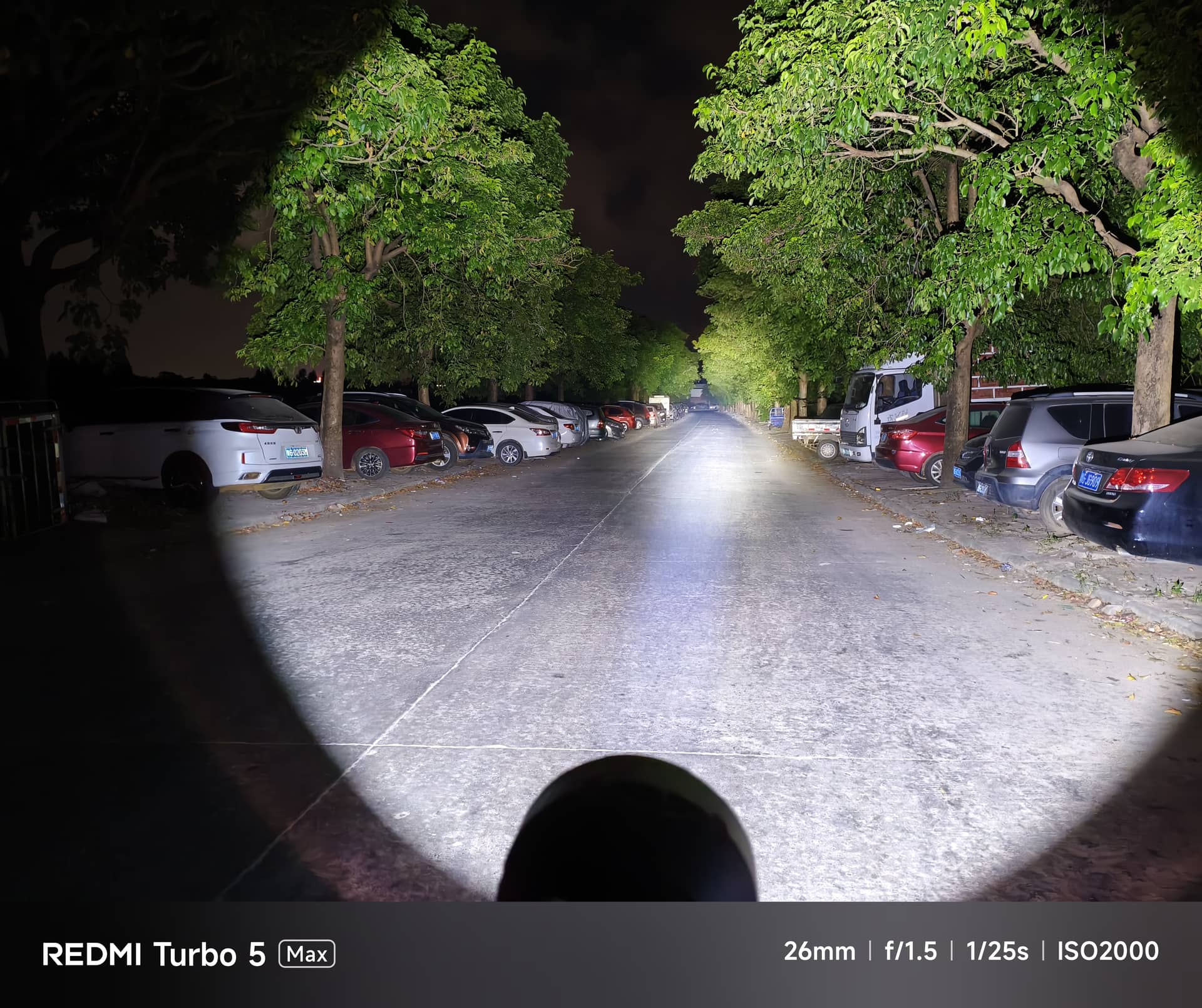

Reylight BLF GT 1.7 M cd, 2600 m ANSI throw @ 120 W (FL8032P Gen 1)

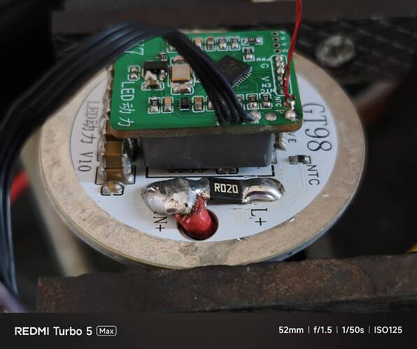

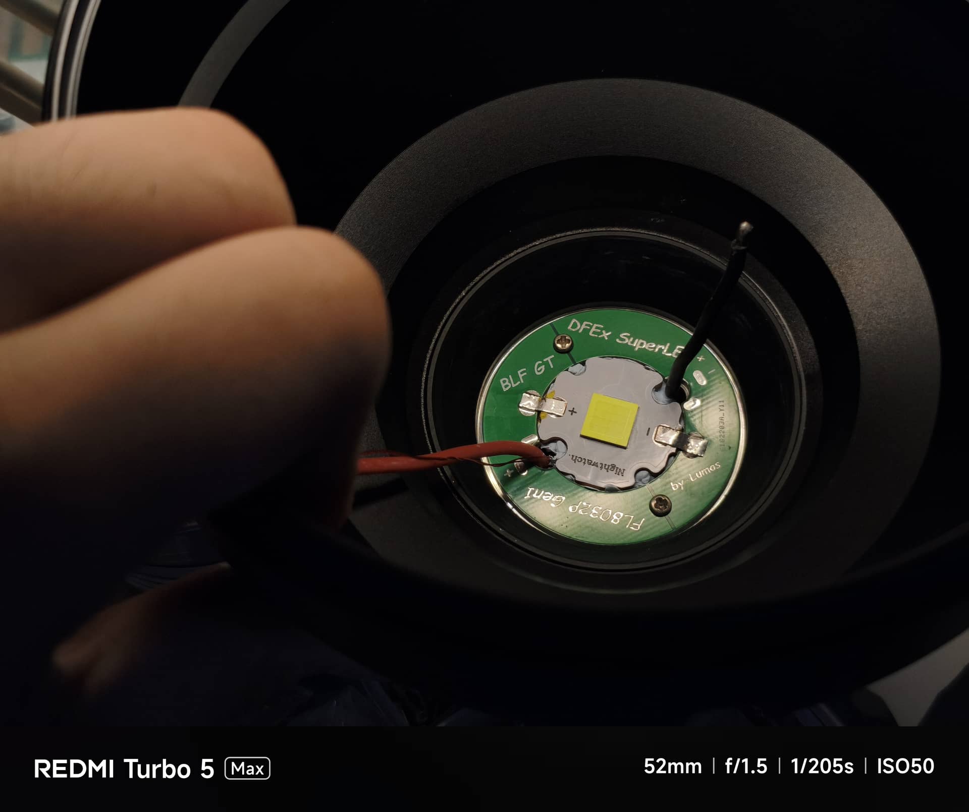

Reylight BLF GT mod: 4S full constant-current driver paired with Super LED+ FL8O32P Gen 1. Projected intensity from spectrometer data hits 1,700,000 cd, yielding an ANSI rated throw distance of 2,600 meters. PS: Not pushed to the absolute limit — this is at a sweet-spot power of 120 W. The binning consistency on these LEDs is excellent, a dream for perfectionists.

What kind of led is this?
Not familiar with this naming. where did you get it ??
Also curious.
Just to sanity-check the math: the GT has a 118mm reflector, and the optical losses are at least 10%. So in order to get 1.7Mcd out of it, the surface luminance of the LED must exceed
1.7Mcd / (pi* 59^2 mm^2) / (1-10%) = 172 cd/mm^2.
In comparison, the LHP73B registered 151 cd/mm^2 at 100W. Since OP said 120W is a sweet spot, this new emitter must be larger+floodier than the LHP73B while beating it in throw, which really would be something.
