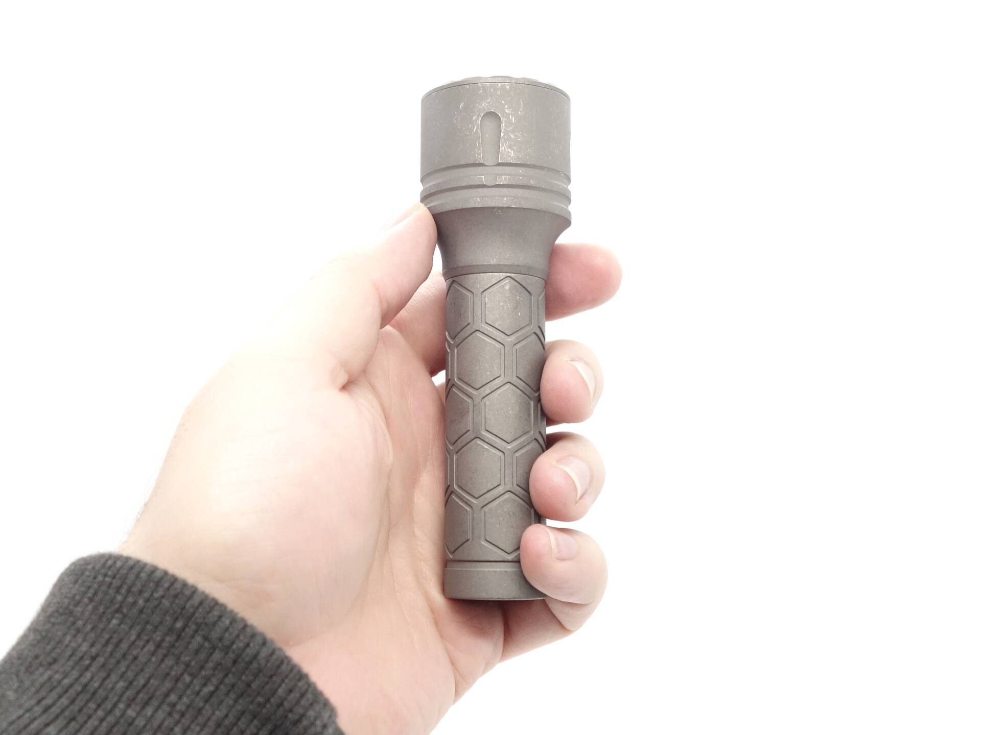

The ReyLight Dawn Max is a thrower available with an FFL505A 3500K or an SFT40 5000K LED, an 18350 or an 18650 tube, and various titanium finishes. This particular torch has a Ti Stonewashed finish.

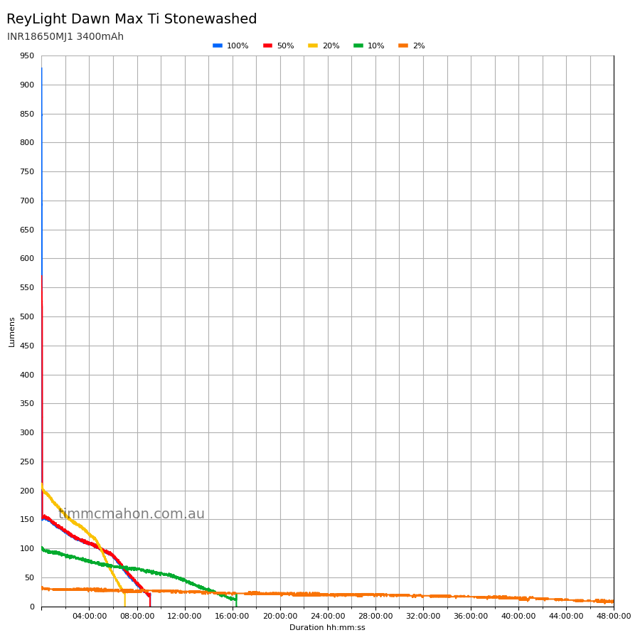

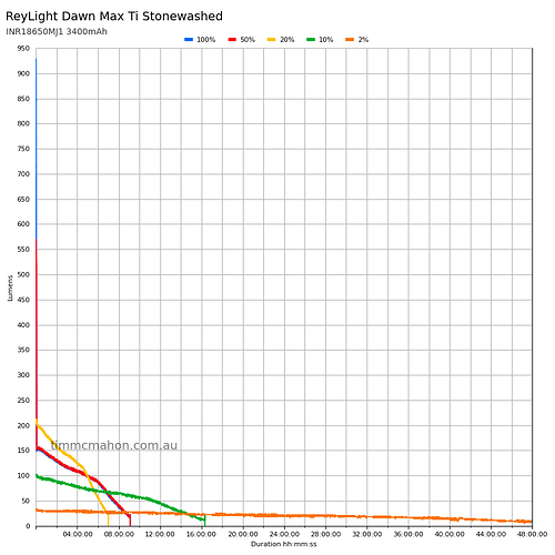

The runtimes are good.

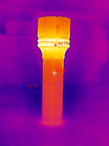

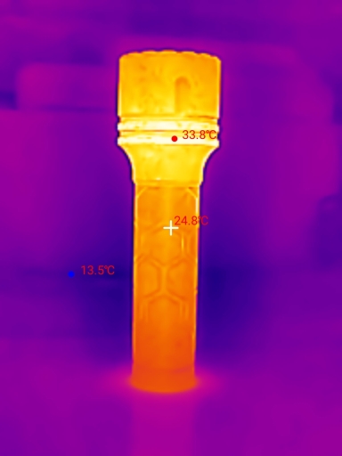

The head gets a bit warm (45 C) on 100% after 3 minutes.
And then it starts cooling down. It looks pretty cool after 10 minutes.

I find the 20% mode to be very practical when walking along a track for 30 minutes. The drop in output is barely noticeable.
The drop in output becomes more noticeable after about 2 or 3 hours of continuous use at 20%.
