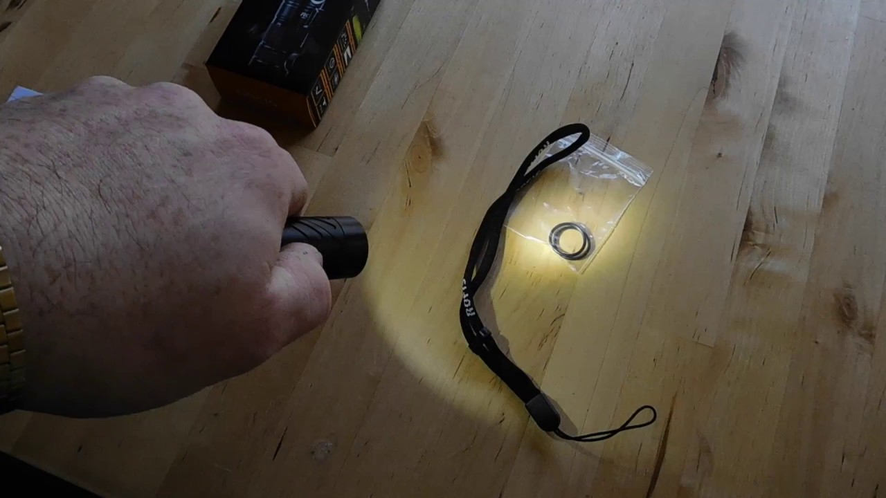

What’s in the box?
The TR10 comes with the usual spare o-rings and a lanyard.
