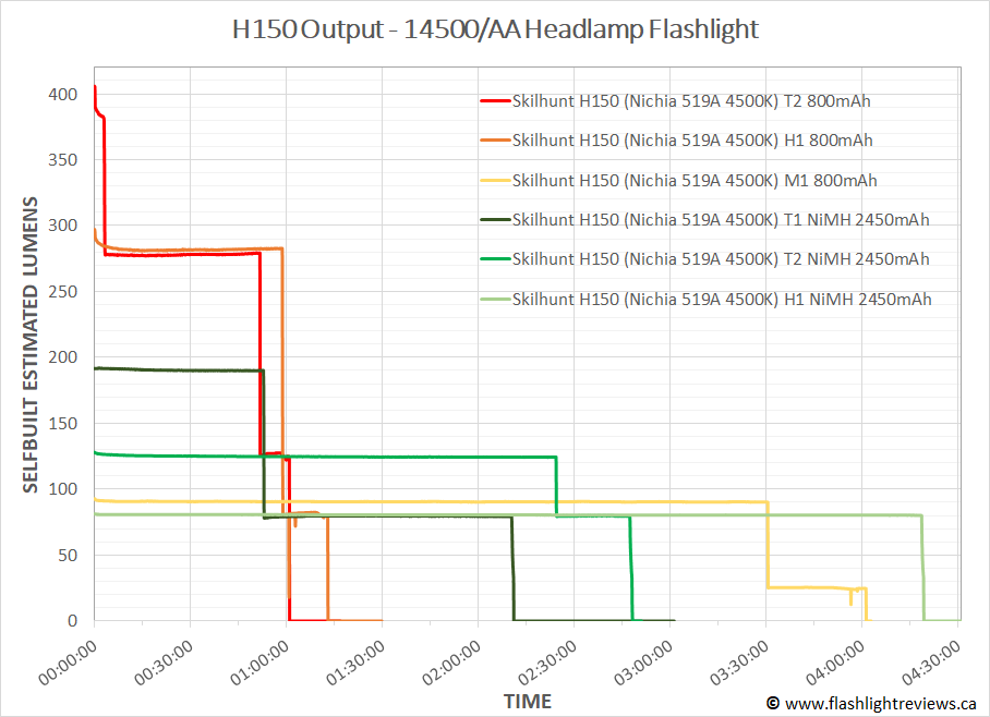

The H150 is a compact headlamp flashlight with a floody beam with excellent colour rendition. It runs on a single included 14500 battery, or a regular AA battery. Here is how it compares to larger 18650-based sibling, the H300:
And how it compares when run on AA (NiMH):

There is no reason the M150 with the same emitter should have the different results correct?
Exactly. My testing of the H300 and M300 suggests that you should see equivalent performance of the H150 and M150.
