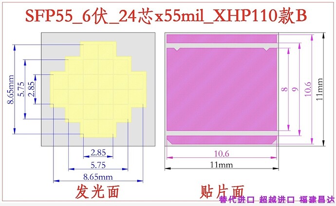

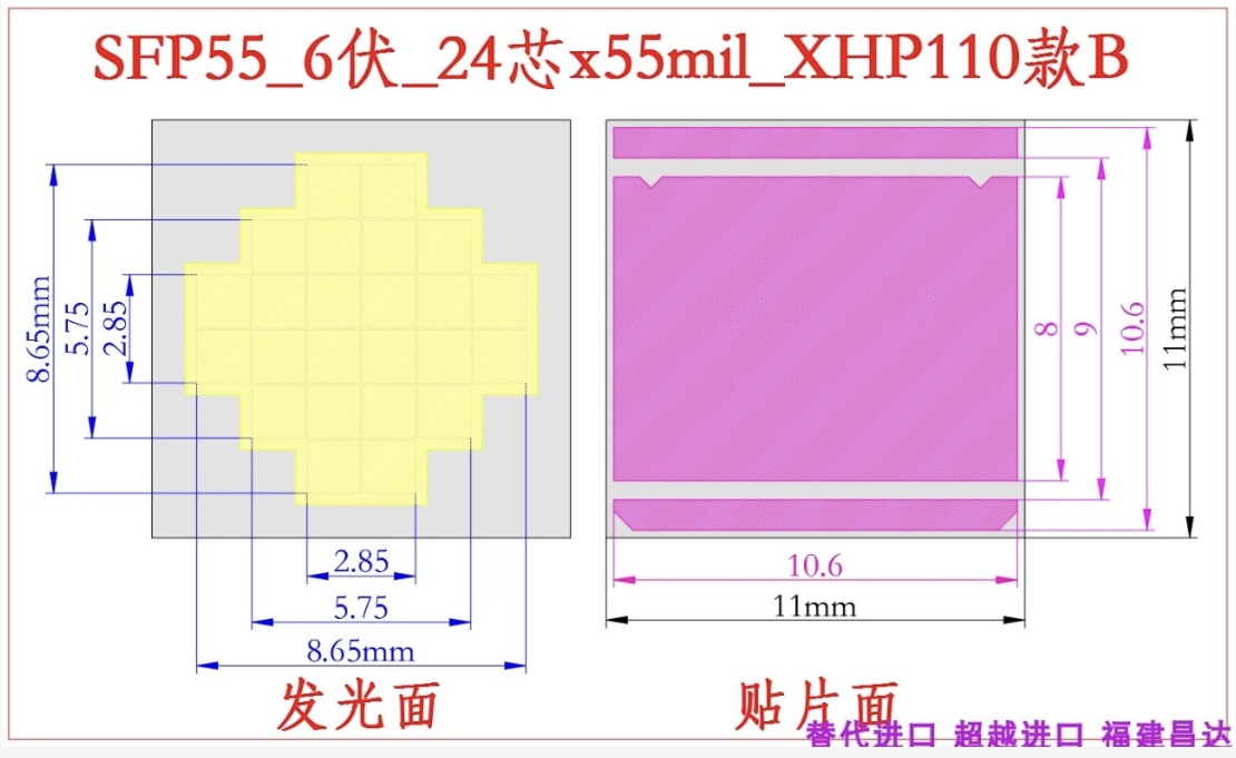

For me, this second order was mainly for a SFP55 6v.
I wanted something with more lumens than a XHP70.x and for this project I needed a 6v LED on a 25mm MCPCB.

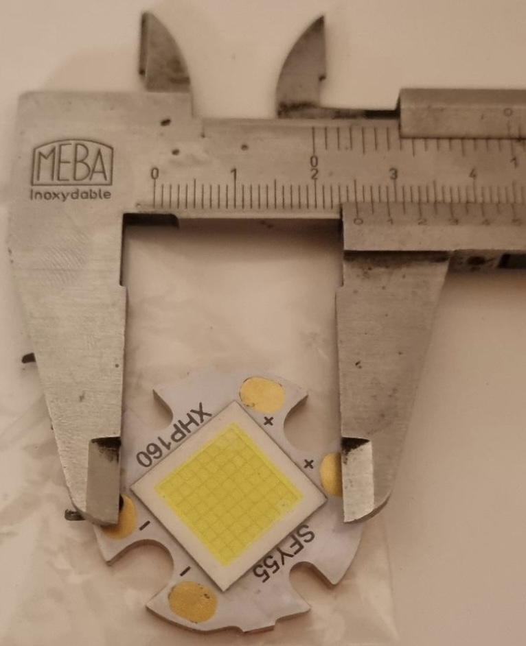

If you mean the SFY55… there are some news. I got one sample of this giant LED, so I was able to do a first test.
At 60 Amps this beast goes over 22000 Lumens! My PSU maxed out, the possible max current should be at around 80-100 Amps I assume, at around 28000-30000 Lumens, maybe even more.
The tint is ok, but nothing rosy. Low CRI as expected. Btw, this LED looks like a meme. The SFP55 with it’s whole package fits only onto the LES of the SFY55. Absurdly large and thus very difficult to use in any commercially available flashlight… but it’s insane and absolutely awesome :smiley:
12 Thanks
Dannnggg. Do you have a photo? It would be an awesome led to put in a fan cooled host, or maybe a BLF GT or a big thrower like the MF04. I doubt you’d get 60 amps out of the stock drivers thiugh, and you would need a 46950 or 46110 battery to run it.
Picture by @LunaLoves:
I want one for a thrower S2+😂
Mm.. I am not sure :smirking_face:
I said: difficult. Not impossible.
