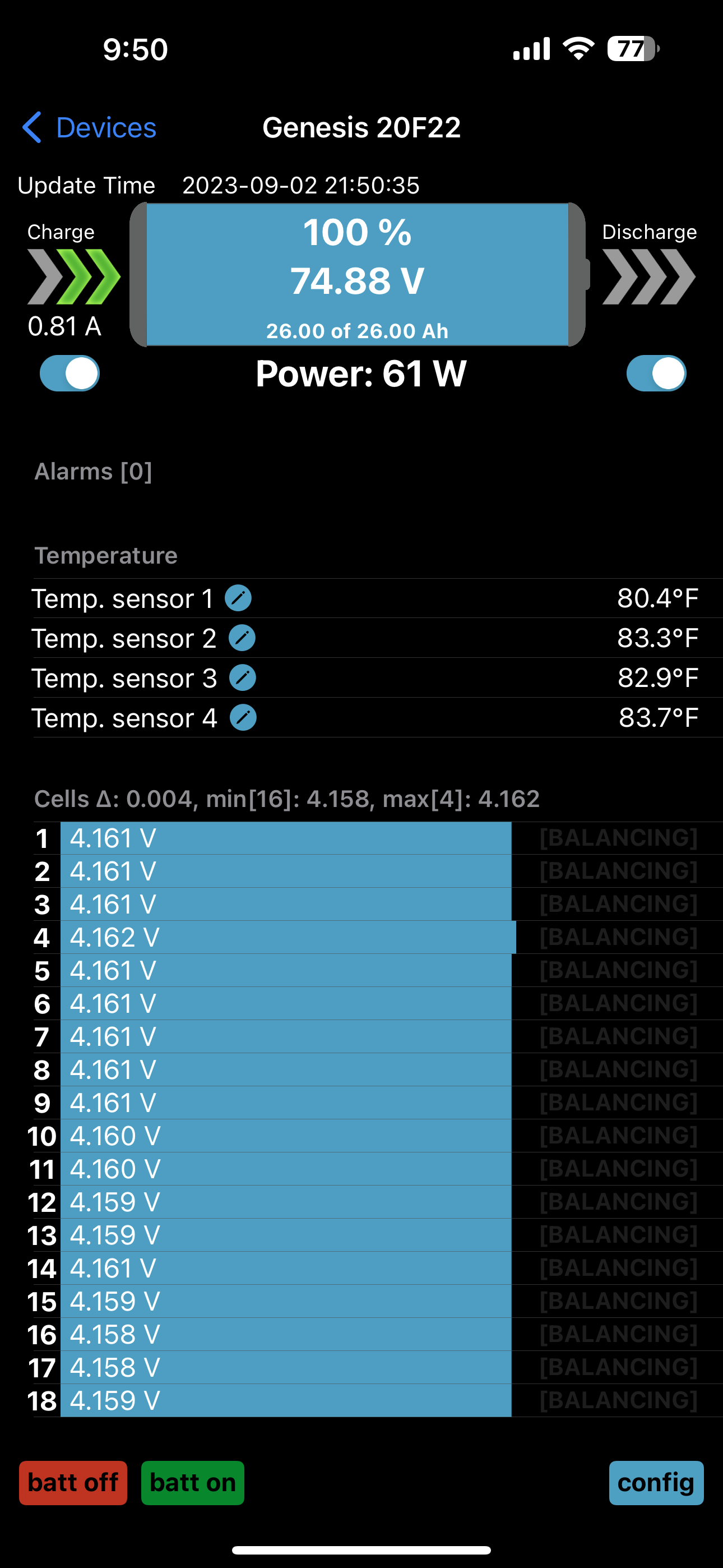

Howdy, folks. I have a follow-up question on this.
The XiaoXiang BMS app on my iPhone shows what appears to be buttons at the lower left that say “batt off” and “batt on”.
I’ve been afraid to touch them for fear of effing something up that makes me have to disassemble the whole pack.
Can anybody confirm what those do?
Specifically, this battery pack has a charging lead that doubles as an On/Off switch. It has 4 pins. I can connect the charger/power supply to it to charge. Or, I can install a cap that makes some connections (inside the cap). Without the cap on, the scooter won’t run - but I can still talk to the BMS via Bluetooth.
When the scooter is stored, I’m supposed to remove that cap from the charging connector to stop parasitic drain on the battery. Meaning, it only has the parasitic drain of the BMS. I guess the motor controller creates additional drain when the charging connector cap is installed.
I’m wondering if I can use the Bluetooth app to do the same thing as removing/installing the charging connector cap. I.e. if I tap on “batt off”, is that going to cut all power to main output leads? And then I can still go in at any time and top on “batt on” to turn it back on?
Does anybody know? Is this the kind of thing where only the manufacturer of the battery pack could really say for sure?
It would be great if I could leave the cap on the charge connector on at all times, to protect the 4 pins there.
Thanks.
12ga.
(18.5mm, so…)
Yes – you can turn the BMS Off and back ON with the App — All that charging cap you speak of is doing is connecting 2 pins together that normally have a On/Off switch connected to — Yes there’s still a Parasitic Drain even when it’s off – I don’t think it’s that much --Just monitor it to be safe
I also emailed the manufacturer to ask the same question. And, I was pleased and surprised to get an answer back last night.
They say that the BMS MOSFETs will leak a bit even with the BMS off.
So, if the battery pack is connected to the motor, then I should still take the charging cap off, to disconnect the motor, even if the BMS is off.
So… there you go.
Thank you again for all the help!!
