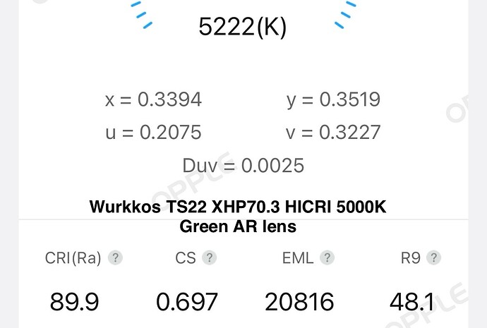

I did test two different AR coatings in TS22 :slight_smile:
could you test again minus the lens?
I took it from my archive. I could potentially try it without the lens when back home if not too tricky. However, I bet the duv will be between those two values I already measured.
Based solely on numbers, I’m inclined to agree, but is the transmittance value based on quantitative volume of aggregate light, or qualitative volume? i.e., if I filter some of a specific wavelength, if the intensity didn’t decrease substantially, would it still be the same quality of light and maintain an AR transmittance rating of 94%?
thanks in advance for testing!
I get this question but I’m pretty sure OPPLE is not the right tool to inform the answer. Proper spectrometer is needed here.

What I found (from many hours wasted :slightly_smiling_face:); hope this helps. The best/surest way to test, for me anyway, is to place flashlight under a ceiling light bulb, then look for that light bulb reflection on the flashlight’s lens.
Greene-reflection AR: no effect on the Duv (no change, same value as non AR lens).
Purple reflection AR: about 20 points, ie 0.0020, more positive Duv (greener tint on beam).
The reflection could have many different colors: teal, blue, etc. Green reflection is the best (no change in Duv from no AR lens). AFAIK, the few people who have tested it, found similar result.
IMHO, what I learned that was most important from my “experiment” (amateur equipment, but repeated many times to ensure accuracy) is that a Green-Reflection AR lens does NOT improve the Duv over a non AR lens. It just doesn’t make it worse (more greenish).
OTOH, a Purple-Reflection AR lens does make the beam color more greenish, or worse from enthusiasts’ viewpoint. To me, not at all worth the small and hardly noticeable 3-5% gain in output (measured with Texas Ace lumen tube, Wurkkos TS30S).
