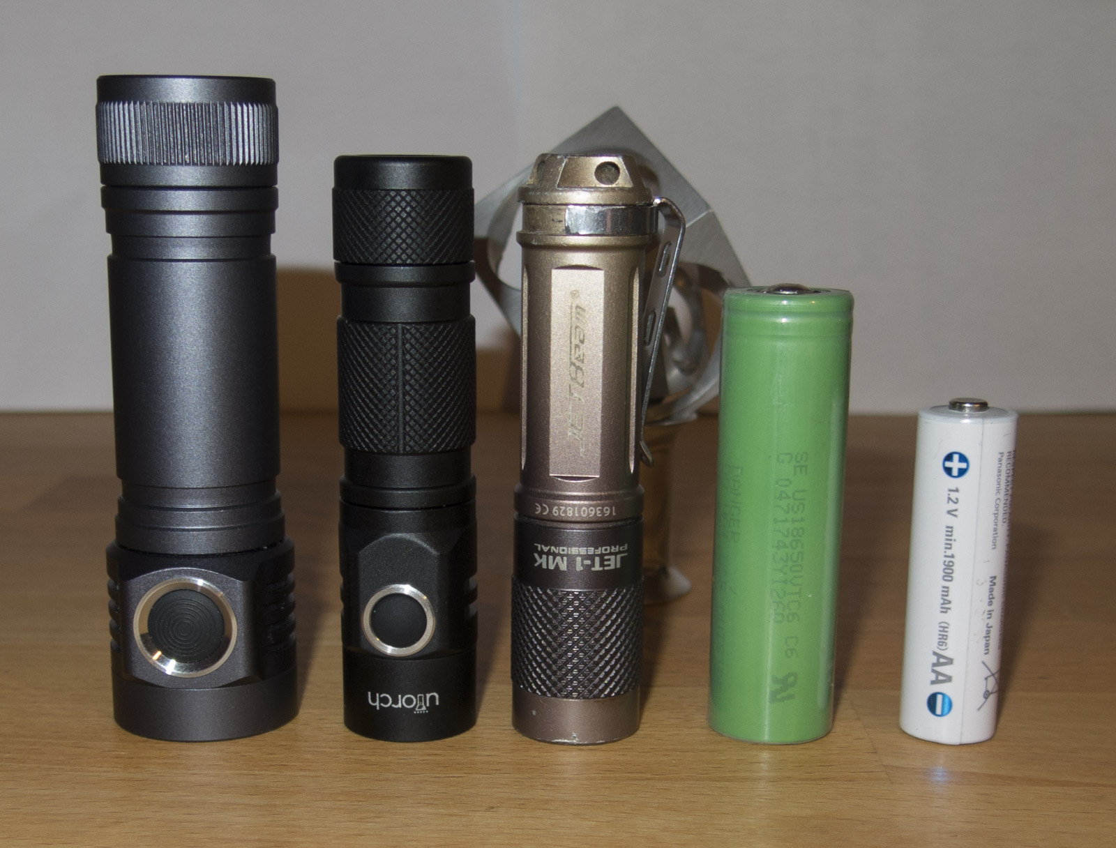

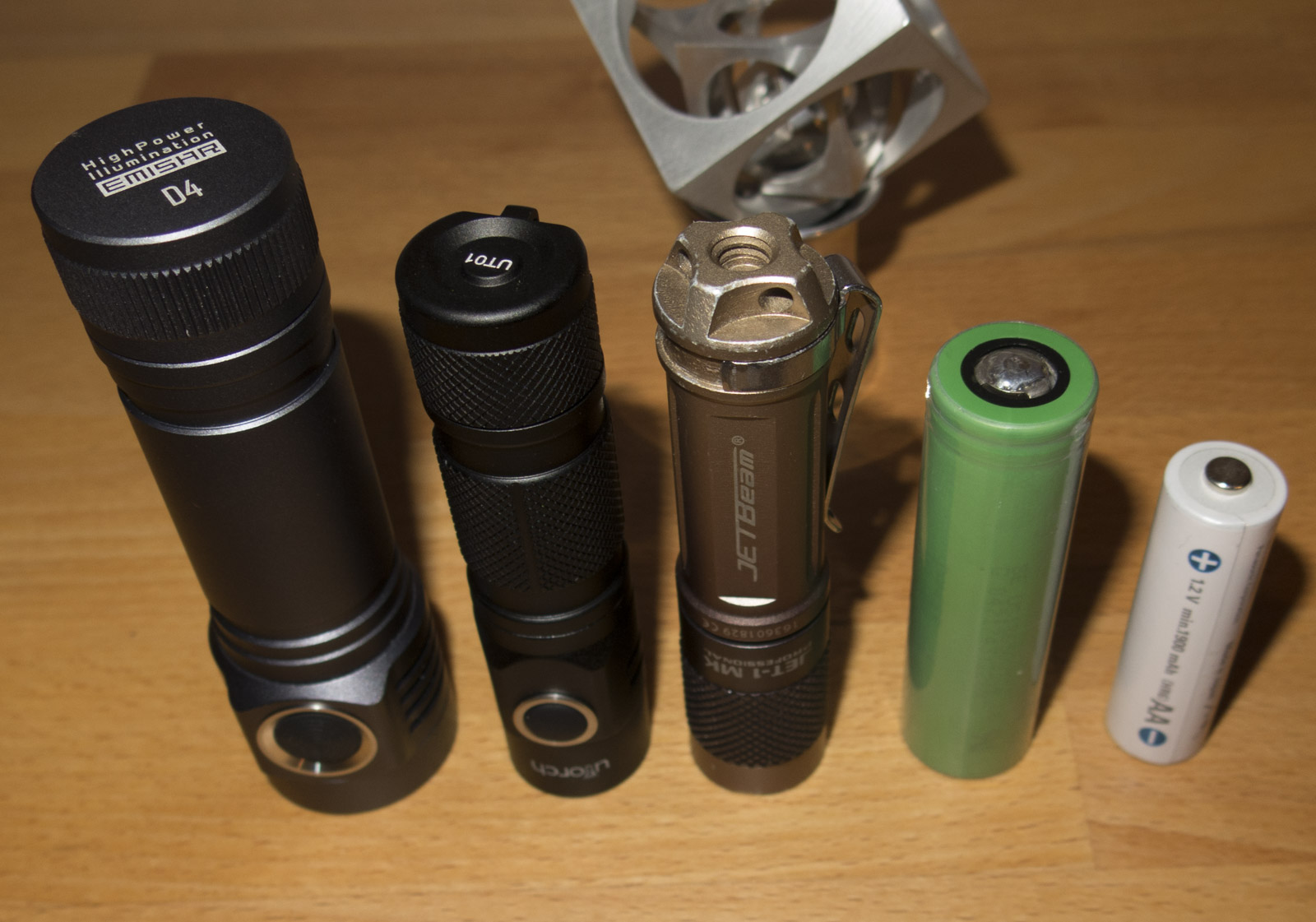

Size comparism

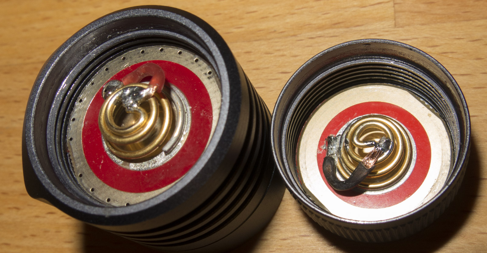

Spring bypass
I also noticed there is very little solder paste on the springs but they seem to hold fine

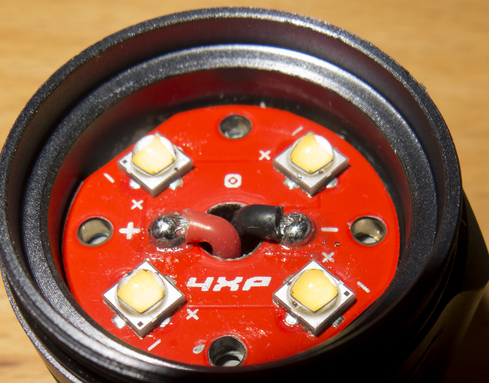

The LEDs are reflowed with very much paste, it would be better to give em a tap to push solder out to get it as thin as possible or use less
the LEDs are reflowed with Leaded solder

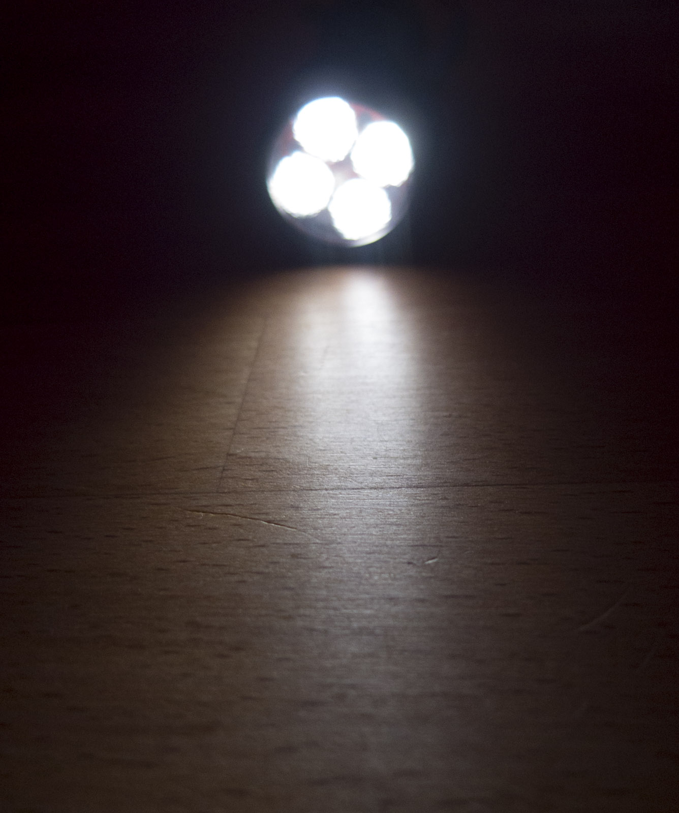

Reflowed Nichia SW405 D2450 CRI9050 in it
Used my temperature regulated heat plate
Gave the LEDs a tap to remove too much solder, so also a lot solder blobs are all over the place
carefully aligned the LEDs to the markings if they were off
Used a little weight to push the LEDs down while cooling the heat plate with water filled pot
Light is now drawing 15.8A at 4.1V Sony VTC6 battery
