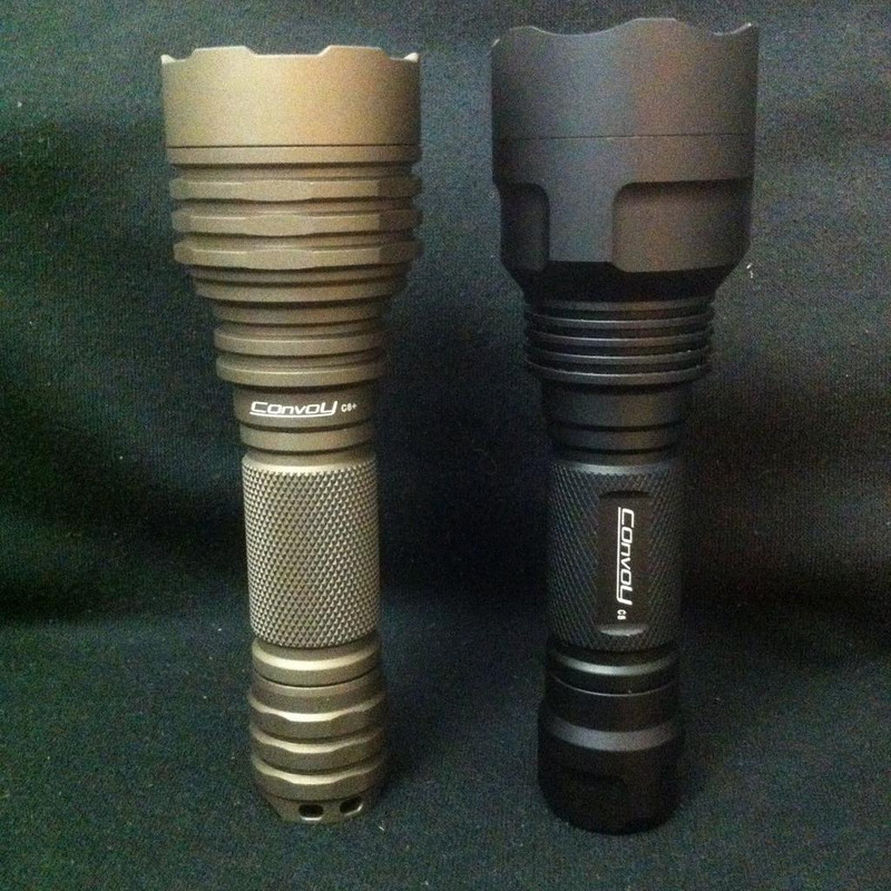

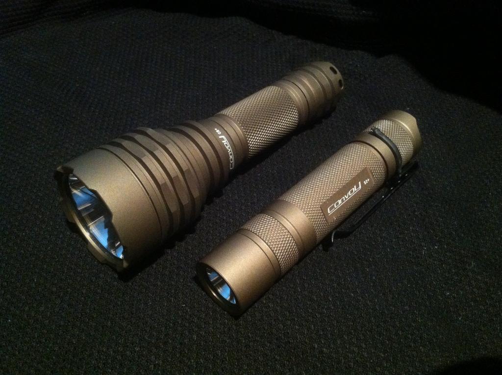

I was expecting the C8+ Oak Brown to be the same colour as the S2+ Desert Tan and that GB had given it a different name. Well, something happened that never happens, at least that’s what I tell my wife… I was wrong! (I hope she doesn’t see this) :stuck_out_tongue: It turns out Oak Brown is a darker shade of brown, and it is REALLY nice. This is a big call, but I might like it more than the DT, regardless it is certainly the nicest colour C8 I have ever seen.
Of course getting a photo that accurately depicts the real colour of the oak brown is hard, especially as it is almost a “chameleon” colour that seems to change hues depending on the light source. Then again, judging by how grainy all these pics became after uploading them the problem could be that I mistook a potato for a camera :person_facepalming:
It’s not just the colour of the C8+ that makes it what it is, an external redesign has also occurred. I really like it although at certain angles it can look a bit busy, however it feels really good in the hand.
The knurling is slightly more aggressive and the anodising retains a slightly textured feel adding extra grip. Both hammer and icepick grips feel much better than the original design, I am generally not a fan of cigar grip but it is more stable than the previous version due to the grooved tail-cap.

All the main threads match (I didn’t test retaining rings) between old and new allowing the Convoy C8 remote switch to fit, and presumably the SS bezel.
And for those that like lights and funs, the C8+ fits a 25mm mount nicely despite the slight increase in girth for the heavier knurling. Of major importance to me is the rubber boot switch, I will admit it doesn’t look as good as the metal switch, however I prefer the feel and increased water resistance of the rubber.

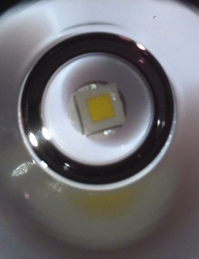

This is my fourth Convoy light, the others being a C8, an S2 and an S2+. Unlike the others, this light unfortunately has a slight alignment issue with the star. I don’t think this has caused any permanent damage to the led and in the next couple of weeks I will realign the star.

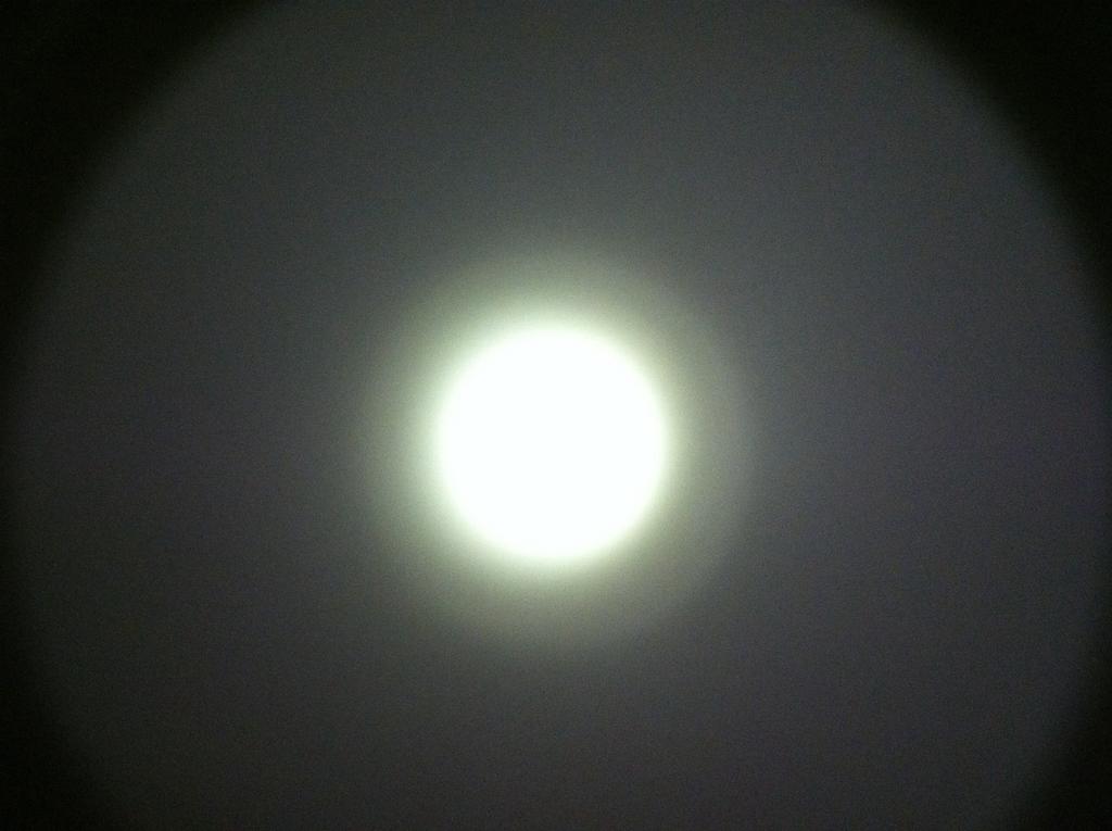

The actual hot spot looks good to my eyes, but without a light meter it’s not possible to say if, or how much throw distance has been affected with the current alignment.
