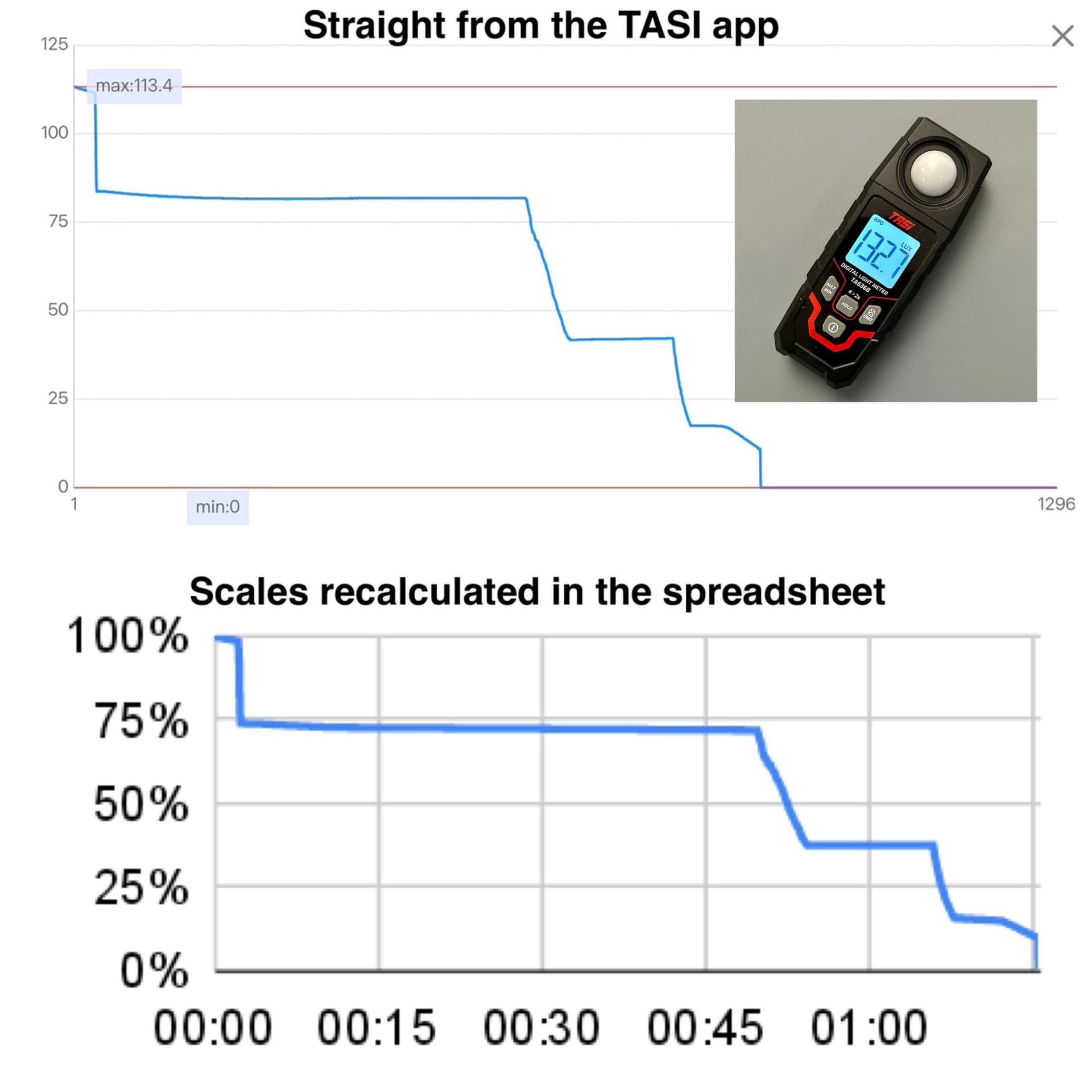

Simple way to measure the runtimes (TASI TA636B lux meter)
Quest: to be able to measure/check the runtimes with the minimum effort, with the dedicated cheap lux meter without the need to keep the mobile phone/computer hooked to the task.

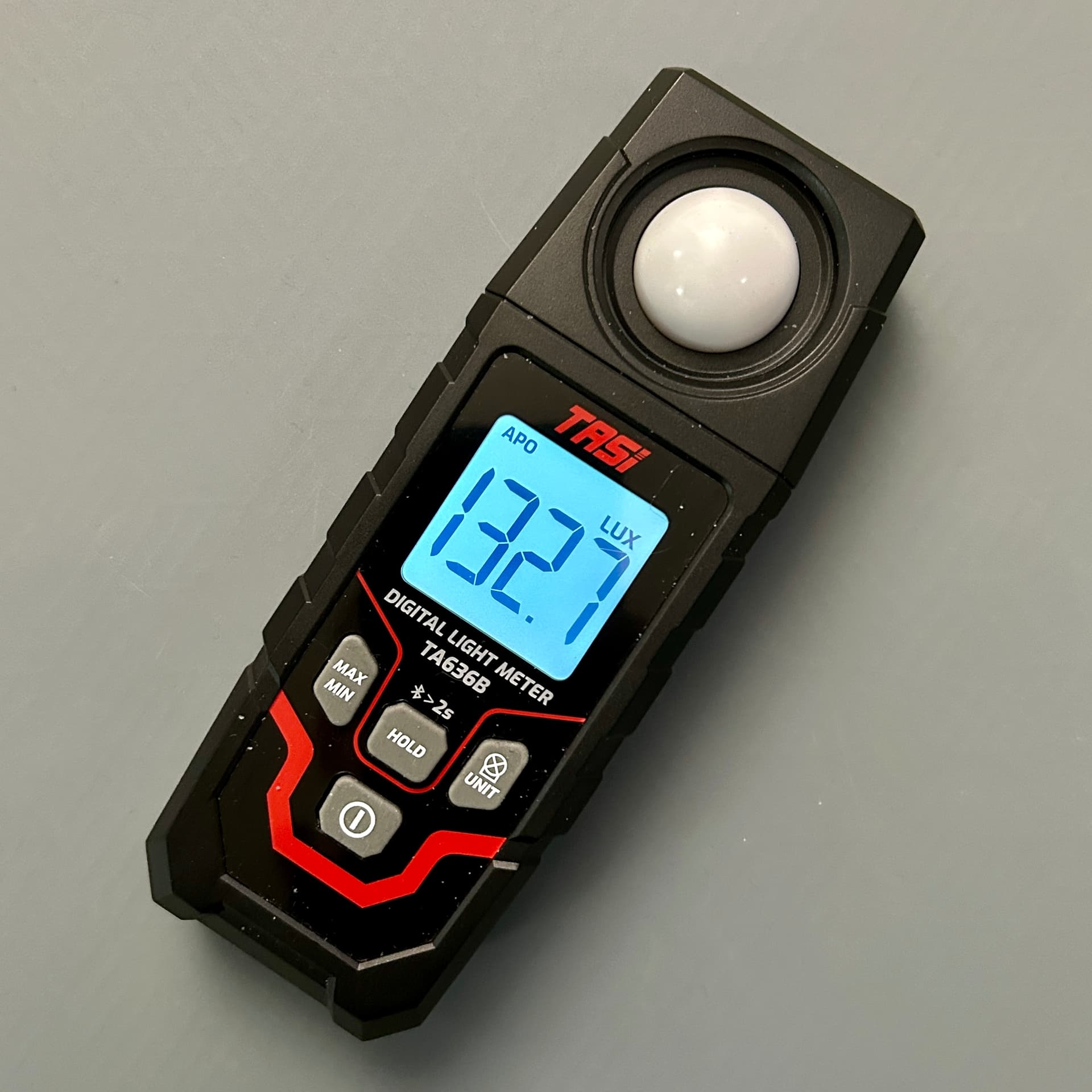

Solution: TASI TA636B Digital Light Meter

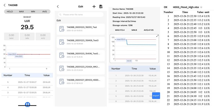

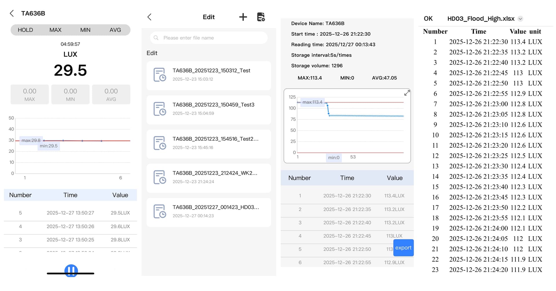

  • Bluetooth connection and Android/iOS apps
  • internal memory for up to 2,000 samples; time between the samples can be set in 1..60 seconds range
  • ability to trigger the measurement via the app and let it run on its own
  • the results can be downloaded to the app, viewed in the app and exported to PDF and Excel formats
I don’t need an absolute accuracy when all that I want is to recognize if the output is regulated, if/what stepdowns are present, or the total runtime. Thanks to internal memory it does not need mobile/computer during the measuring run.
This ~recently premiered meter meets my needs perfectly.
The results show here are for Wurkkos HD03, for the Flood channel on the High level.

  2. I’m using iPhone so the link led me to the AppStore. In case of Anduril you will have to download the .apk file and install it „locally” (I did not try that). Check the download page: http://china-tasi.com/appDown
  3. The app gives the absolute values (observe the top part of the first OP picture). You would have to export the data to Excel (see the right-most screen shot on the third OP picture) and recalculate the values, assuming the first sample as your 100% „reference”. This way you will be able to create the graph as the bottom one on the first OP picture
