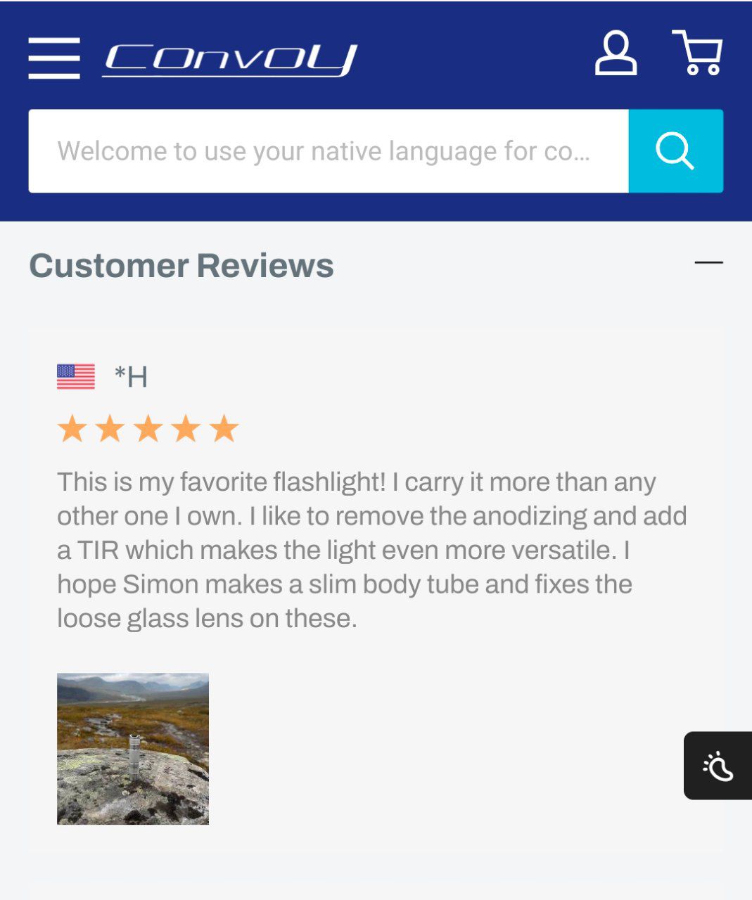

Is this you, BTW? If not, a popular solution, it seems :grinning_face_with_smiling_eyes:

The reviewer is not me, but I agree with their points! The glass lens is a bit thin/loose and messes with waterproofing; I’ve laser-cut my my own lenses with thicker acrylic.
