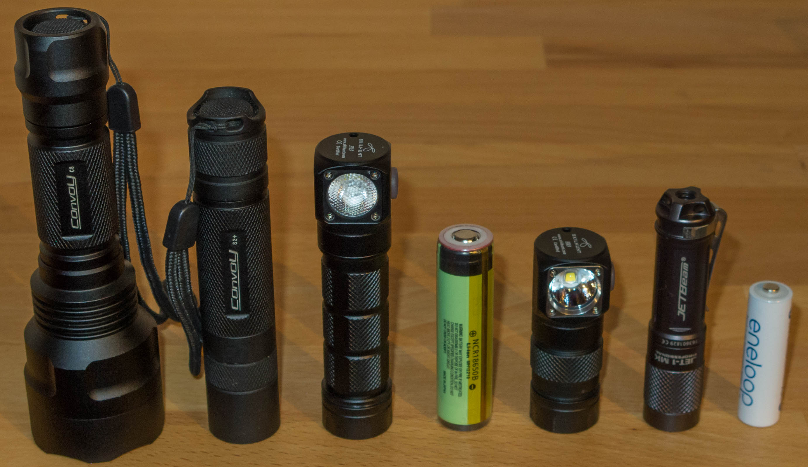

The result is a very light but powerful headlamp.
I cut later the upper headband off and attached the band so that the whole silicone back sticks to my forehead.
I use an Efest protected 18350 900mAh battery its a very tight fit the diameter and lengh are the max what would fit.
With an Panasonic 18650B and magnet.
I also got the AR glas from my Jetbeam Jet-1 MK in it or maybe a microtextured lens from pflexpro user.
106g with 3 strap headband magnet removed,
97.55g headband just the horizontal band
and cut the silicone holder for the 3. band should remove weight even more.

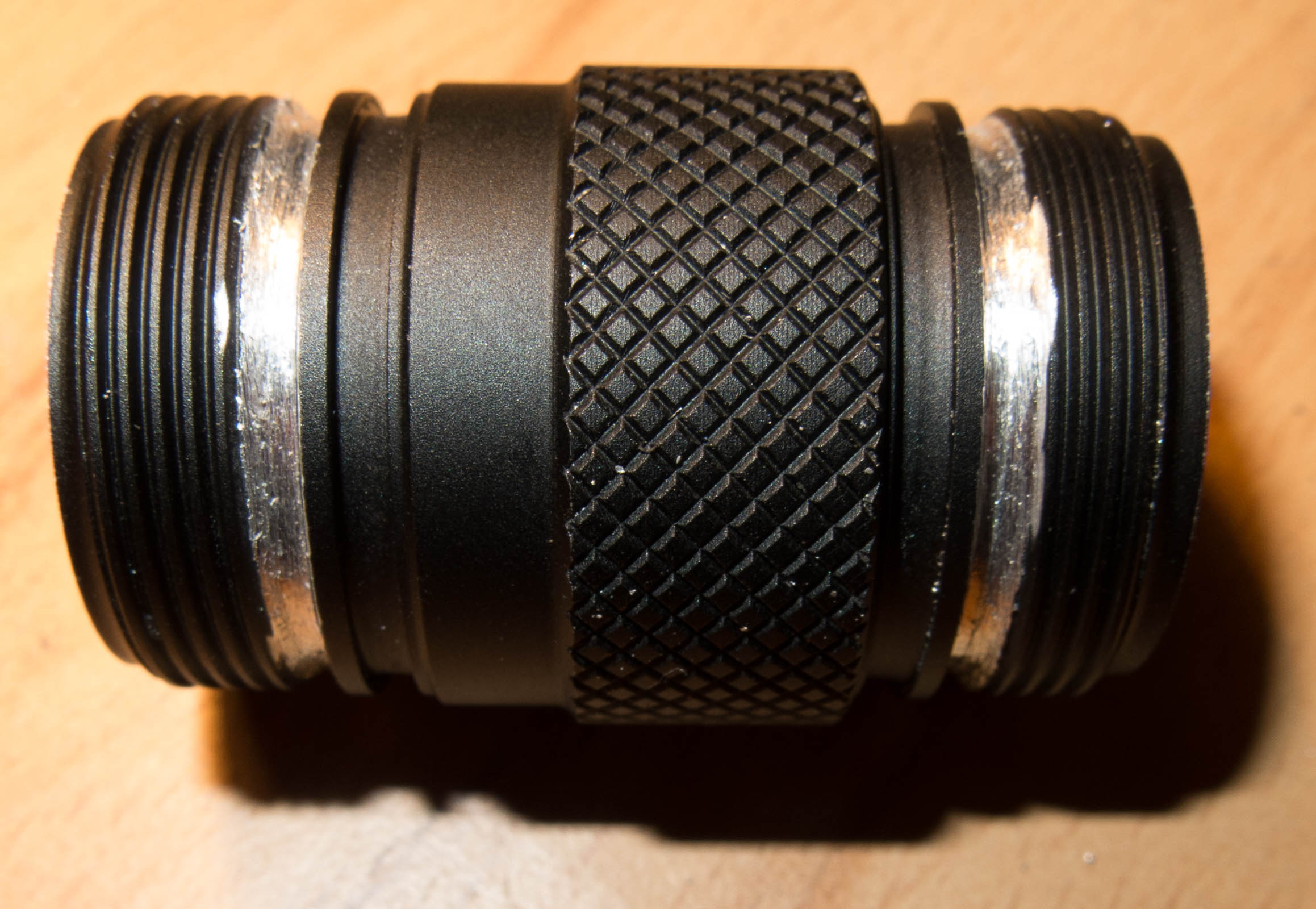

After screwing the BLF tube on the skilhunt light I noticed that the A6 has a lot longer tubes to screw in,
so I had to move the orings in front of their normal position.
But unfortionally the BLF tube is 0,3mm thicker as the Skilhunt and their orings are larger.
I tried to get the skilhunt orings on the BLF tube, but it was not enough to make it fit,
they were squezzed out a bit.
So I decided to get the tube where the orings have to be thinner in diameter.
Used first a dremel to get the anodisation off
and then used very carefuly a metal saw to get it about 0.5-0.7mm less in diameter.

Messed up my first tube, for some reason I thought yu were supposed to sand down the ridge not the groove lol. luckily I ordered and extra and jut finished filing that one. Really easy mod if you file the part shown in the pictures above lol.

Now thinking about how to shorten the original 18650 battery tube.
Because the S1 18350 tube is not a perfect fit. [EDIT] The S1 tube IS a perfect fit, but i had the A6 tube when i wrote this ! [/EDIT]
The threaded sections are slightly smaller in diameter, i have to be careful tightening the tail cap.
Plus i want the clip on the shorty too, which is impossible with the 18350 tube.
Alright, should have checked this before…
So it turns out the Astrolux S1 short tube fits better than the BLF A6 short tube.
I ordered the A6 short tube for this Skilhunt mod, but i have a Astrolux S1 shorty too (but i use a S1 18650 tube).
