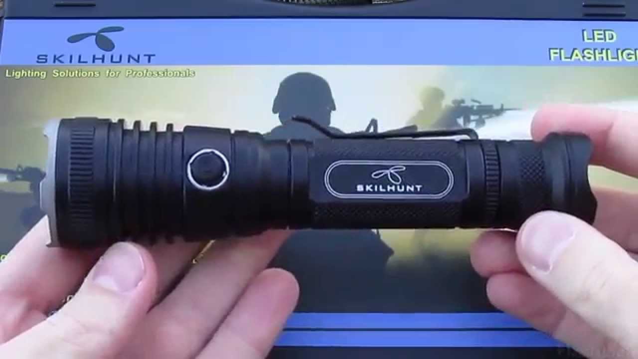

Skilhunt is a manufacturer that produces flashlights with one of the most interesting and innovative design combined with very good functionality,since its first models.
S2 Defier is the latest 18650 tactical light from Skilhunt.
As expected it has a unique design and features that make it suitable for various activities such as outdoor sports,hunting,etc.
Deep,smooth aluminum reflector.Cree XM-L2 LED.
The tail has a crown shape and initially looks aggressive,but actually it has very smooth edges with very nice feel.
The whole shape is made with great care to detail.
The access to the tail switch is easy and I don’t feel any discomfort.
The switch is accessible from the outer side of the tail.The grey part visible here is stainless steel retaining ring that holds the switch in place.
Anodizing is perfect everywhere on the body.One of the best I’ve seen.
Nice plastic case.Excellent for carrying the flashlight,batteries,a filter and accessories,well protected on a long trips.
Accessories-User’s manual,550 paracord lanyard,Two spare O-rings,Spare tailcap rubber boot,Warranty card.
Optional accessories-Holster,Extender tube(for using two 18650 batteries),Filter,Diffuser,Remote switch.
Beautiful form.Four precisely made cooling fins.Matte black hard type III anodizing.
Protrude side button,easy to find it in darkness.Clear white labeling.
Wider tail end provides excellent,stable and comfortable feel in hand.The battery tube is long enough even for big hands.

Perfectly made knurling.Beautiful looking and not too aggressive.
Removable stainless steel clip with interesting design,different from the standard shape.
I think it could be better and is not the best for this flashlight.It has not enough space for thick pants or belt.
Can be removed as the ring that hold it in place will hide the attaching place.
I don’t recommend removing the clip because there’s nothing in the shape to provide anti-roll function.This is the only flow in design.

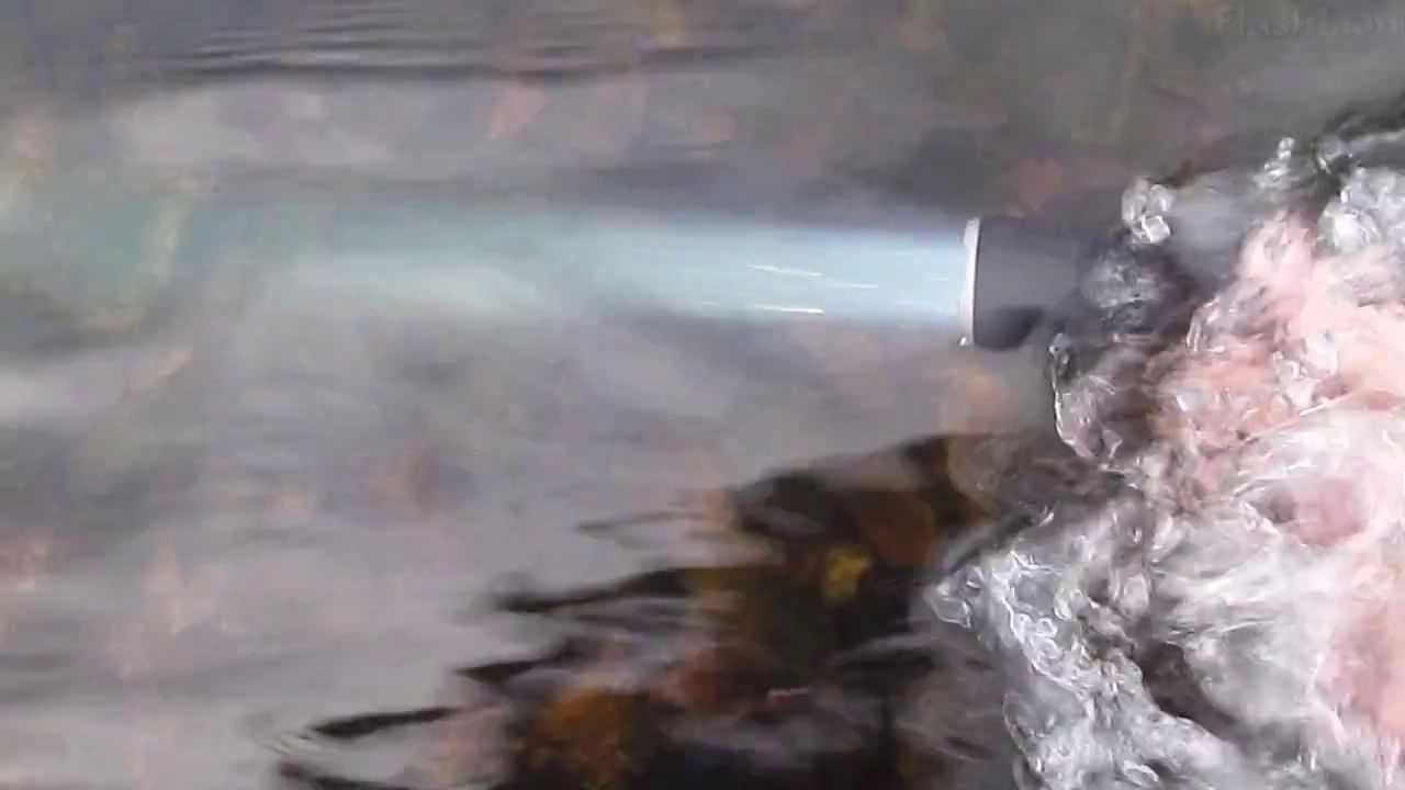

River test.
Skilhunt S2 successfully passed the test.Fully functional underwater with no leaks or fog under glass lens.I used the switches a few times underwater and they functioning well so waterproofing is excellent.You should not worry if the S2 gets wet.
