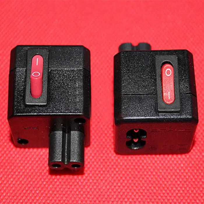

I got a power button switch for the MC3000 (someone else mentioned it here before) I bought one from this store for my MC3000:
d_t_a that power button is just perfect, going to order two of them today.

The idea about adding an extra switch to avoid the sparking is not perfect, the inrush current will probably slowly damage the switch (The plugs will probably never be damage serious from sparking). There is no absolute in the previous sentence because everything depends on the actual quality/design of the items.
