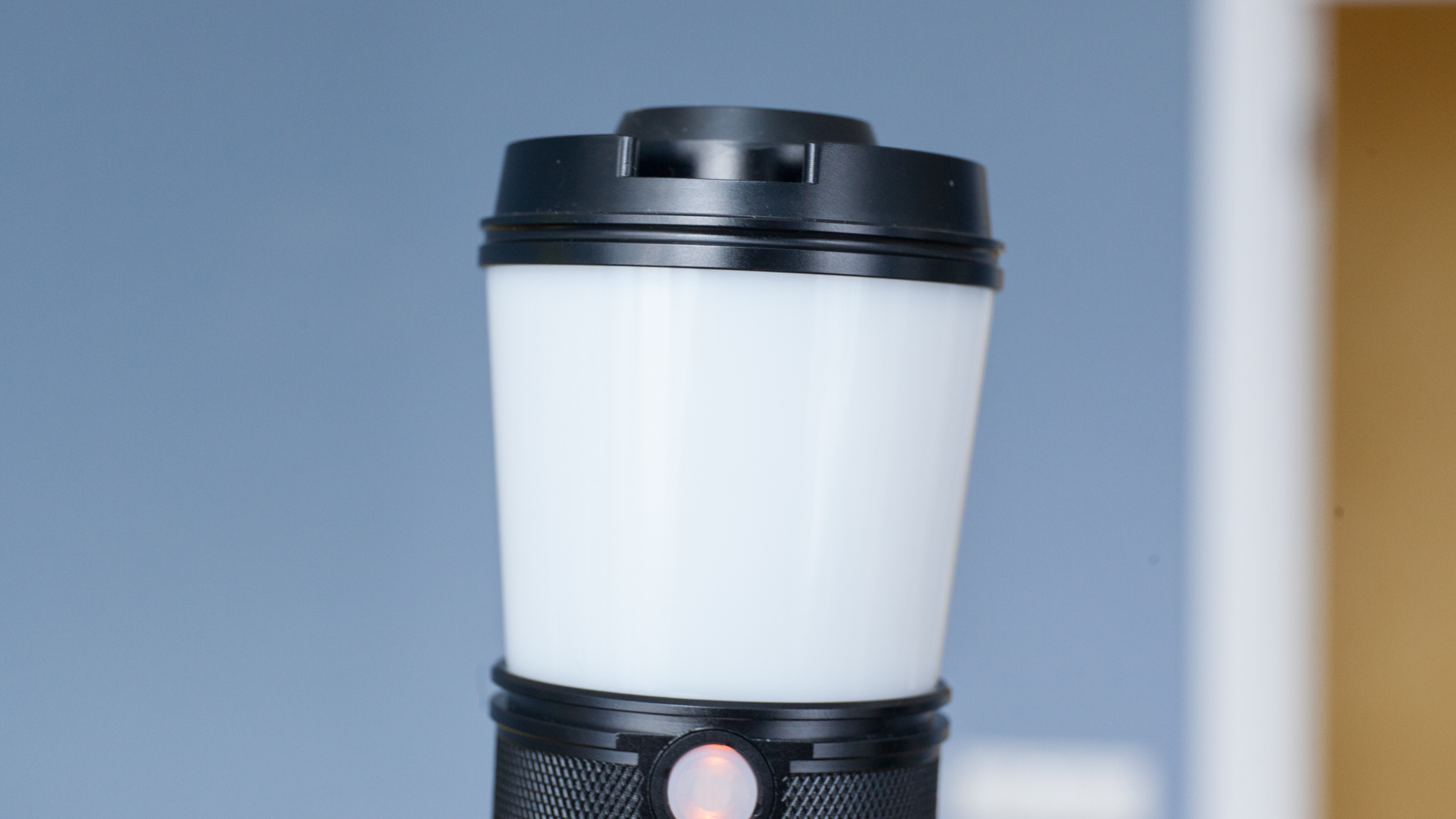

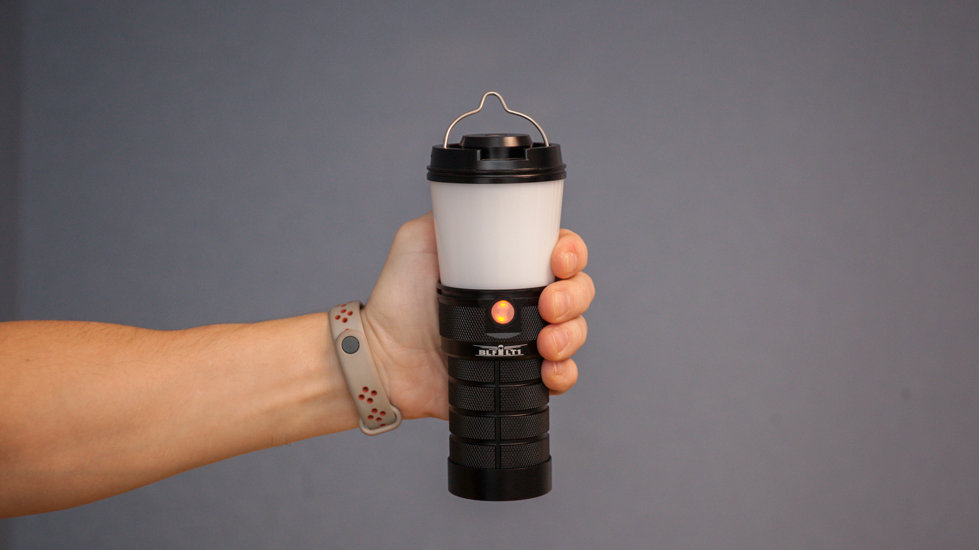

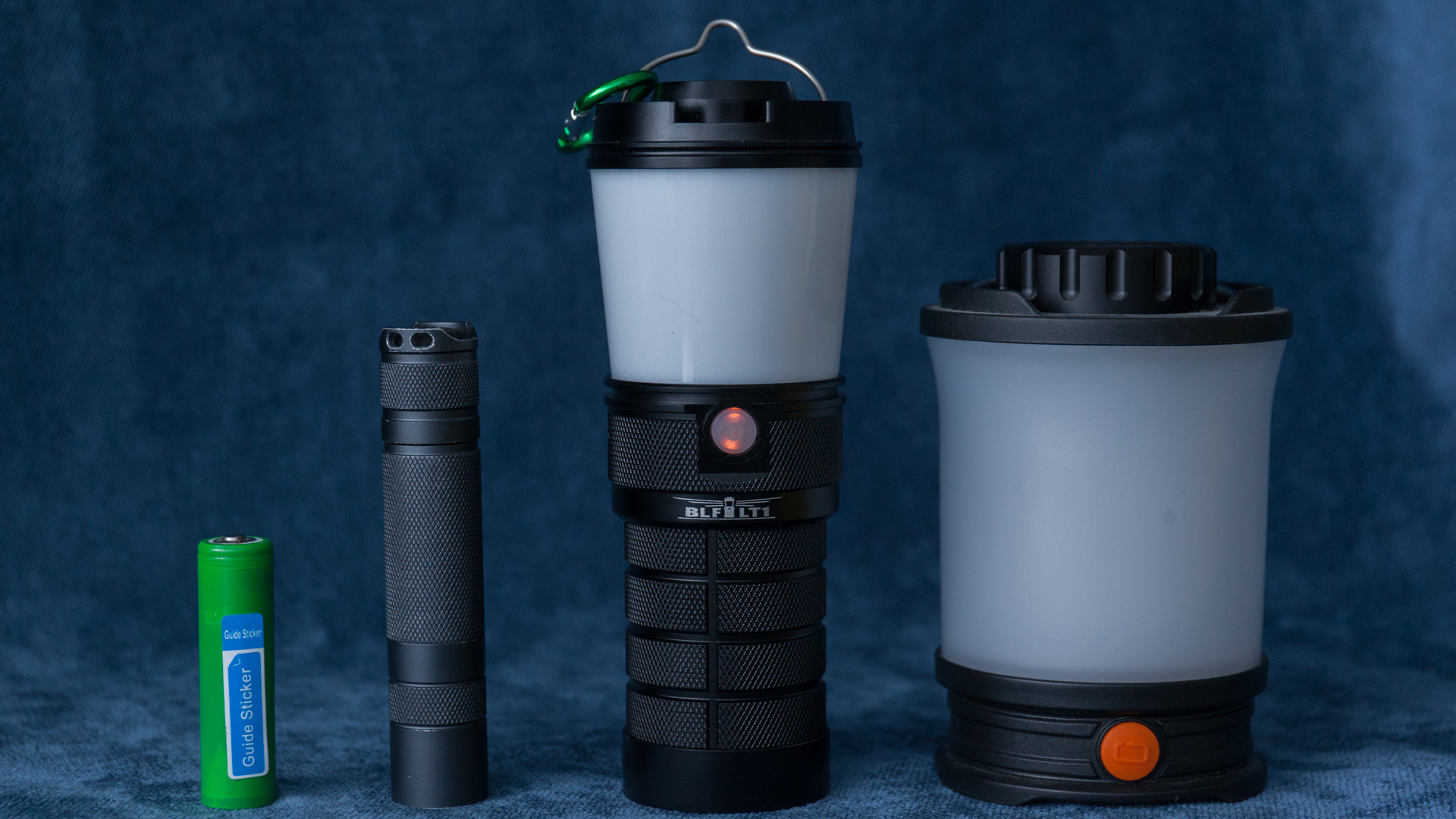

Externally, LT1 is a Sofirn BLFQ8 with an installed conical plastic diffuser upon it, and a metal cover crowning it. Diffuser is 3mm thick. No backlashes and gaps, everything is assembled tight. You have to glue orange bumper o-ring, or you`ll loose it sooner or later.
I’m not ready to say that Sofirn LT1 is an example of great design. In this regard, Fenix CL30R looks much better. Here you can compare the sizes. Due to the different design Sofirn is significantly higher (176 vs 136 mm), CL30R is much wider (68 vs 93mm), with almost the same unloaded weight (405 vs 411g). In general, both of them are far from being small camp lights. I definitely dont think that both them will suit for hiking with its struggle for each gram in backpack.
But! I think that the design here is secondary, the main thing is ease of use, and here LT1, as a product developed by people , is head ahead of a fair amount of brand models.

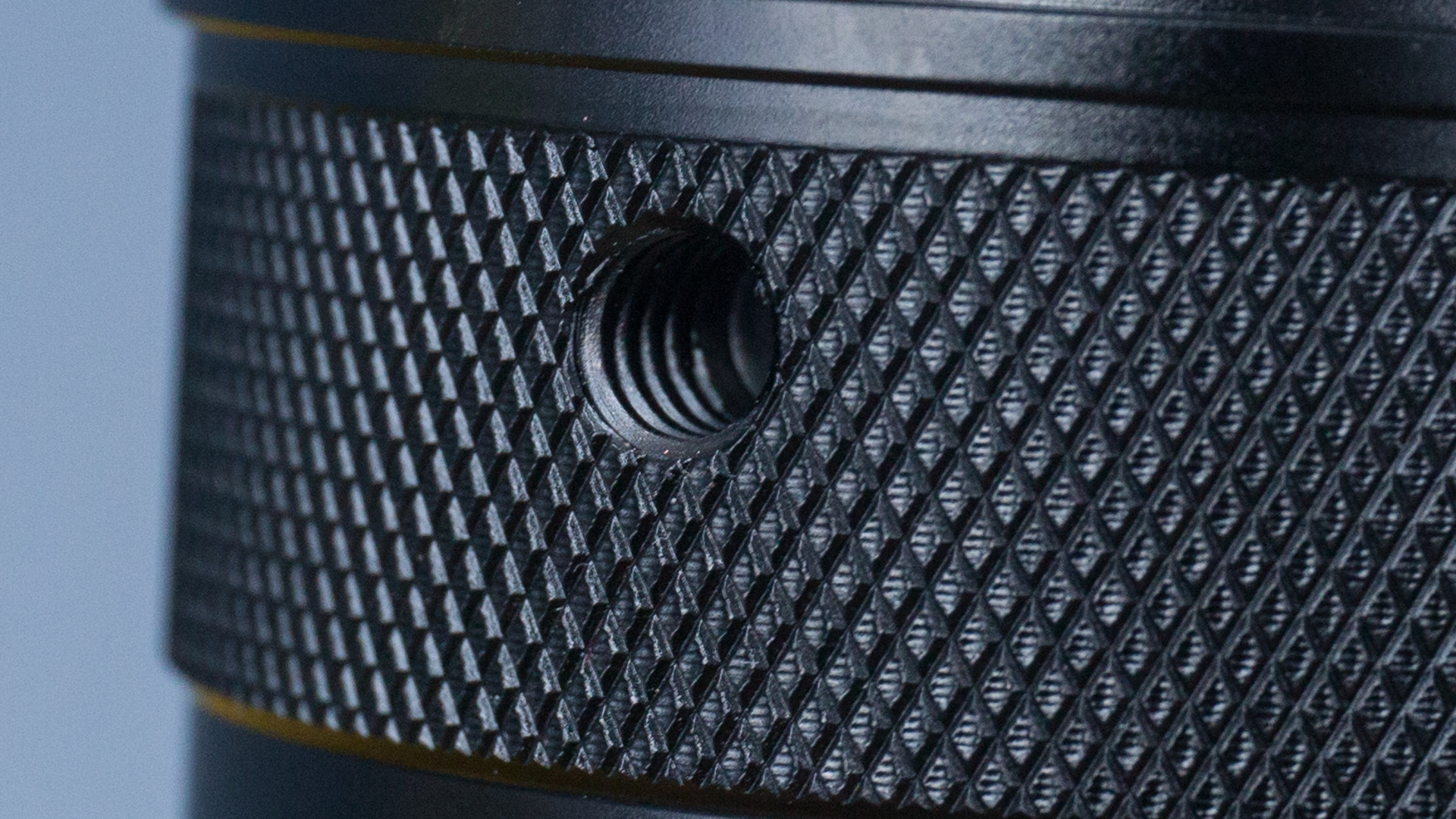

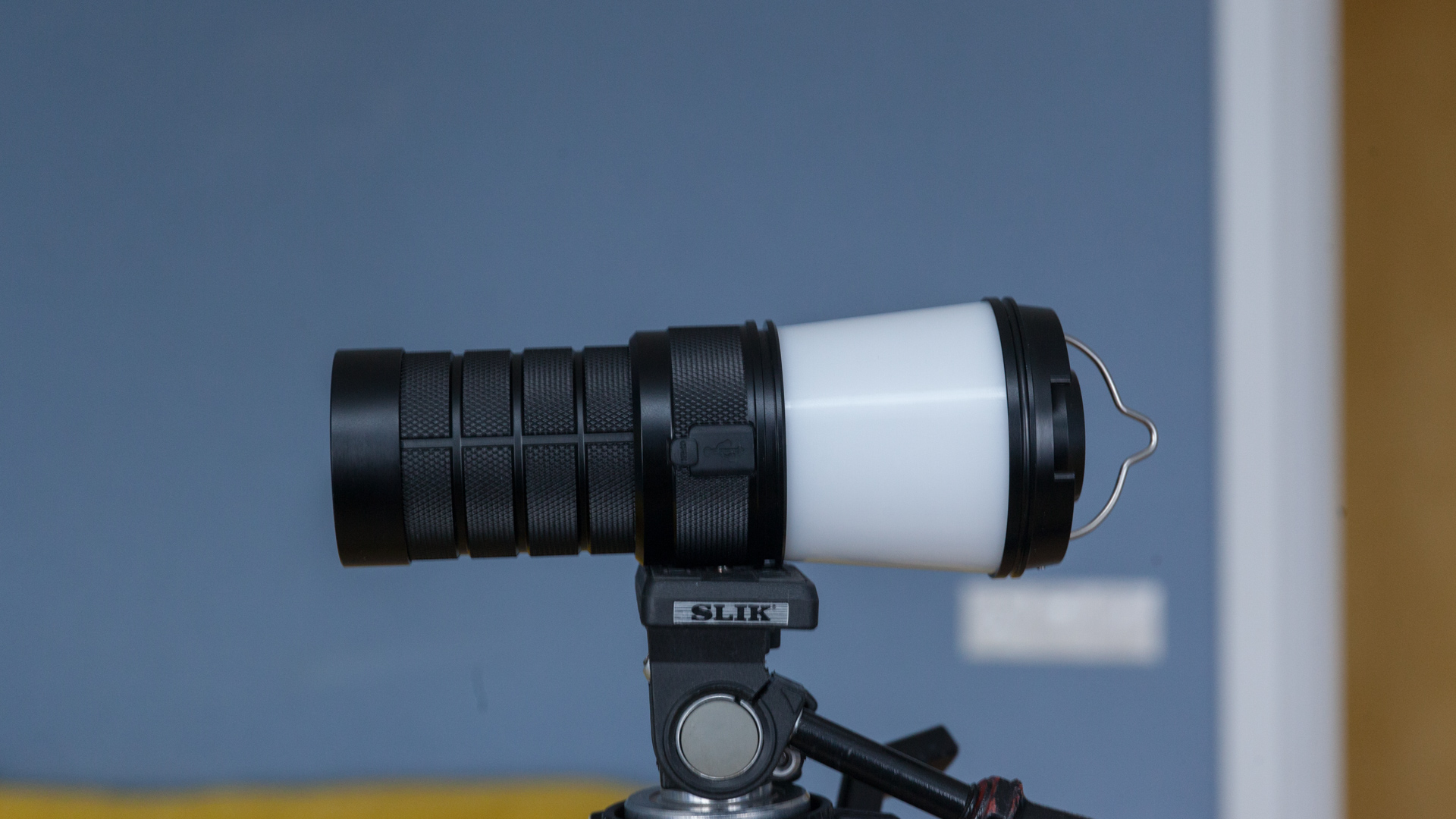

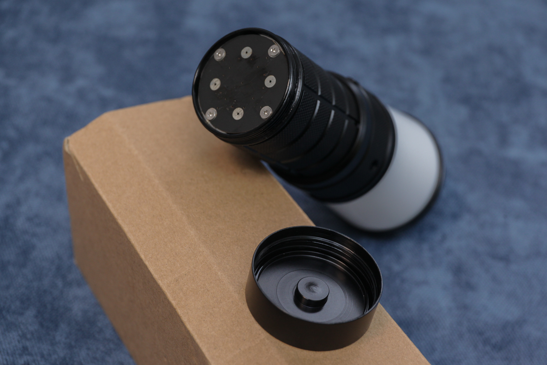

LT1, as you can see in the photos, has 2 (!) tripod mounts at bottom and side.
To be honest, I cant imagine situation when you`ll need side mount. If you have thoughts about this - write. In any case, it’s good to have it.
LT1 have quite stable tailstand, though worse than of CL30R with it`s lower center of masses.
Tail-cap can be twisted off to expose nothing (people often put cheatsheet for Anduril UI here)
2nd way to place LT1 is to simply hang it.

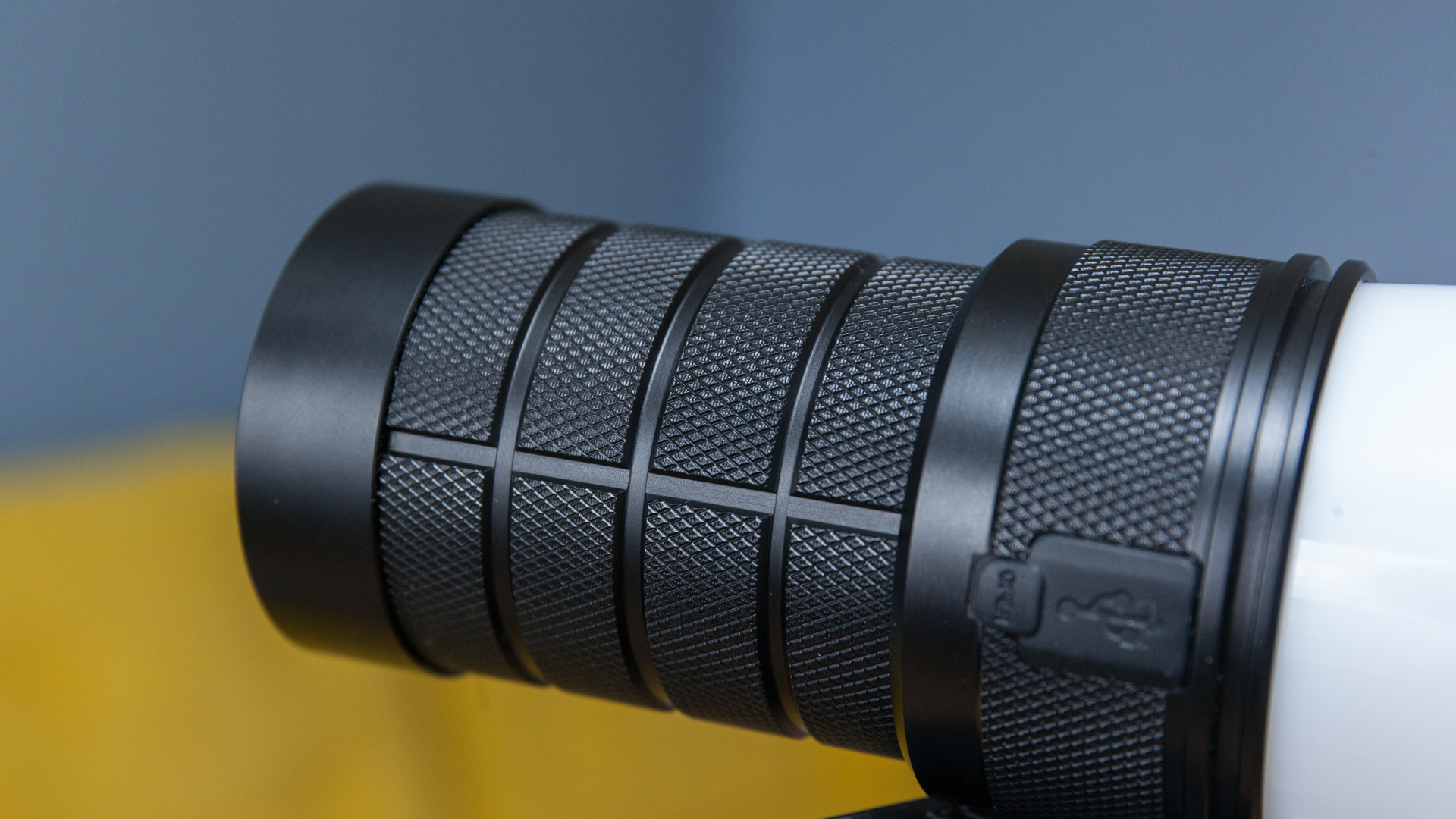

Knurling is quite large and tenacious, although this characteristic is definitely minor for such category of lamps.
lamp can be disassembled into two parts. Base contains slots for 4 batteries (Fenix CL30R has 3). Thread seems to be well lubricated, but the head moves along it with a creak, I added some Xtar lubrication. Photo shows that one battery is lower than the others, that`s is because it is without a protection board.

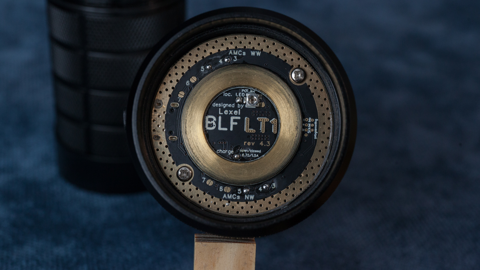

MCPB with LEDs of LT1 are placed under the metal cover and directed downward, to the base. If they were on the latter, it would be even better for heat dissipation. But LT1 handle with heat transfer even as is, so just forget it - ). That all this is clearly visible on runtime chart.

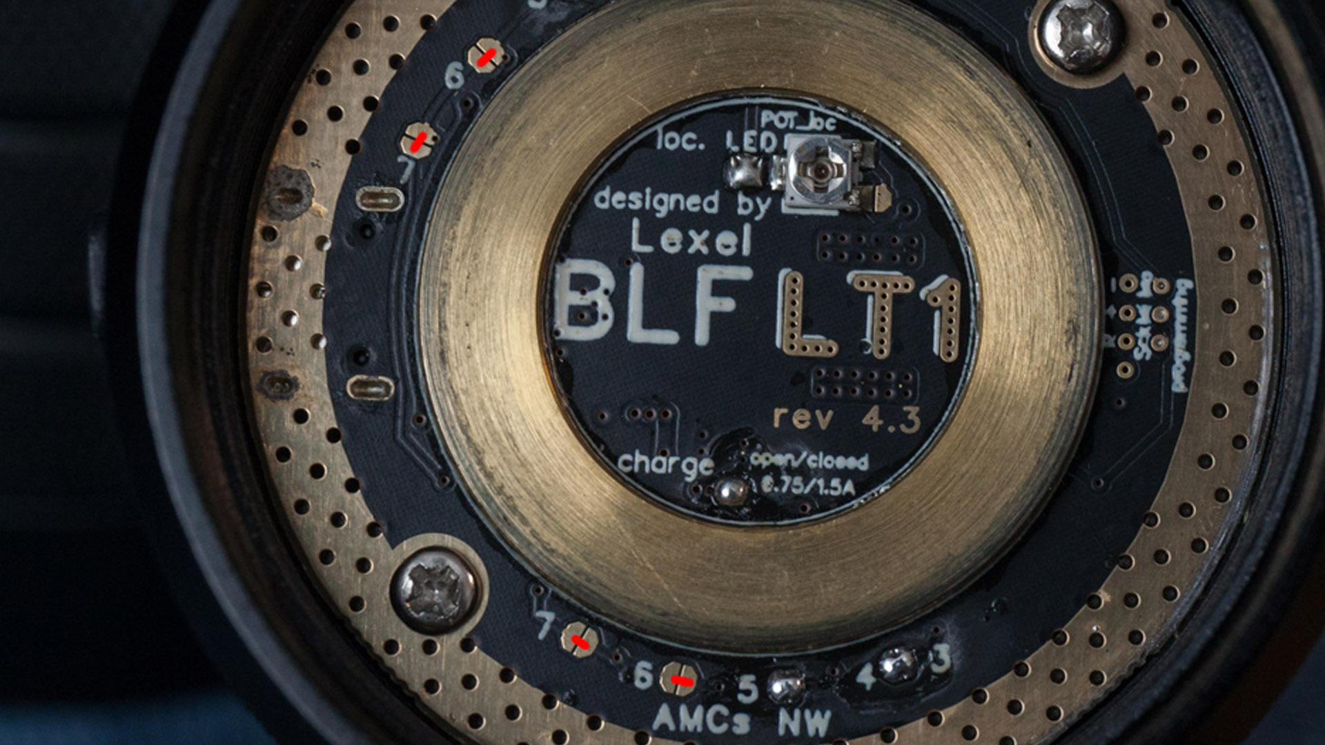

Important! If desired, you can increase brightness by connecting (by soldering or drawing a line with a pencil graphite) 6 and / or 7 bridges. I plan to test it finally and see what increase it gives and how it affects on runtime.
I unscrewed bolt that connects base and cover, but that is all I could do, as these both parts are wired.

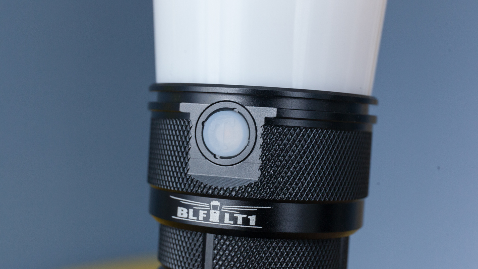

Button is soft, there is regular indication backlight. Well, a button is like a button

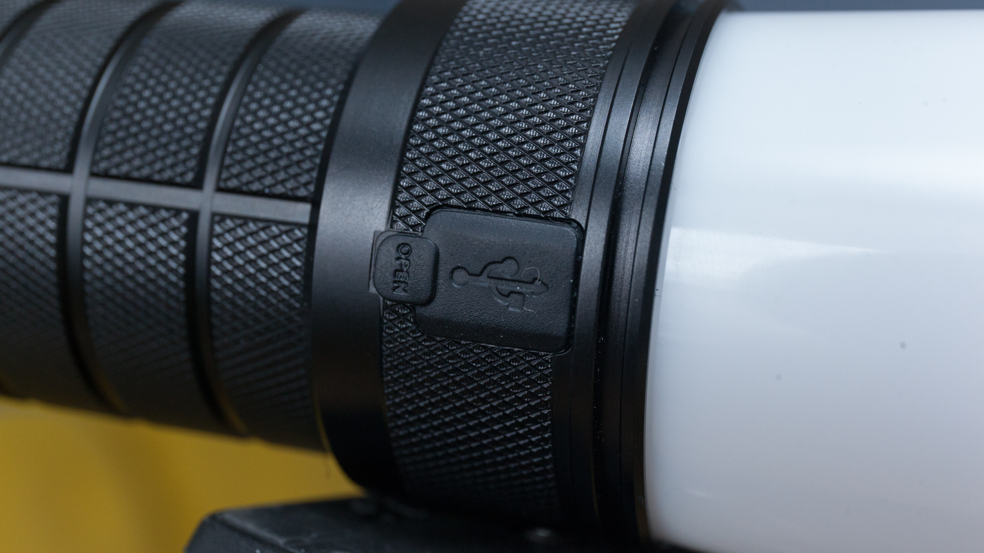

As usually, charging plug is located on the opposite side from button. Here we have Type-C, which is pretty good. Unfortunately, the maximum charging current is only 1.5A.
For 4x18650, this means that you have to charge from morning to evening. Hm, if you plan to use LT1 near or in countryhouse or have a solar battery when you are outdoor, then this will not be a problem.
Support of PD\CQ, or two-sided Type-C would definitely be more appropriate here, but DBSar mentioned that minimization of cost and maximization of compatibility were priority points. … rubber plug itself is thick and reliable.

4 x Samsung LH351 CRI 90 2700 and 4 x 5000K are responsible for the light here. 5x7135 stabilizers in driver. Toykeeper mentions that a simpler interface and a buck-boost driver would give more brightness, but, frankly, there is more than enough of it.

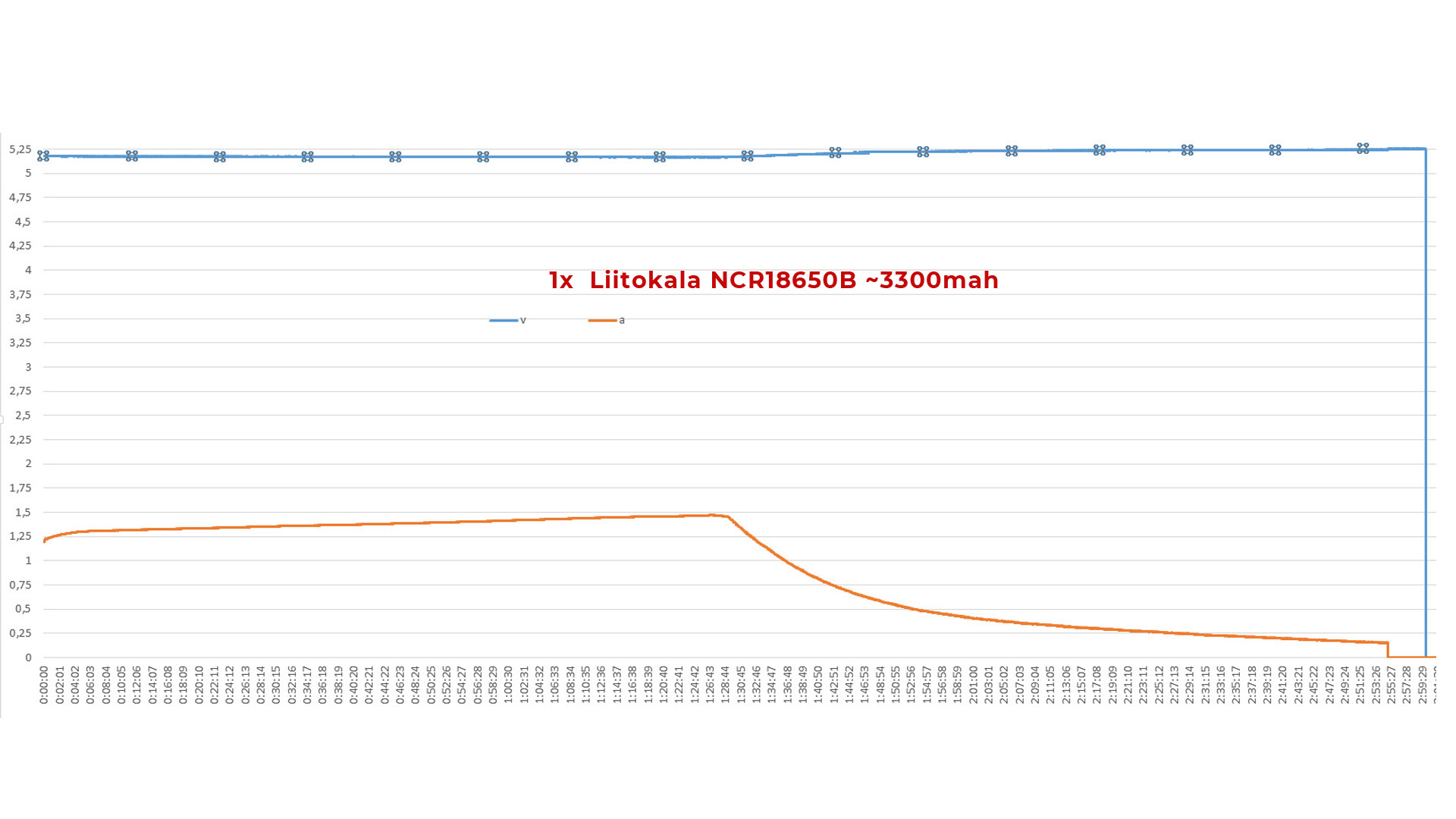

This is a huge, huge plus of this model. As for rutime, it is colossal. I remind you that LT1 runs on 1,2,3 or 4 batteries.
The second point - LT1 supports work without batteries from external power source (without 5 \ 5 mode).
But! If you connect a power bank when at least one battery is inserted, then LT1 fully works in all modes. This is extremely convenient and will dramatically increase rutime - 4 hours to 7 hours from 4x18650 Liitokalas NCR18650B. I haven`t done 50% test (but may be will) as you simple can 2x 100% runtime and get around 14hours at about 300 lumens (both numbers are astonishingly high for almost all the other camp lights)
Consumption currents from powerbanc: 1 \ 5 0.014A 2 \ 5 0.14A (whistle is heard), 3 \ 5 0.42A 4 \ 5 0.84A.

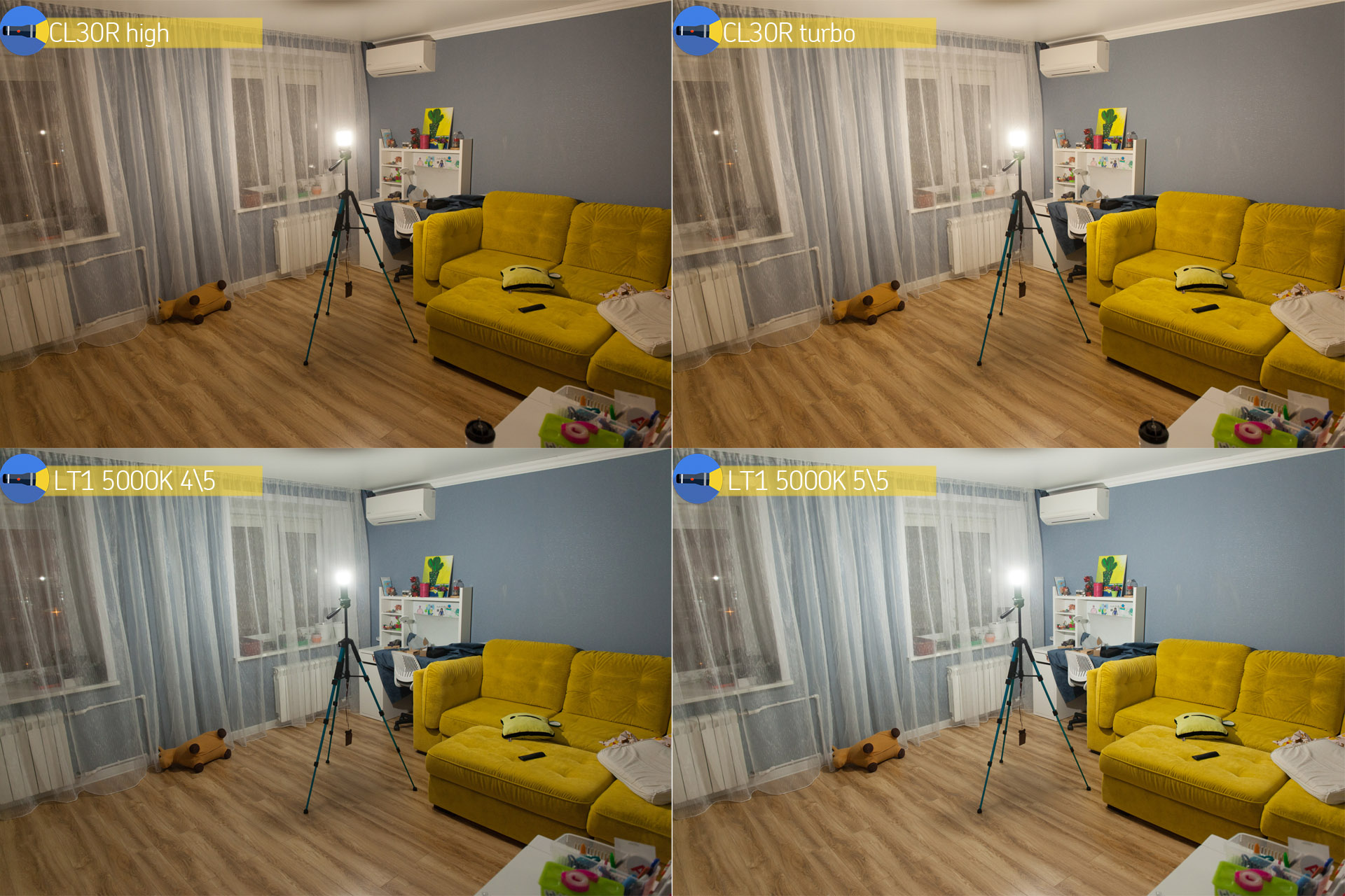

I will proceed to a comparison with Fenix Cl30R, which has declared maximum brightness of 600 lumens - both LT1 and CL30R look absolutely equal on photos, so I count LT1 has 600 lumens.
2700K somewhere 1 \ 3 less brigth, i.e. we assume that there is around 400lumen. It seems to me that such a cozy color temperature is best at low brightness and even 400 lumens here will be redundant. Personally, I felt uncomfortable at 100% in 2700K.
In general, it is clear that Sofirn BLF LT1 is actually a REALLY bright camping lamp. And if Fenix CL30R has quick stepdown from 600 lumens, then LT1 sustains it for 7 hours!
This, I repeat, is often even excessive brightness. If we switch to 50%, which is comparable to the maximum (i.e., turbo, BEFORE stepdown) the brightness of compact models with 1x18650 power, you can provide yourself with light from dusk to dawn.
There is a some dark area under lamp, but thanks to the conical shape of diffuser it is minimized. The cylindrical Fenix CL25R is way worse here

I particularly appreciated the comparative photos in different modes, different colour temperatures and with the CL30R. Excellent work :beer:

I forgot to mention the side mount (threaded hole) was put there for future accessories as in reflectors, shades, side handles, and wall hanger mounts.
