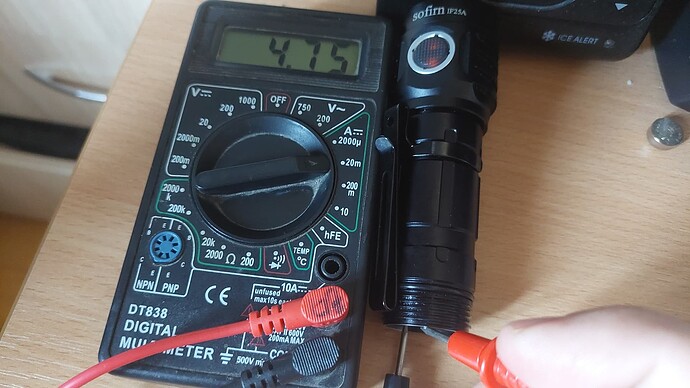

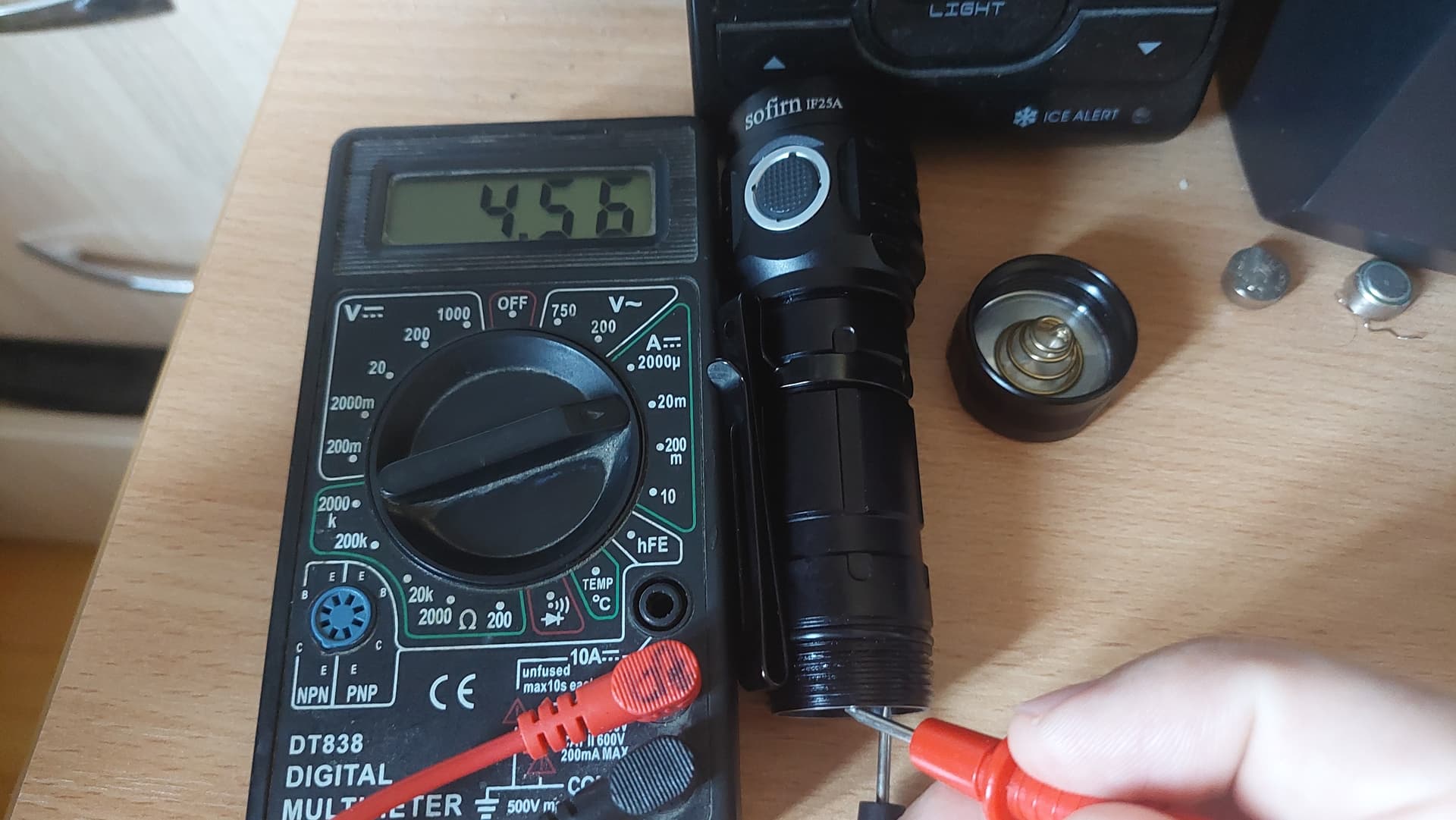

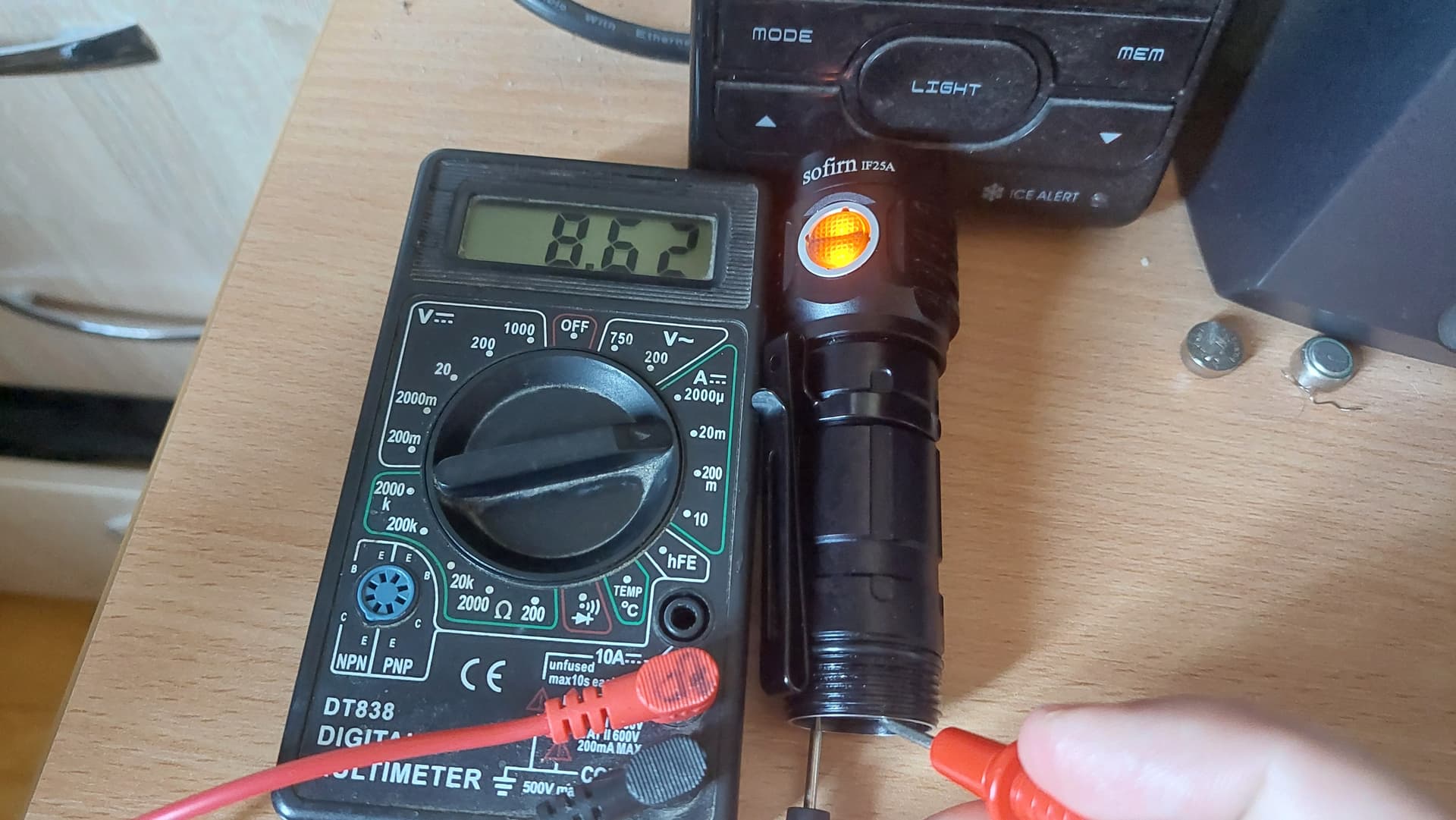

Hello, my name is Slava and I’m from Kharkov, Ukraine. I’ve encountered a problem. One of my two IF25A 4000k flashlights (I bought it used) drains its battery very quickly in standby mode. About a month. It has a new Sofirn 5000mAh battery, and its capacity is even higher than stated. I checked the firmware versions of my two IF25A flashlights, they are the same - 0614. I reset both flashlights to factory settings. And I measured the readings of both flashlights in idle mode with a multimeter: 1) With the light off in the button 2) With the minimum light in the button 3) With the maximum light in the button. The results are as follows. On a working IF25A flashlight: 6500k: 0.01mA, 0.26mA, 4.04mA. The faulty IF25A has 4000kA, 4.55mA, 4.78mA, and 8.66mA.

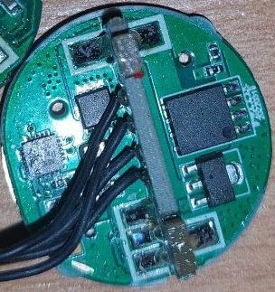

Below are photos of my measurements and a photo of the IF25A driver found online.

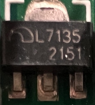

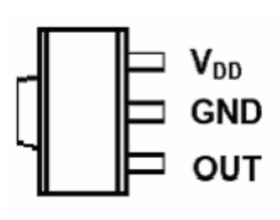

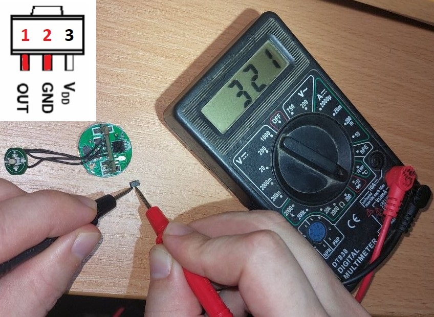

I removed the driver today and didn’t see any burn marks. I read on a forum about testing a 7135 chip: "That leak could be that the internal FET failed short-circuit in the drain-source path => always “on”.
Measure the resistance from pin 1 to pin 2 to verify; normally it should be open circuit (no continuity), but failure may read a few dozen ohms to 1 ohm or less."
I didn’t desolder the chip, but I think I measured 282 ohms with a multimeter. I measured the resistance on the left and middle pins. As far as I can tell, the left pin is output, and the middle pin is ground. So, is my chip faulty? I’ll email a specialist tomorrow who was recommended to me and try to resolve the issue with him. I’ve read that these chips are often defective. They are also prone to failure if overheated during soldering. I don’t have a hair dryer or a soldering iron with a thin tip. And the only measuring instrument I have is a multimeter. If I can resolve this issue with the repairman, I’ll definitely let you know.

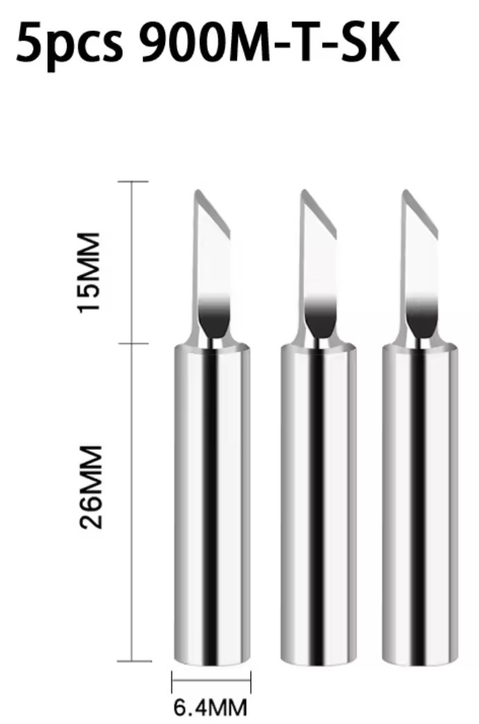

I use a SK Tip to remove these style chips:
If you’re measuring the resistance between output and ground whilst in-circuit, you’re measuring the resistance of the LED and any current limiting resistors or any other components in that side of the circuit so it’s probably not really a measurement that’s entirely useful.

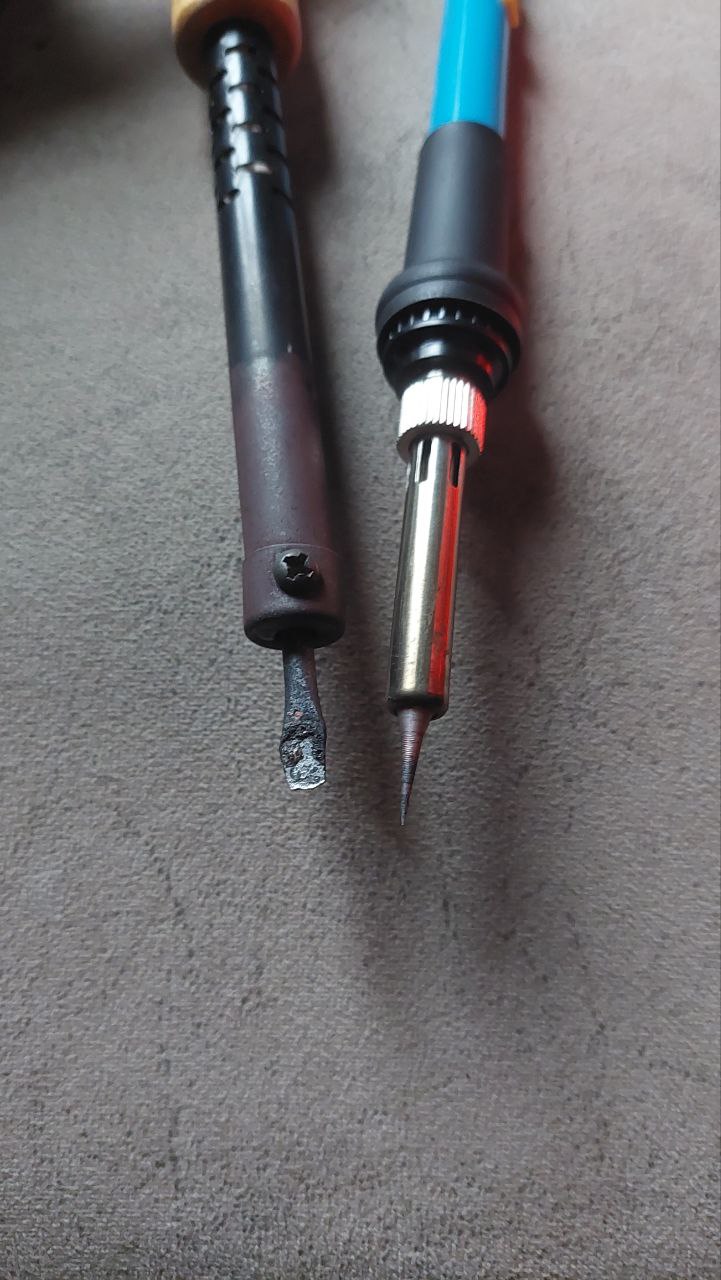

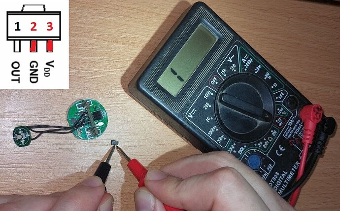

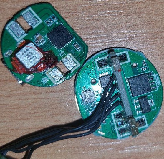

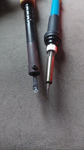

I remembered my wife has a soldering iron with a thin tip; she uses it for working with fabric. Experience has shown that my old soldering iron with a wide tip desolders the chip better, precisely because the wide tip fits all three contacts on the chip.But perhaps a soldering iron with a thin tip would be more convenient when I solder the microcircuit. I measured the resistance of the desoldered chip. Between pins 1 and 2, it was 321 ohms. Between pins 2 and 3, there was no reading. Between pins 1 and 3, there was no reading either. So, to summarize, is my chip faulty? Should I order a new one?
Removed 7135? OK, now measure off mode power consumption . Or maybe charging circuit consumes ? Usually when 7135 leaking you get constant moonlight in off mode.

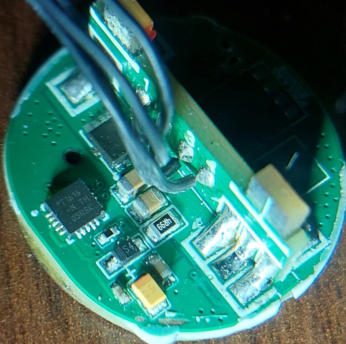

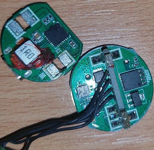

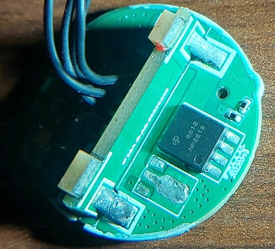

No, the moonlight wasn’t on. That means the chip was working. I measured the bottom of the board with the chip unsoldered, the consumption is 4.4 mA. In the photo, the chip is not yet unsoldered.

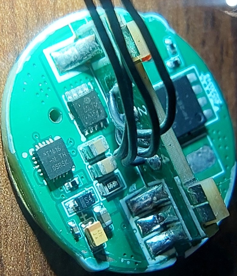

Here’s another photo
Disconnect charging board, if no, check caps… a lot of fun.. :slightly_smiling_face: Or maybe some Convoy driver will fit in?

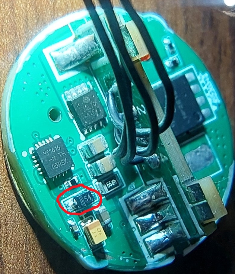

I actually measured it without the top part of the board, where the USB port is. Could the SMD S4 diode cause this kind of leakage?
I don’t think so, that should just be for Reverse Polarity Protection for the MCU(T1616)
