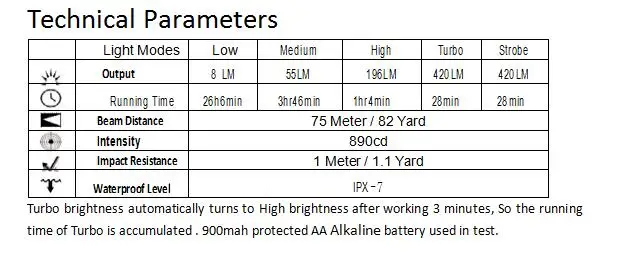

Can anyone confirm the manufacturer’s runtimes ? They just don’t seem right.
Do they really mean a “900mAh Alkaline AA”? Not 1900 (which would be expected out of a typical Alkaline)? Either they _did _test with 900mAh cells and runtime with normal cells or Eneloops should be twice as long (probably not on Turbo), or they really meant 1900mAh and the driver is horribly inefficient - something I don’t expect with a 2xAA light.
I’d really like to know, because that would mess up an otherwise pretty nice light.
