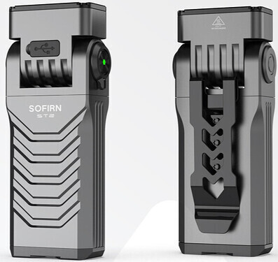

Long-lasting, easy-to-pack, electric-shaver-shaped work light with a tilting head.

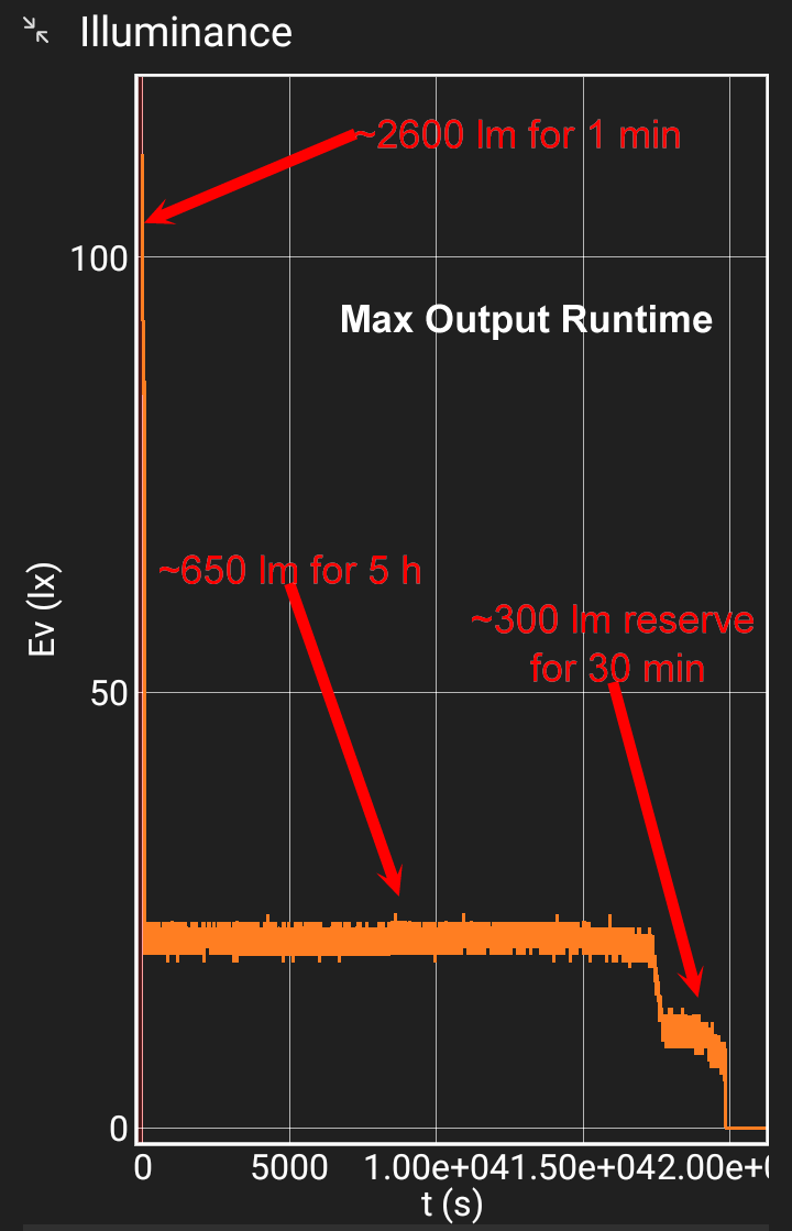

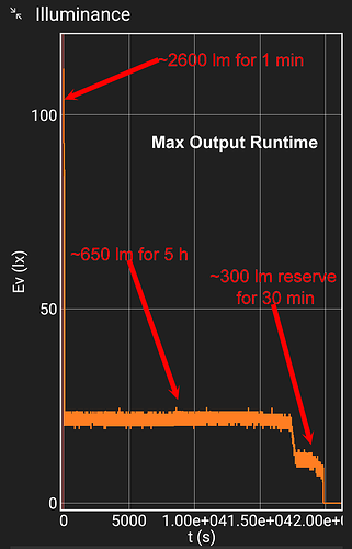

  • SFT42R/6500K in smooth reflector: ~2600 lm / ~300 ANSI m max for 1 min (~650 lm sustained for 5 h) + red/UV.

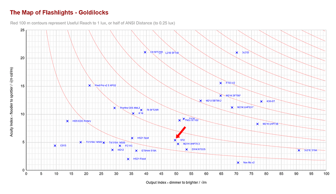

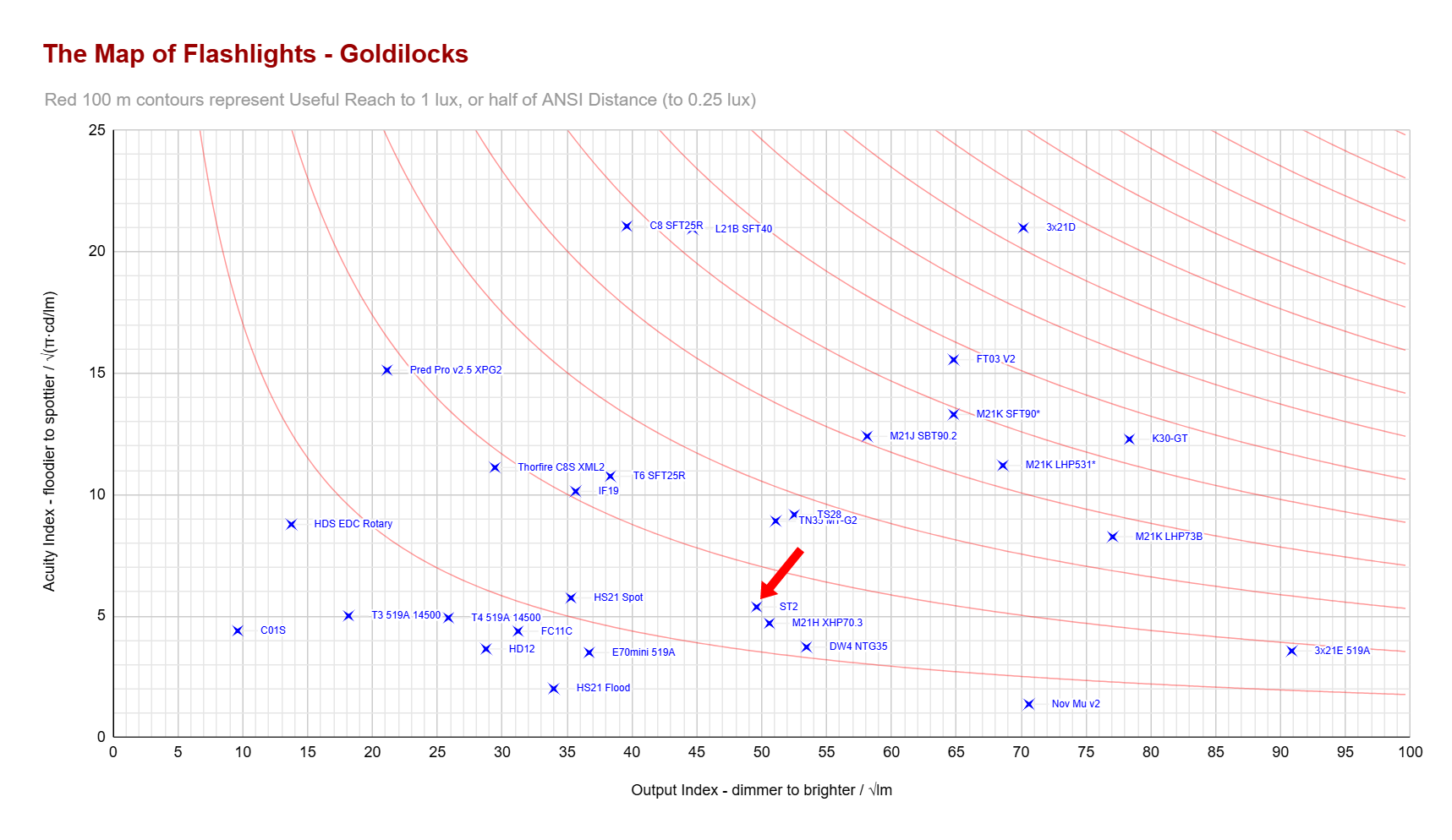

  • Beam Acuity Index of ~5. The light should provide similar illumination to the M21H with XHP70.3 and a little wider beam but similar reach to the HS21 Spot (Map of Flashlights).
  • 2*18650 replaceable batteries, USB-C charging, a button with smooth-ramping UI and a dial to select the LED (white, red, UV).
