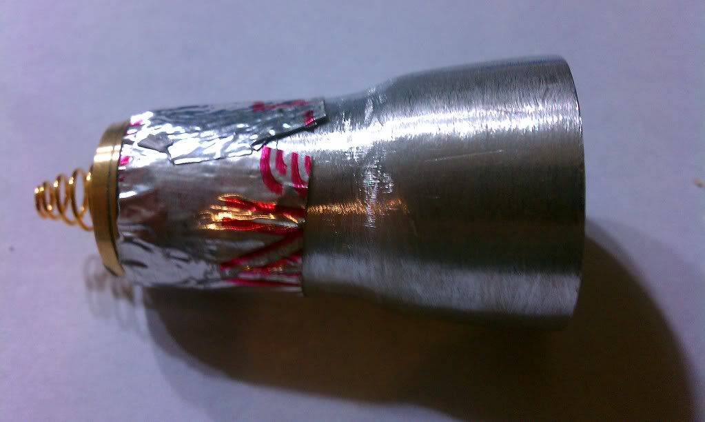

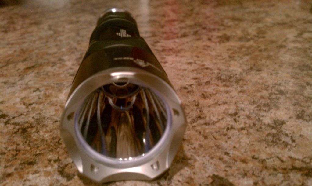

Little project I have been working on for months,not having alot of time.I have been looking for a nice little pocket thrower and realized the p60 format cannot produce the throw I wanted.I used a larger z32 surefire head because of the size and the hard part was finding the reflector for it.I cannibalized lights for the reflectors and took the dremel to it and got a nice fit.Pill is from the manafont ultrafire dropin because of it's power and then an A.R. coated lens and a nice aggressive bezel with custom GITD o-ring and BAM!Just what I was looking for.I got a nice white wall shot to show hotspot intensity from about 3 feet away but my dang phone camera just couldn't get a distance shot to save my life.Enjoy!

nice work also, how much longer is the reflector?

Which light did the reflector come out of?
thanks guys,the reflector is from an older ultrafire c308 and is ground down to 31.1mmx42.5mm deep.It sits far down in the "throat"of the light.The blue glow ring I made myself with tubing and glow powder,takes a lot of mistakes before I got it looking right.Z32 bezel was gutted but can be returned to original shape as I didn't grind down the bezel itself.
