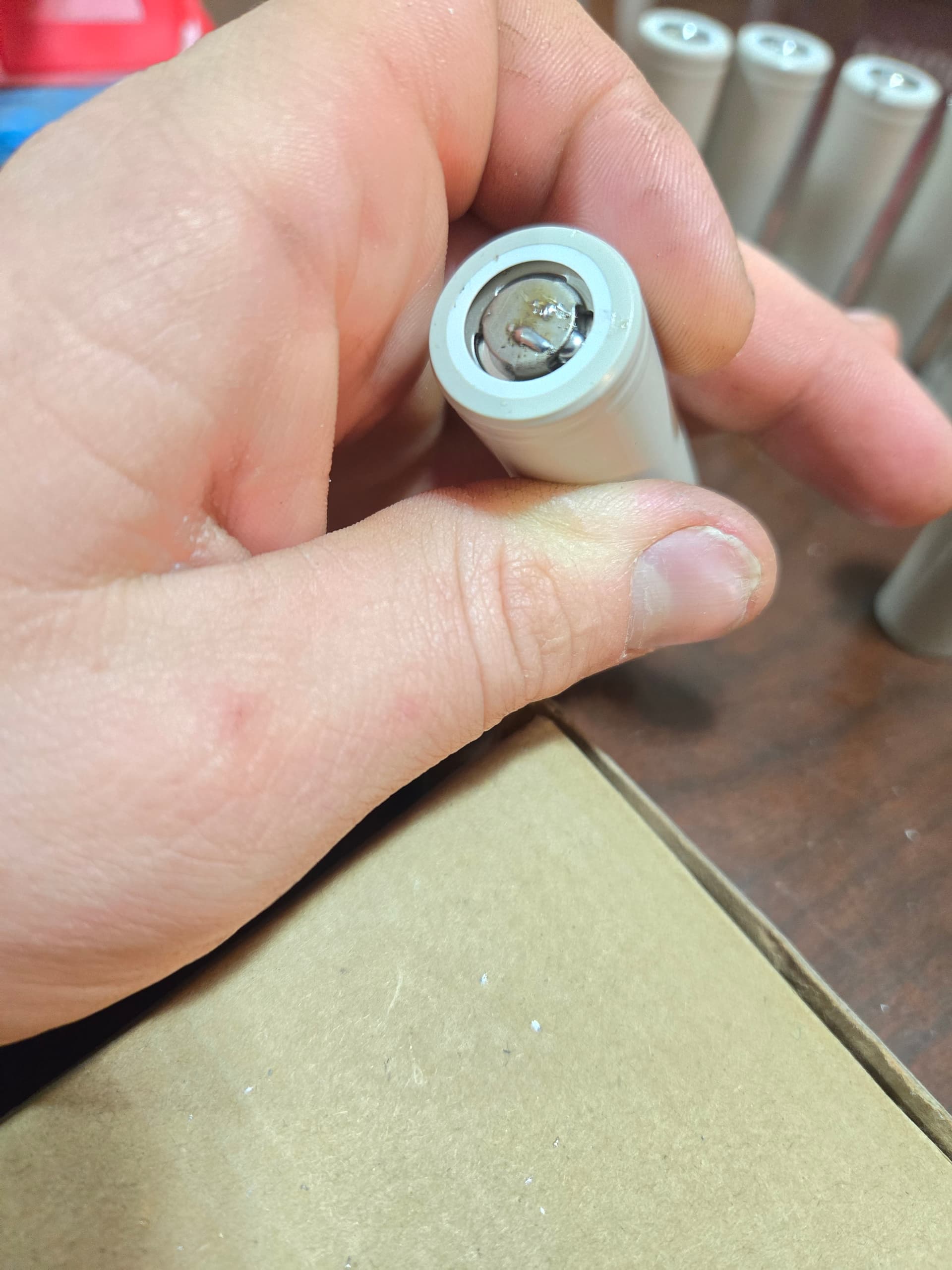

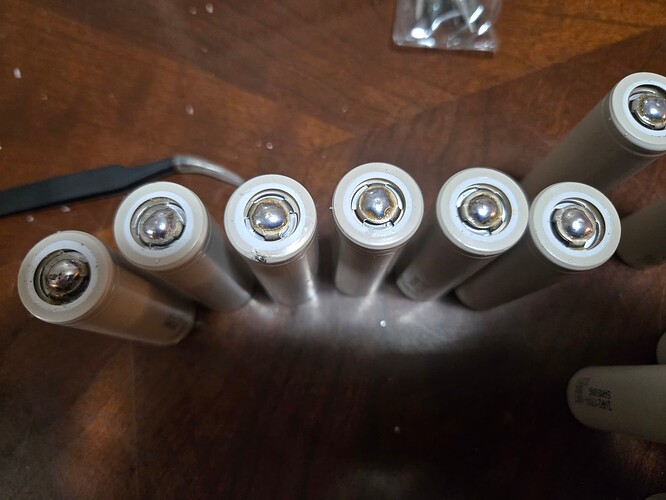

So I got a Milwaukee MX Fuel battery which is a big 80ish volt battery that was bad from work. Tore it a part and found like 2 bad 21700 cells out of a total 40 cells. Putting blobs of solder on positive terminals to use them as button top cells. Am I dumb for doing this?
Also, some solder fell into some of the batteries and I am scared to mess with the ones that had this happen. Is the rim of the battery under the insulation negative? Ive had some throw sparks and scare me when messing with them so just dont wanna blow stuff up if I can help it!:roll_eyes:

I don’t want to gatekeep, but at the very minimum, if you’re harvesting cells you should at least know the general construction of these. The outer “shell” is the negative electrode, so yes, you are at high risk of causing a short.
This shows me you don’t know what you’re doing or are careless, either way, this is extremely bad. Not trying to be rude, just helping you not burn your house down.

As far as soldering button tops, I did plenty of them. Just make sure no slag gets in the vent holes.( It’s easier to solder a small washer than make a big blob ) Now days I spot weld button tops the right way.

Nonsense, I’ve done that to more than a dozen of my 18650, 18350, and 14500 batteries without any problems, and they work like new. A drop of solder on the positive terminal, sanding or filing the dome of the solder drop to create a flat surface for better contact, and that’s it.
