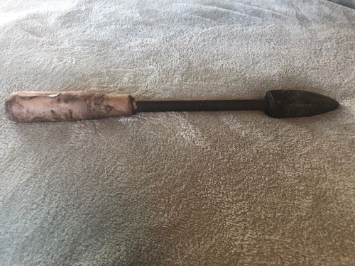

Remember the old-timey soldering irons you’d actually heat in a fire or a bed of coals? You want a slightly smaller version of that. :laughing:
