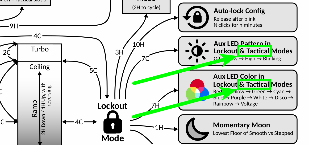

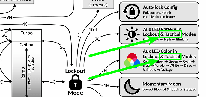

fwiw, although currently not documented in the manual, this is documented in the diagrams by containerfan and myself:
Very helpful to see the charts have it listed
thank you for pointing that out
