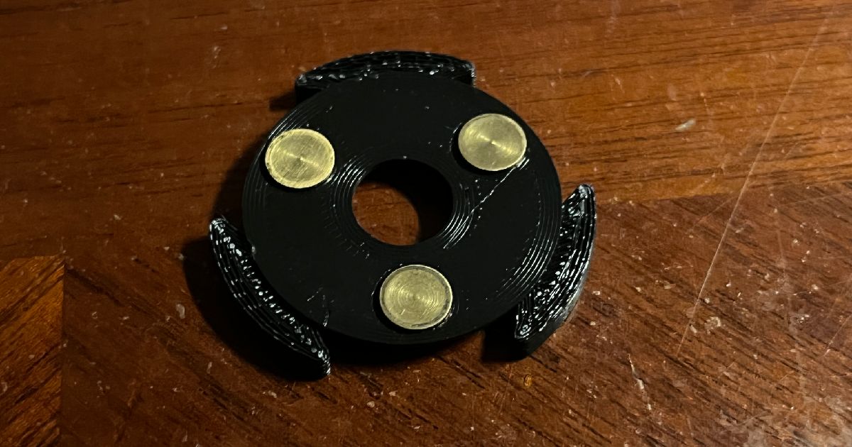

Not a big brain sofirn engineer, but I did a flattop adapter for the SP36 pro specifically that uses nuts:

@jba, what does this flat top do? Like what is its purpose?
Im not criticizing. Just curious.

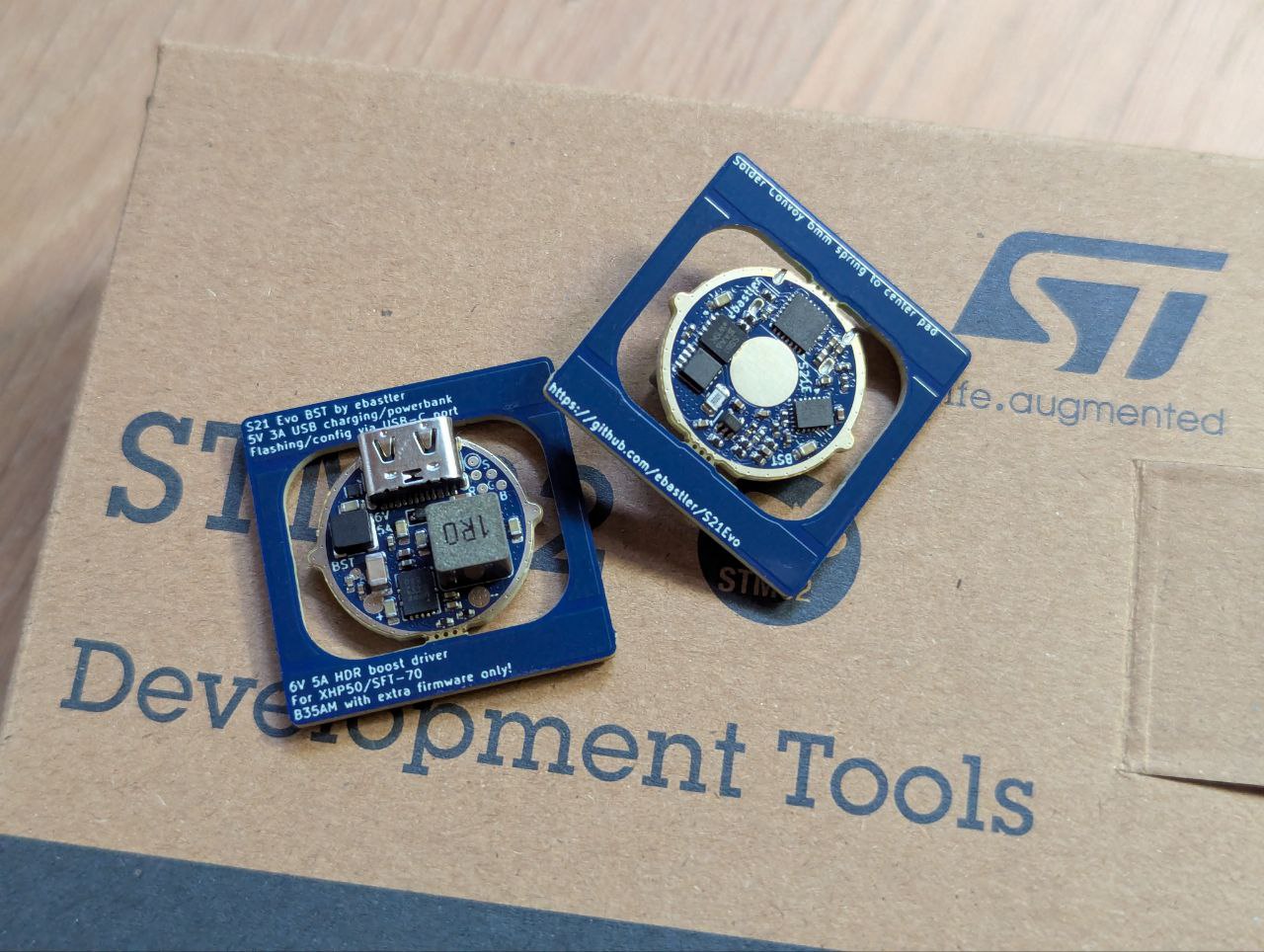

For starters, I developed a drop-in replacement 30W HDR boost driver with 15W bidirectional powerbank functionality and RGB Aux for a Convoy S21E for fun - I am not aware of any driver with a similar featureset and density in the Sofirn lineup. SP33S driver would be closest, but it is larger, has no HDR and lacks another couple features my driver could do if I finally found the time and motivation to write the software for it :grin: Again, Sofirn did not add features their customers don’t care about to optimize cost. Mine is aimed at the enthusiast crowd that willingly pays extra for obscure features. And I do not expect to make a profit off this project. So far I am a couple hundred in the negative - and that is ok. It’s a hobby for me.

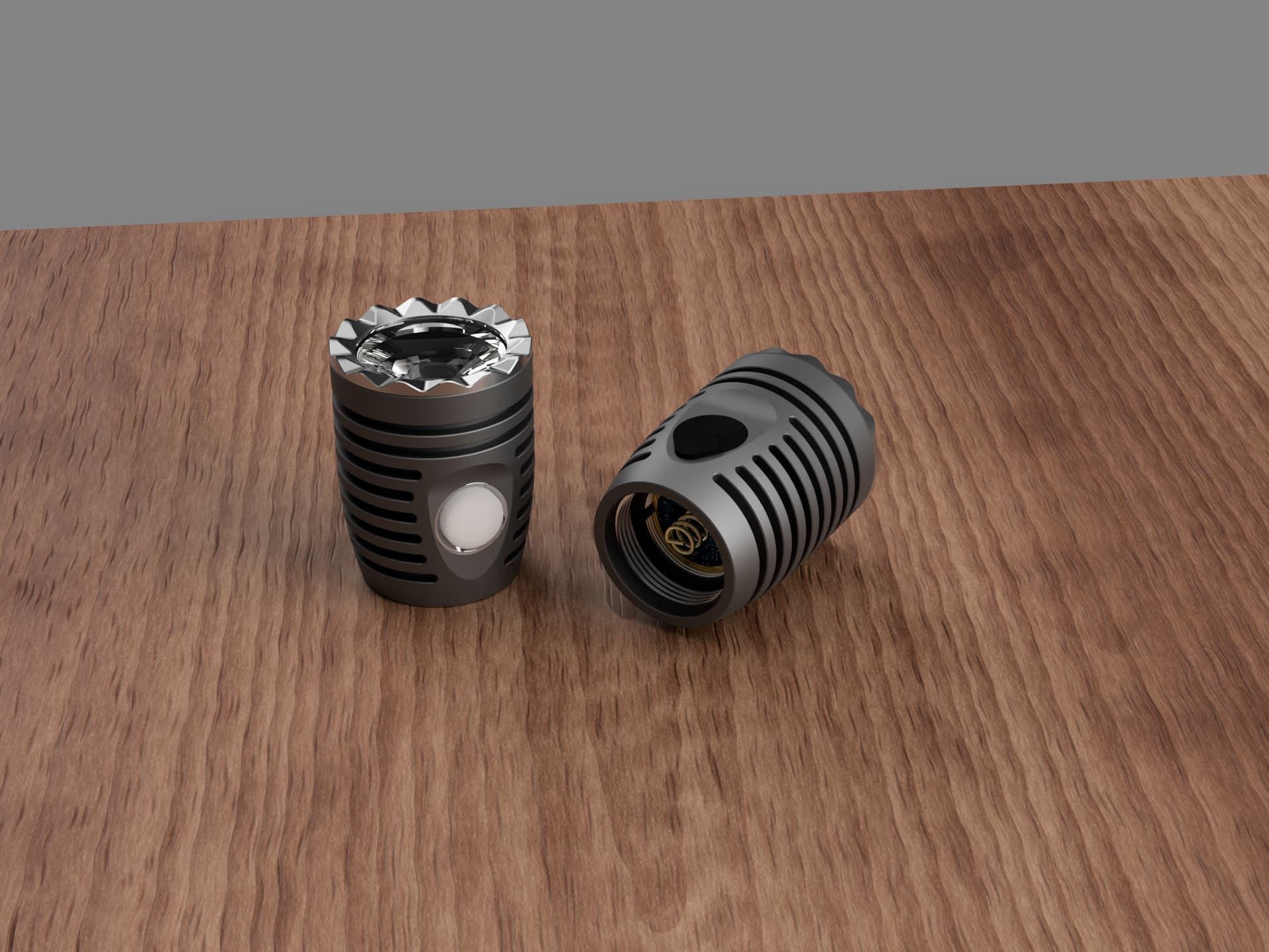

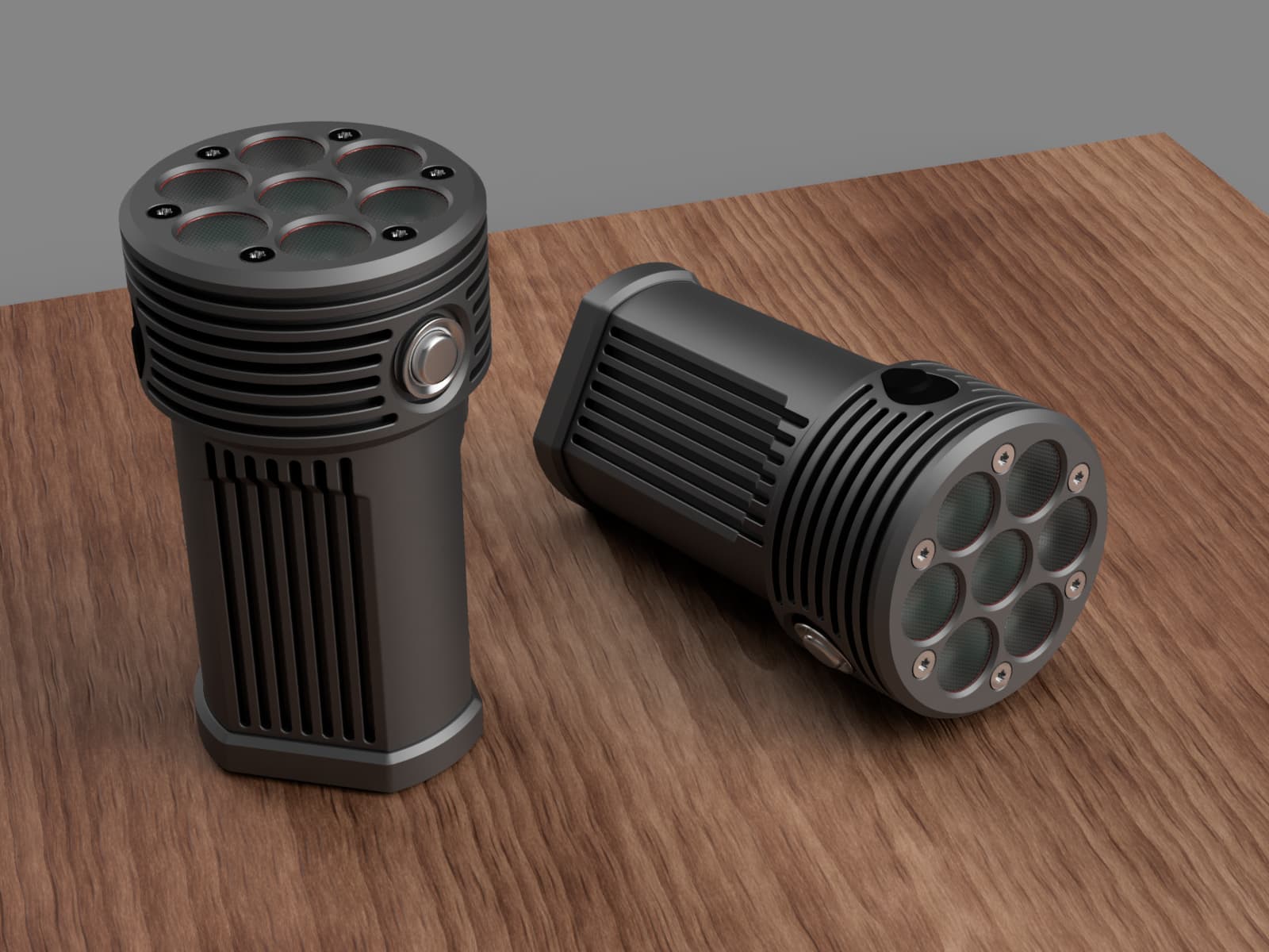

I also have a couple of half-done CAD drawings around, but I am no mechanical engineer, so my confidence in my CAD skills is not quite as large ^^ (and prototyping/ordering small amounts of CNC parts costs a fortune, so these will most likely stay mere digital drawings).
One is a compact 30mm TIR lens single 7070 allrounder, the other a big 3x 21700 sodacan with a pretty particular design aimed around the idea of psuhing a lot of R9080 lumen out of B35AM LEDs with small TIR lenses per LED which I mainly did as a CAD excercise. Neither is in the same flashlight category as a SP36, so can’t really compare. The chonker with XHP50.3 instead of B35AM might be somewhat comparable, but with a les bright but much more efficient boost driver, it still has a different design goal. Unless I win the lottery and randomly have a bunch machined, we’ll never know how it compares ^^
You get more options, some high power cells are only available as flat tops. I’m running mine with more powerful cells and a stronger driver than standard, but I’m a degenerate.
so your driver is done?:eyes:
