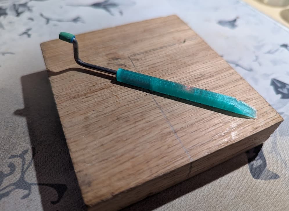

Edit: I 3d printed a little handle for my pokey tool, and gave the tip of it a thick elastic cap so that I could push with more force and comfort of mind.

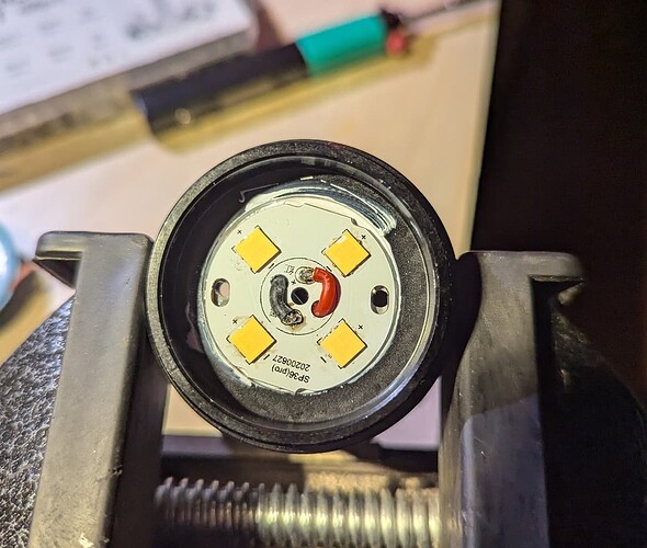

Still no luck. Hopefully the de-bonder will do the trick - Will def keep the thread updated. Massive PITA to get this driver loose (in my case)
If you destroy the driver, the one of the convoy 3x21c (25a buck + 54A fet) fits with just very little modifications and works like a charm if you put lhp531 in - brighter than a stock q8+!
Just updating - a user on r/flashlights suggest that I try freezing the light’s head to try and weaken the glue - that did the trick! I damaged one of the emitters doing the swap being sloppy with my tweezers, but it lights up - and the tint is much improved! Thanks for the help everyone.
