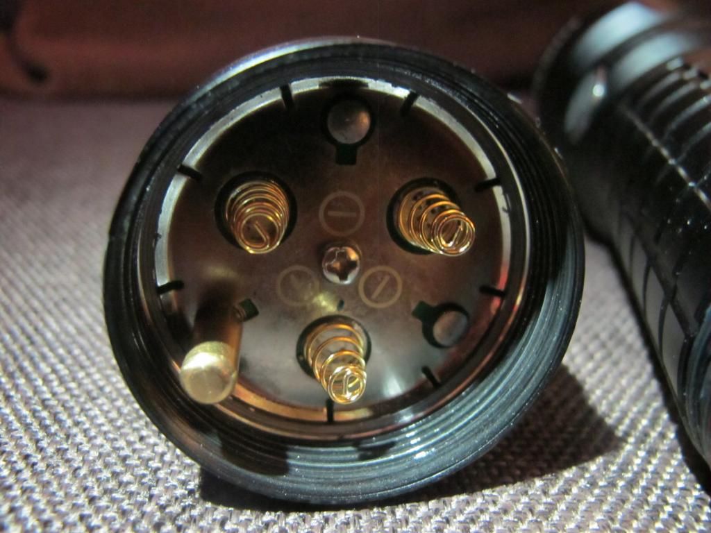

I have a brand-new SR52. I also have a problem with it. Only 1 of the 3-cell cavities takes a charge from the USB charger that comes with the unit. I have checked the electrical continuity of the tail cap’s rotating disc that contains the 3 springs (should be all be electrically-connected, right?) and only 1 of the 3 negative springs is ‘grounded’ or connected to the tail cap’s body.

I just tried it just now. With only one cell loaded in any cavity, the spring that has continuity will always align with the cell because the brass dowel stopper ( the one that keeps the 3 neg. springs always aligned to the back of the cell/s) the ‘working’ spring is on the right of the dowel, as in the previous pic, so I can’t possibly determine at the moment if all three cells will operate as 3p.
The SR52s I've seen had springs that were too short to reliably work with unprotected cells. It is a stupid design, but with longer protected cells it seems to work fine. If it were mine I would change the springs, although the tailcap isn't easy to take out either.

I'm wondering if the strings just got a bit compressed when you dropped the light. They were probably right on the edge before. You could try stretching one of the springs to see, or try it without the tailcap on and see if the battery bridged to the tube will work.
It sounds like the impact compressed the springs. Can you grab the ends with long nose pliers and stretch them back out a bit?

The tail cap’s 3 springs are supposed to be electrically connected to each other, right? Only one of the 3 has earth connection to tail cap body.
Yes, all 3 are supposed to be connected together. You've got another issue.
Mine works perfectly on this combination.
@antiparanoico
Your tail cap’s design is different from mine, which has only 1 brass post to keep it from rotating (as seen in post #1). Yours have the same design with the unit reviewed by Selfbuilt, which also had charging issues.
My tail cap is the same as the one in the photo above
If a remove the center Philips screw in the tailcap, it just keeps on rotating but does not fully disengage, perhaps designed that way. How would I approach the earth problem?
