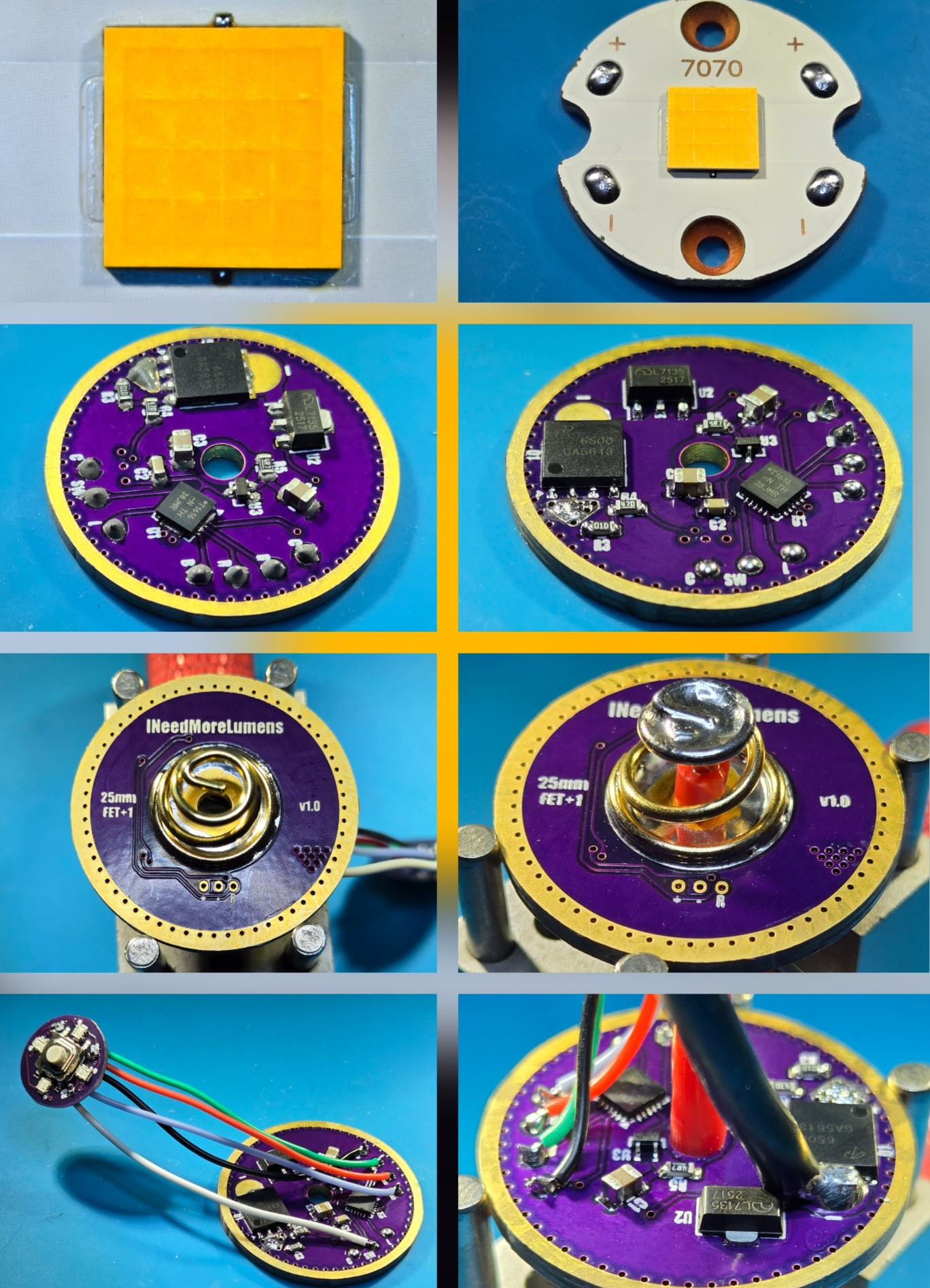

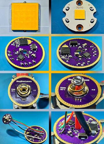

I built up an @INeedMoreLumens 25mm Fet+1 driver which he so graciously designed to work in these hosts. Flashed my favorite version of Anduril 2 successfully.
Then I flowed a Daydream 7070 4500k emitter to the included mcpcb, built the driver and RGB eSwicth pcb and tested everything out. Success!
I used 16ga wires for the emitter, which appear to be about the max that will comfortably fit the pcb.
I really didn’t “need” to use 16ga for this build, but wanted to give it a shot.

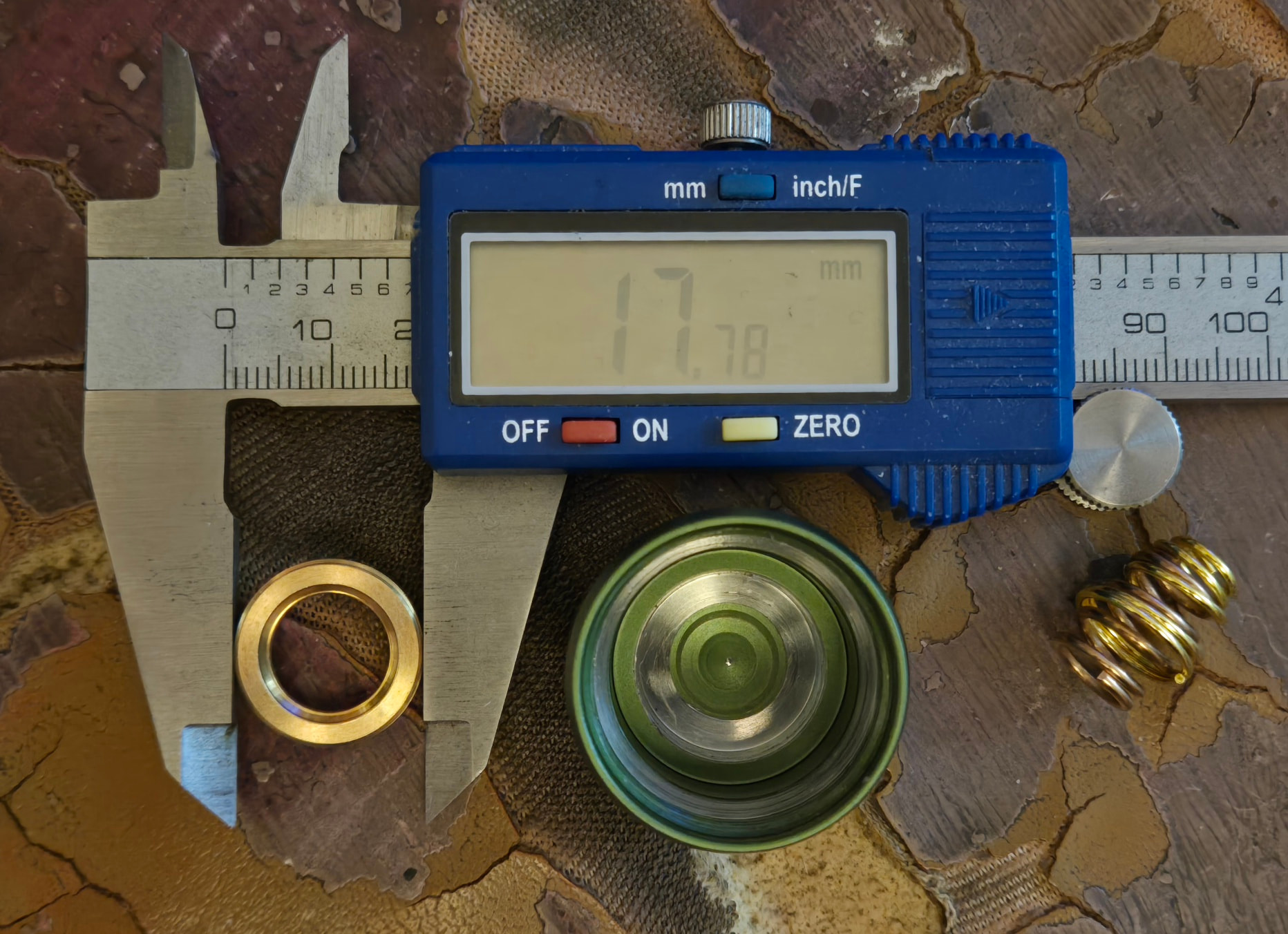

For now I doubled up the spring with a second super chonky spring threaded into the original.
As you can see in the pic, the bottom of the spring simply rests on the non anodized part of the cap and gets sammiched in place with a very hefty retaining ring, which measures 17.78mm.

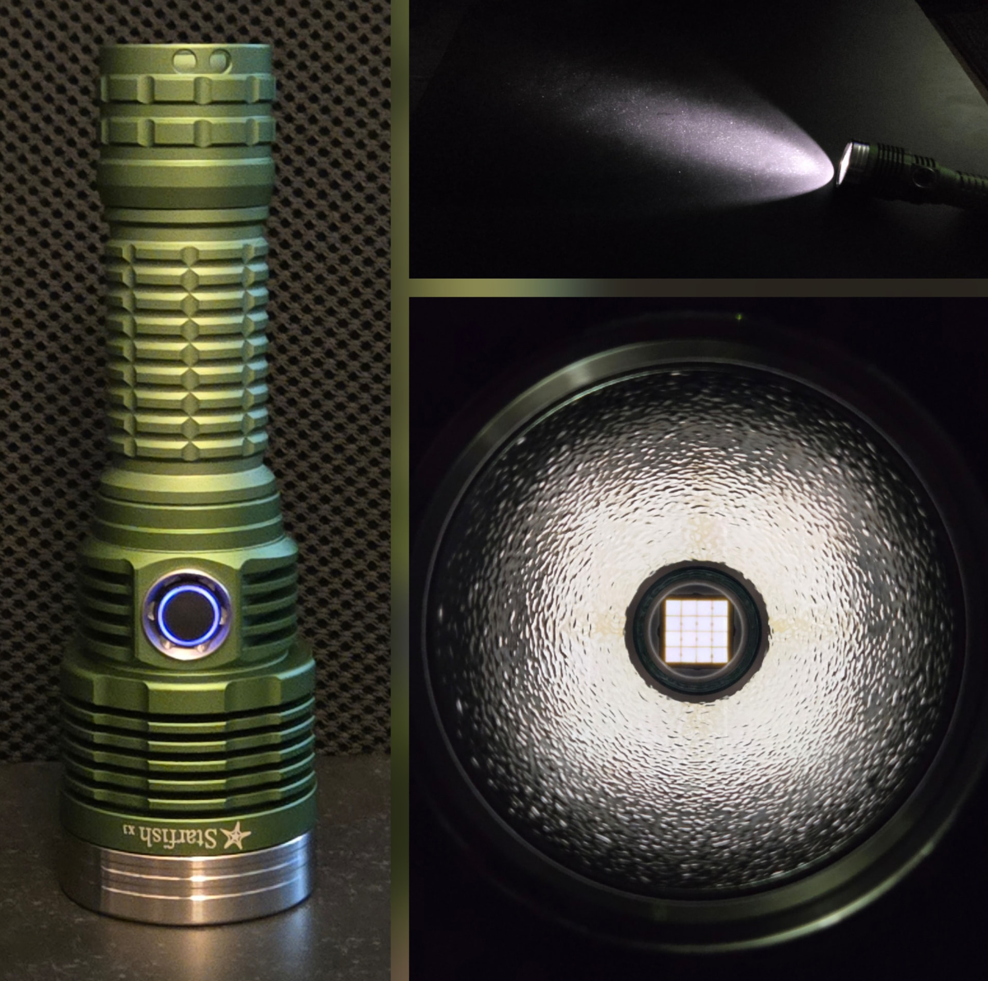

I love the “Glamour Shot” this host looks great!
Me too! Thanks for taking the time to design it!
Thanks! I’ve been using GROK to spruce up the glamour shots. I now have it saved as a preset in my interface. I just tell grok to do the same thing each time. :slight_smile:
