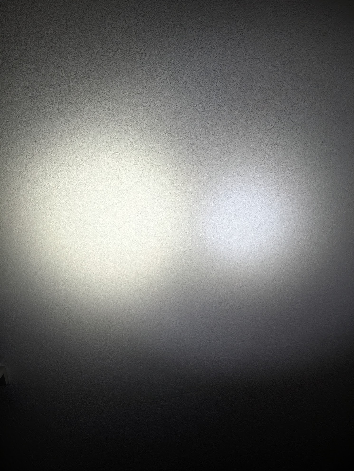

Well, not always. The Quad-Optics from Convoy make the 5700K 519A green/yellow, like, a lot. I have several lights with the 5700K 519A and the reflector ones are all fine, just my modded S21A with Quad 519A is green.
Left: S21A 519A 5700K Quad optics, right T3, 519A 5700K
I don’t have any problems with my reflectorlights and the 5700K 519A.
Oof, this is good to know. Do the more diffuse TIRs, like the 60deg beaded, fare better tint-wise? The T3 reflector has a pretty high depth/diameter ratio, which helps it mix tint much better than the S2+ reflector.
All of my S2+ 519A’s look like crap with the stock reflector; every single TIR I’ve ever tried makes it much better. Perhaps there is something uniquely at fault with the shallow quad TIRs.
In any case, the B35AM has almost no angular tint shift regardless of secondary optic type–there is little reason to get the 519A 5700K in its place.
