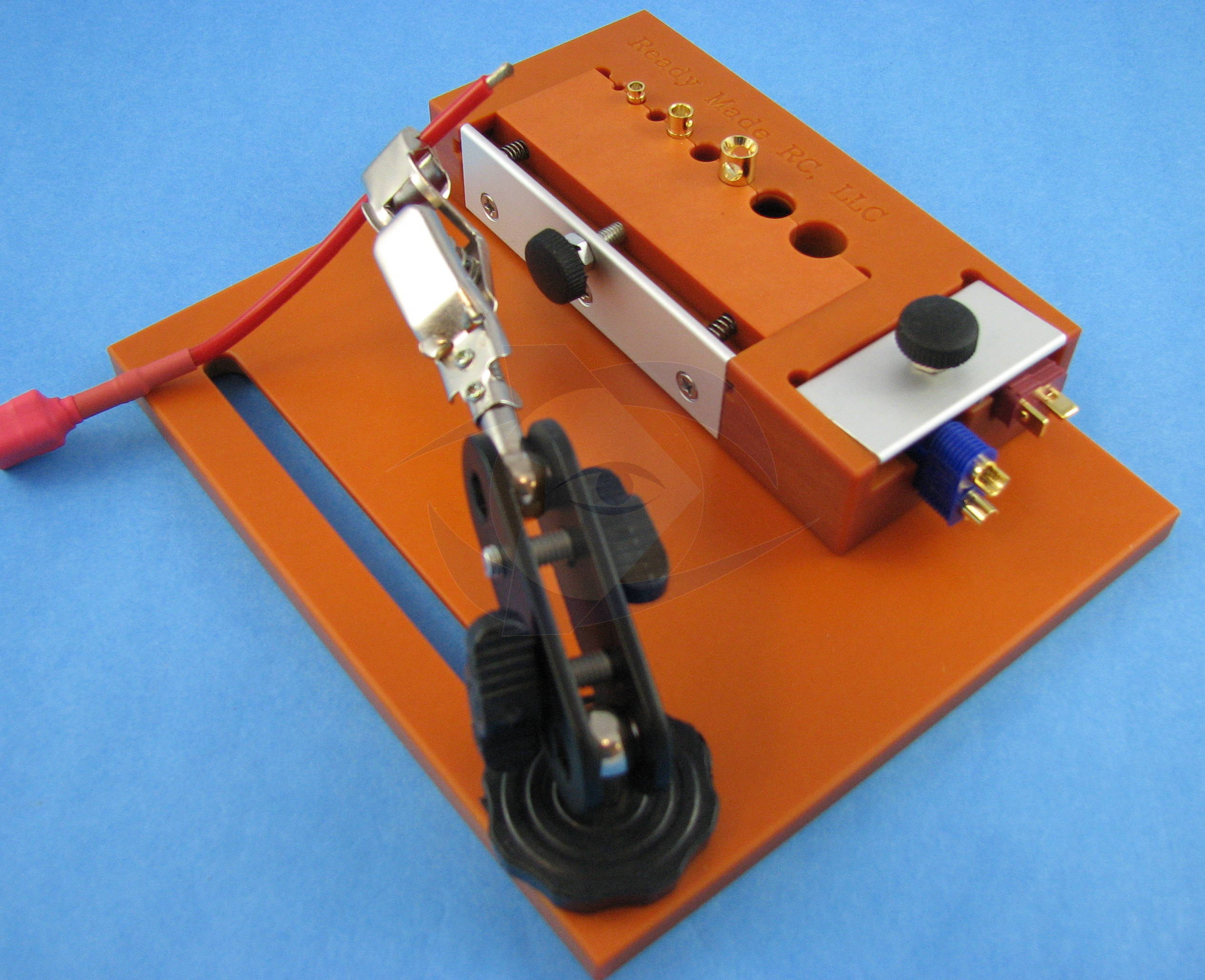

I still haven’t made a move on the helping hands. Here’s another style I ran across. This one is probably not so ideal for the flashlight hobby, but for the RC hobby it looks great. I’m really tempted, although I’d still need to have a regular set of helping hands, so this would cost me even more space!
Ultimate RMRC Soldering Jig
