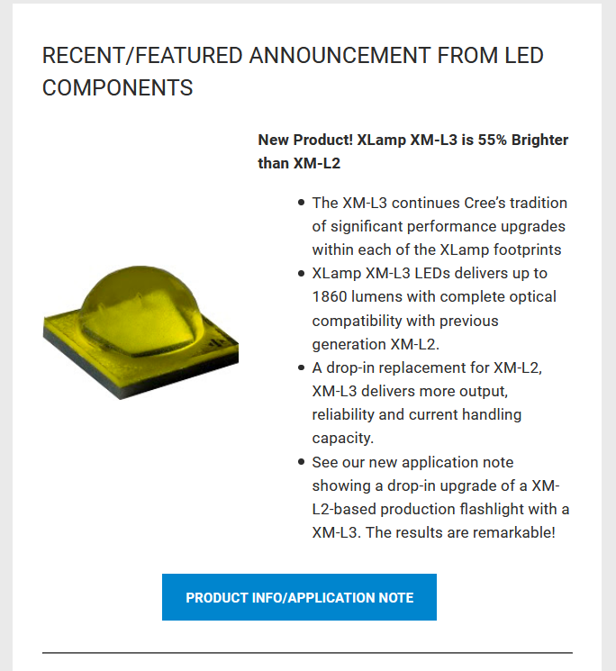

Just got this email from Cree saying “News this month”

Hopefully it’s not a disappointment. What is the actual difference between XML and XPL. Is it just the footprint? or the vf aswell.

XM-L is 5050 footprint and xp-l is 3535. Die sizes are the same I believe. Not sure on vf. This one looks like the xp-l2, but isn’t flipchip since you can see the bond wires. Beam probably won’t be as nice as sst40 or aforementioned Luxeon V. Plus phosphor on the die too.
If I had to wager a guess I would say that because of the XML foot print this emitter will continue to show an increase in output at higher drive currents than the XPL. That yellow dome does make me a bit apprehensive about how the color quality will be. So far all of the yellow dome versions of crees LEDs have been a down grade in color blending IMO. Getting the super low VF like in XHP50.2, and XHP70.2 has sure been nice though.
To be honest I am surprised they made this at all. I was assuming XHP50.2 was their answer to 3V XML footprint. I will be trying some of these bad boys for sure
