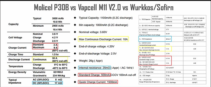

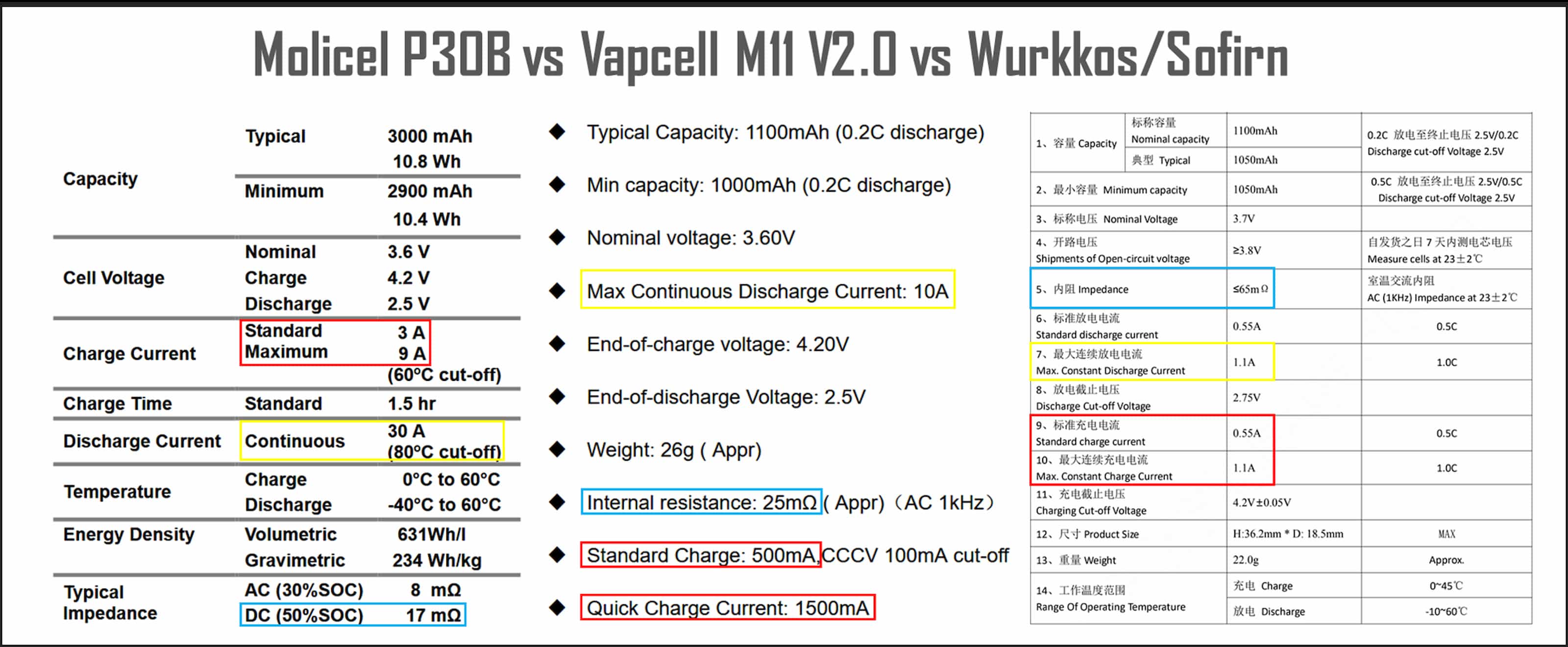

The stock 18350 (1100mAh) is rated for a 1.1A max discharge (according to the datasheet), while the TD07 pulls 4.5A~6A on Turbo. Furthermore, the 2A internal charging is way too fast for this small cell.
  • The Solution: I sourced Molicel P30B cells (safe up to 3A charging and 30A discharge) and extension tubes.
ā€œData-Driven Safety Comparison:ā€ I have attached the official Molicel P30B Datasheet highlights below. Comparing these specs to the TD07’s draw confirms why this setup is technically superior for long-term safety and performance. The stock cell is pushed to its absolute limits, while the P30B operates well within its safety margins.

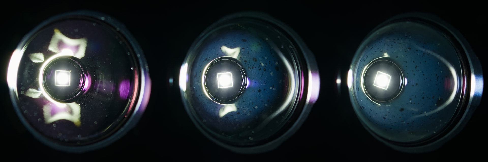

4. The ā€œDealbreakerā€: Manufacturing Defects

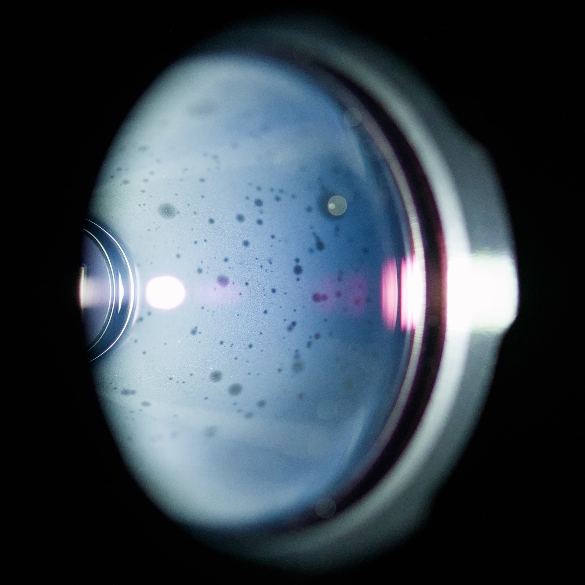

I bought 3 units. When I unboxed the factory-sealed backup (to test it as a reference for the 18350 battery), I finally noticed the foggy reflector and was shocked:
  • Reflector Outgassing: 2 out of 3 units have foggy/cloudy residues. My 4-year-old Convoys are still crystal clear.
  • Structural Defect: One unit has a physical ā€œbumpā€ on the reflector edge.

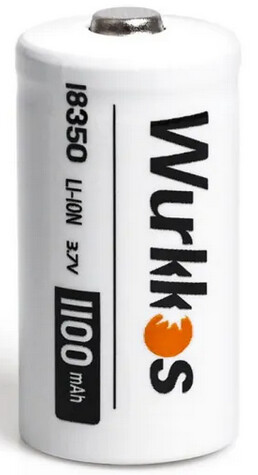

By the way: what style of wrapper/sleeve does your Wurkkos 18350 have? I also bought a TD07 last year and the 18350 that came with it, was in the full traditional ā€˜Wurkkos style’ like the rest of their batteries. But when I look at their own website right now, the photo’s of the separate 18350’s they sell now show ā€œgeneric lookingā€ 18350’s with only a little bit printed on them. No clue if this might be a really old photo or that they switched cells?!?

Hi, I found the datasheet right here on BLF: Sofirn/Wurkkos 18350 1100mAh Datasheet. I didn’t remove the wrapper; my units are the standard orange Wurkkos branded ones. While I can’t be 100% sure of the exact OEM source, this datasheet seems to be the community consensus for this cell.

Several community reviews (like ZeroAir) mention a ~2A internal charge rate. The M11 is rated for 1.5A ā€œQuick Chargeā€, whereas the P30B handles 3A ā€œStandard Chargeā€ (up to 9A). Since this light is for my girlfriend who only uses internal charging, the P30B offers a much safer overhead.
Performance & Ergonomics

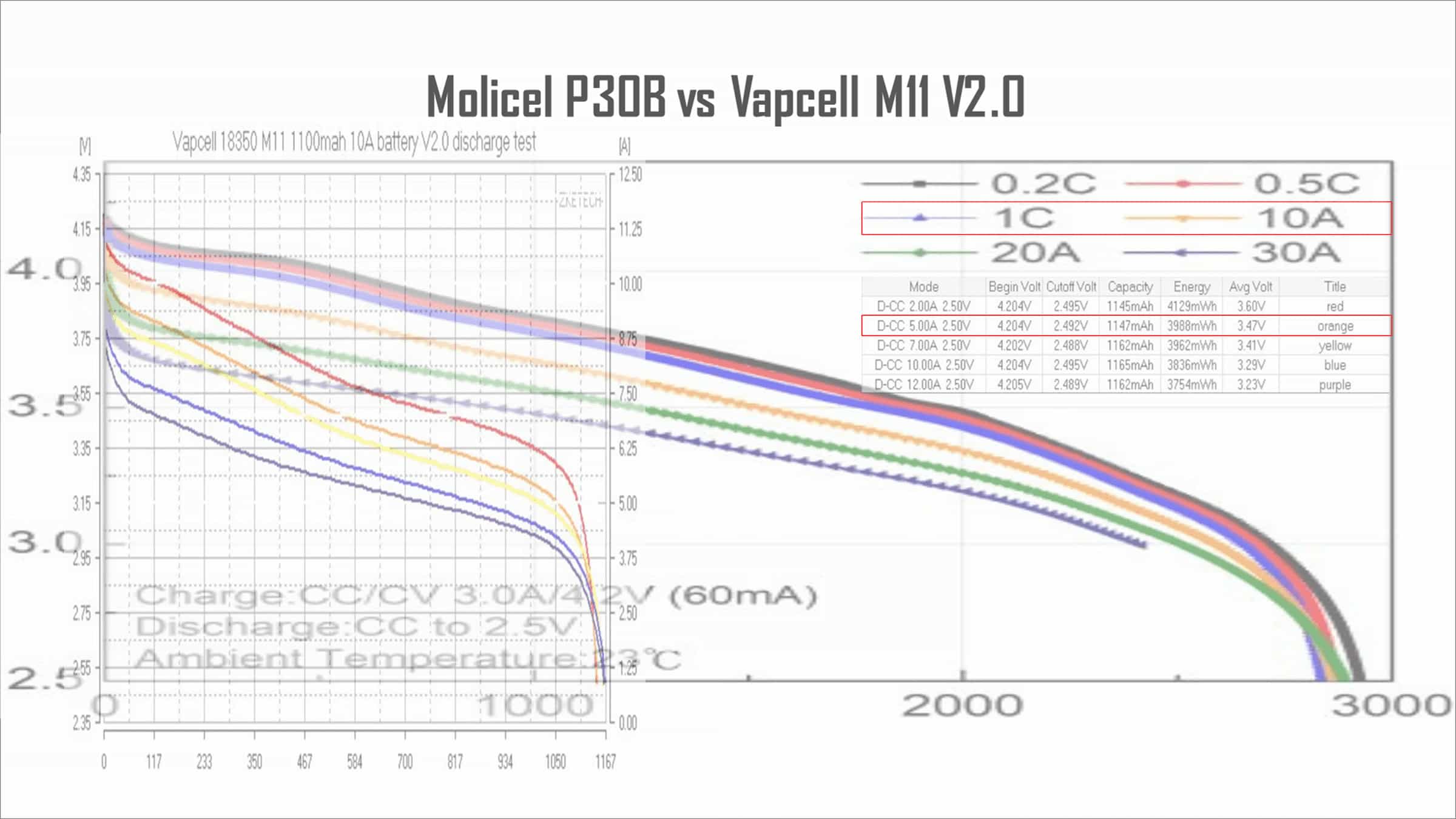

• Internal resistance: The stock cell’s resistance is roughly 3.8x that of the P30B and 2.6x the one of the M11 V2.0. This explains why the Molicel stays ā€œpunchyā€ even at lower state of charge. For comparison, Flashaholic also measured a 22% boost in High mode and a 15% boost in Turbo using an M11, which perfectly aligns with the performance gains I observed.
• Thermal & Grip: The extension tube gives more surface to cool and arguably better handling in a high-stress ā€œsnatch theftā€ scenario.
• Discharge curves: I made a quick overlay (50% transparency) to visualize the difference. Even ignoring the capacity gap, the voltage stability of the P30B is on another level. It ensures she has maximum ā€œdazzling powerā€ available even if she forgets to top up the battery frequently.

While the shared mod confirms the head is accessible, I have decided not to open or touch it for now. As you can see on the photography I uploaded on Imgur (https://imgur.com/a/6lcThFf), the reflectors arrived in a deplorable state.
Between the heavy ā€œoutgassingā€ haze and the physical pitting on the edges, the optical path is already compromised. Attempting to clean such a delicate surface would likely add micro-scratches, making a bad situation even worse.
I don’t want to provide Wurkkos any excuse to void my warranty by claiming I damaged them myself. Since 2 out of 3 units are defective, I am expecting a professional resolution—ideally replacement heads that actually passed Quality Control.
That haze is actually on quite a few, also on many Convoy models, it has little to no visual range impact, I’ve measured and it was next to no difference. The pitting however, could be something if it bothers you, but only if you can visually see it in the beam, otherwise they won’t replace it. When buying from these cheaper brands you need to be prepared to accept small imperfections. Take it from me who sells Convoy, Sofirn, and Wurkkos, I QC check thousands of units. I’ve personally never claimed warranty for this type of thing, but that’s me.

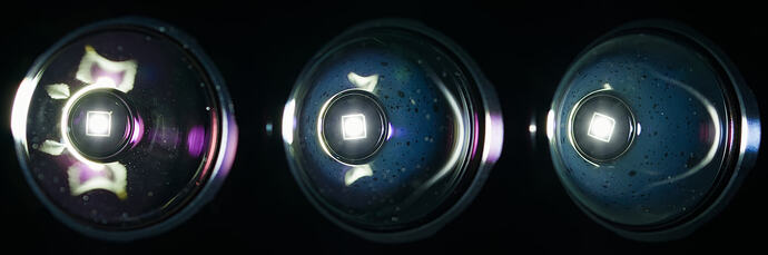

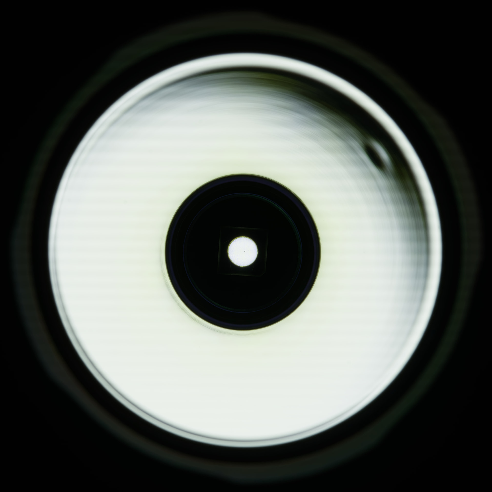

Actually, following your suggestion to look closer at the beam, I noticed that the ā€œlotteryā€ goes even deeper than just the reflectors. Looking at them side-by-side reveals a total lack of consistency in assembly:
  • Unit 1: Has the haze and a greenish, irregular beam. (I wonder if the tint shifted after a few heat cycles, as the only ā€˜white’ one I have is the one I barely used yet).
  • Unit 2: Has the haze/pitting, but the beam is perfectly circular, white, and centered.
  • Unit 3: Has a clean reflector, but still has a greenish, ovoid/irregular beam.
Even the extension tubes have machining variances (one has an off-center inner bore). It seems every unit has its own unique ā€˜personality’ from the assembly line.

Damn, those are some really weird/unusual specs in the datasheet of that battery! It’s already ā€˜pretty rare’ of a cell having only a max discharge current of 1C, but it’s even more unusual that the standard and max charge current are identical to the discharge currents. Certainly when you have a (really) low drain cell, the charging current is (in comparison) equally low(er).
If it’s flux residue, it’s not just an aesthetic ā€˜haze’. These fumes are often acidic or contain halides that corrode the vacuum-deposited aluminum over time. My concern is: will these reflectors be unusable in 2 years?

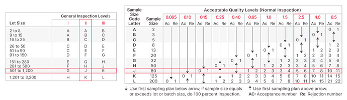

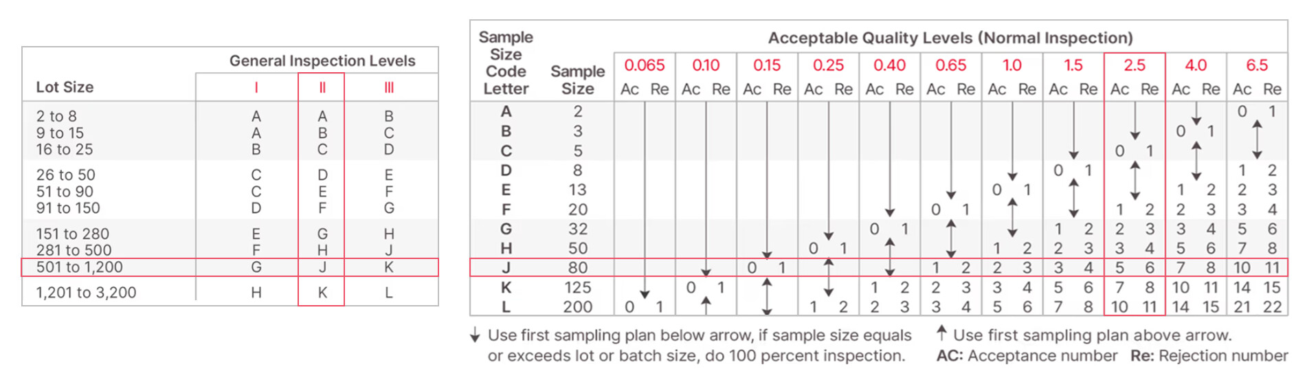

Since you QC thousands of units, are you following a specific AQL (Acceptable Quality Level) standard like ISO 2859-1 or MIL-STD-105E? For a batch of 1000 units (Level II, AQL 2.5), the standard procedure is to check 80 units (n=80). If more than 5 units show this haze or pitting, a professional QC would typically reject the entire batch (Ac=5,Re=6). Finding 2 defects in my personal sample of 3 suggests a failure rate far beyond any industry standard. It would be very interesting to see a real statistical audit on a recent batch.
True, but won’t 5A at above 4V (for 100mAh) get even better results than 5A dropping fast (after 50mAh) under 3.75V? Even with a good cell like the Keeppower 10A, the voltage drops much faster than an 18650.

Nope, I just do my own thing, it’s the most thorough check you’ll get though, but I’m not comparing the beam of each, I just measure range and lumens, if it meets specs or matches older stock within X percentage, there’s nothing to complain about. If there’s something really off, like a bad hotspot pattern or general beam, then I’d complain and request a replacement, I’ve only faced beam issues with Convoy though, to the point of it being a problem.
I just price things down or sell at cost if there’s any issue. Would I decrease the price for haze? No, I wouldn’t, not with my measurements and the price of these brands. If a customer complained, then I’d offer a discount or offer a replacement. I’ve never had a customer complain though.
