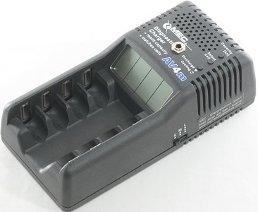

Charger AV4m+

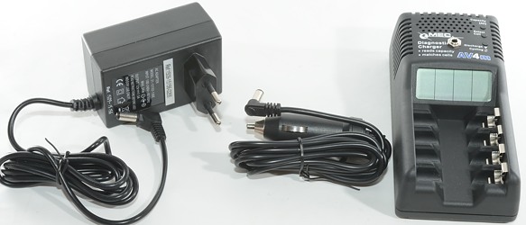

This charger is a bit special, orginally it is from a brand called MEC, but the German company accu-select modifies it significantly and then add a + to its name (or a s for the model with serial data output). The modified model name is not printed on the charger, but only visible in the documentation and the listing for the charger. The charger is an analyzing charger.
I got the charger in a white cardboard box with very little text on it.
The box contained the charger, a power supply and a car adapter, manual is downloaded from the internet and is in German.

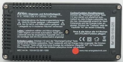

There is some sort of manual on the bottom of the charger, but it is for the orginal charger, not this modified one.
Power input is a 12V barrel connector.

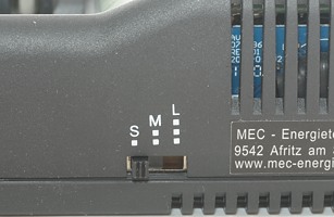

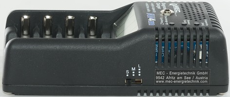

Charge current is select with this switch, actual current will depend on cell size (From manual):
AA: S:540mA, M:800mA, L:1030mA
AAA: S:210mA, M:310mA, L:400mA
Changing current during charge will trigger a pause on the charger.
The user interface is the display, 3 buttons, the current select slider and a buzzer. The socket on the top is for serial data, on the + model it can be used to update the software in the charger, on the s model it can be connected to a computer for data logging.
Button functions:
CAP: Recall discharge values
DIS >2sec: Start a discharge, charge function.
SEL+DIS >2sec: Start a charge, discharge, charge cycle (CDC).
DIS >4sec: Cycle the batteries until maximum capacity is reached.
CAP+SEL >3sec: Enter setup mode, mostly sound configuration, but it also include voltage calibration.
The buzzer in the charger is used to signal a lot of stuff and has many different sounds patterns

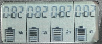

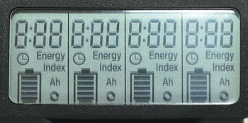

During power on the charger will do the usual display test and then show the software version.
The display will usual change between voltage, time and capacity. To make the sequence easy to read a U is displayed before the voltage, i.e. the sequence contains four steps: U, voltage, time, capacity.
