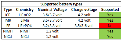

Enova has a long line of chargers with 2, 4 and 8 channels. This review is about the 8 channel charger. The charger can charge both LiIon and NiMH batteries and work as a usb power supply.

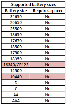

The slots can support many battery sizes, from 32mm long up to 72mm long, but the larger sizes will have a very long charge time.
When putting batteries in, it is necessary to be a bit careful to get connection due to the large diameter of the trays.
The charger can handle 72 mm long batteries including flat top cells. The specifications also list 16340 and 10440 batteries, but the current is too high for these battery sizes.

- Above 2.0 volt charger assumes LiIon battery.
