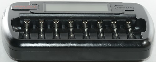

Charger Japcell BC-800S (8xNiMH)
This charger can charge and discharge up to 8 AA/AAA cells with individual charge control for each cell.
The charger comes in a retail box. There is some specification on the box.

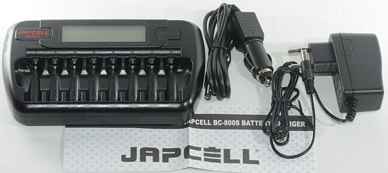

The pack contained the charger, a car adapter, a power supply and a instruction sheet.
The power input is the usual DC adapter.

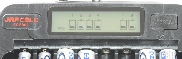

The display has 8 battery symbols with animation showing charge or discharge (It must be the same for all batteries).
The display shows “CHG” or “DISCHG” depending on selected function.
Pressing the button for about 2 seconds will start a discharge (or stop it).

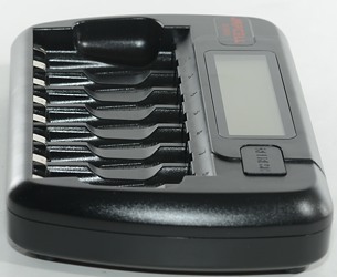

The battery slot are the typical two level construction.

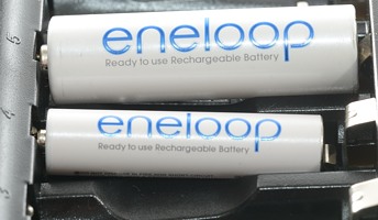

With AAA cells the current is lower, but the termination is again late.
%20%2312.png)
With two cell in the charger I got a acceptable termination (only about 30 minutes late).
