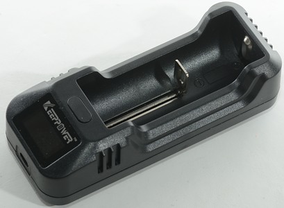

This is the updated version of the L1 charger where Keeppower has reduced the charging voltage to the correct 4.20 volt. It is a single cell charger with two charge currents and can handle sizes up to 26650, the charger is powered from usb. For a review of the initial version of the charger see here: First version.

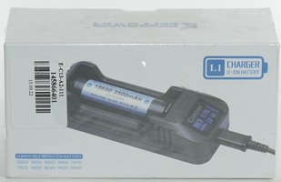

I got the charger in a cardboard retail box with fairly limited printing on.
I unwrapped it before looking careful on the box. The above label was placed on the shrink wrap.

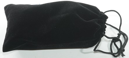

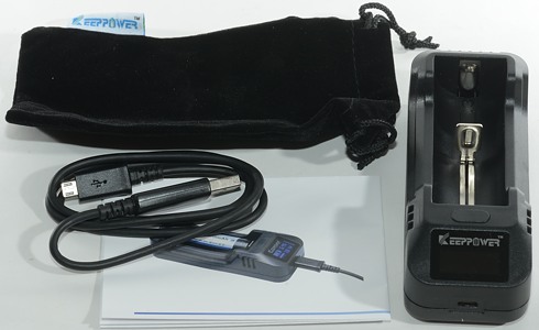

The box contained the charger, a bag and a usb cable and a manual.
The bag is for the charger and the cable.

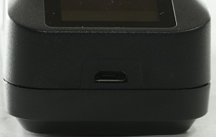

The micro usb connector is placed on the front, just below the display.

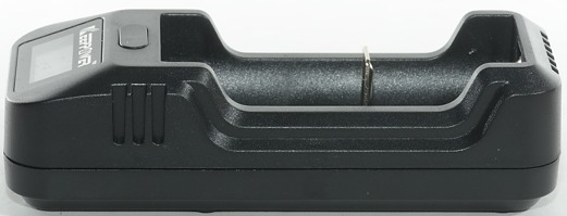

The user interface is a display and a single button.
A press on the button will change between 500mA and 1000mA charge current, but only when there is a battery in the charger.
Holding the button down will turn off the display and disable the current change function, the charger will continue to charge with selected current. To turn display on again the button must be held down again.
The display has an animated battery icon, charge percent, voltage and selected current.

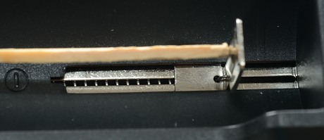

The charge uses the typical slider construction with a metal rail and it works smoothly from about 29.5mm to 71.5mm, i.e. the charger can handle any 18650 and 26650 cells both protected and unprotected.
The charger can easily handle 71 mm long batteries, including flat top cells.

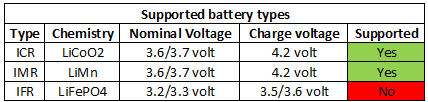

Going by all the specs and observations, this will only charge 3.7v cells, and not NiMH’s, correct?
I’ve been looking towards getting a spare charger in case my MCC-2 bites the dust. Guess this one is not it.
