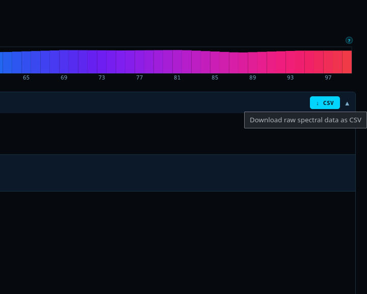

Because even tough i can Download the measurement data from the side it not clear to me how im allowed to uses it.
The api details are in your profile where you create a token. As for usage, that’s all in the website terms and conditions. Basically the data is owned by the users who are free to delete or make it private.
There also isn’t a way to download data from the site. That’s intentional.

You can download individual data sets but not all of them via an api. And all they are is wavelength data sets.
